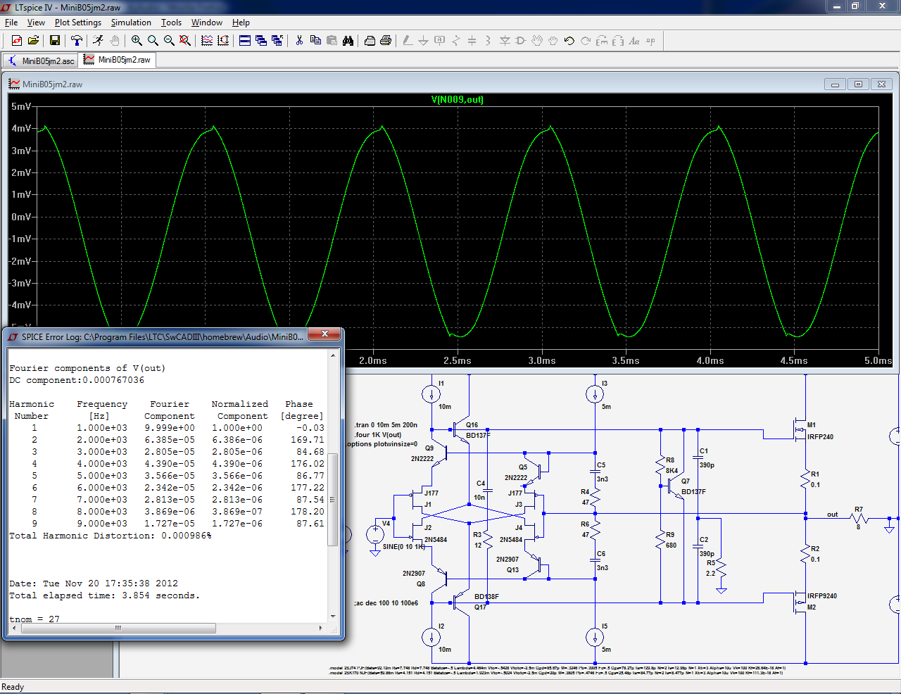

And finally, a jFET input MOS output version.
Not very good, predictably, but here the FETs used are not true complements, they are rather approximate.
In a conventional topology, this would have a catastrophic impact on the DC offset and the even order harmonics, but here the effect is minimal, showing the superiority of this scheme.

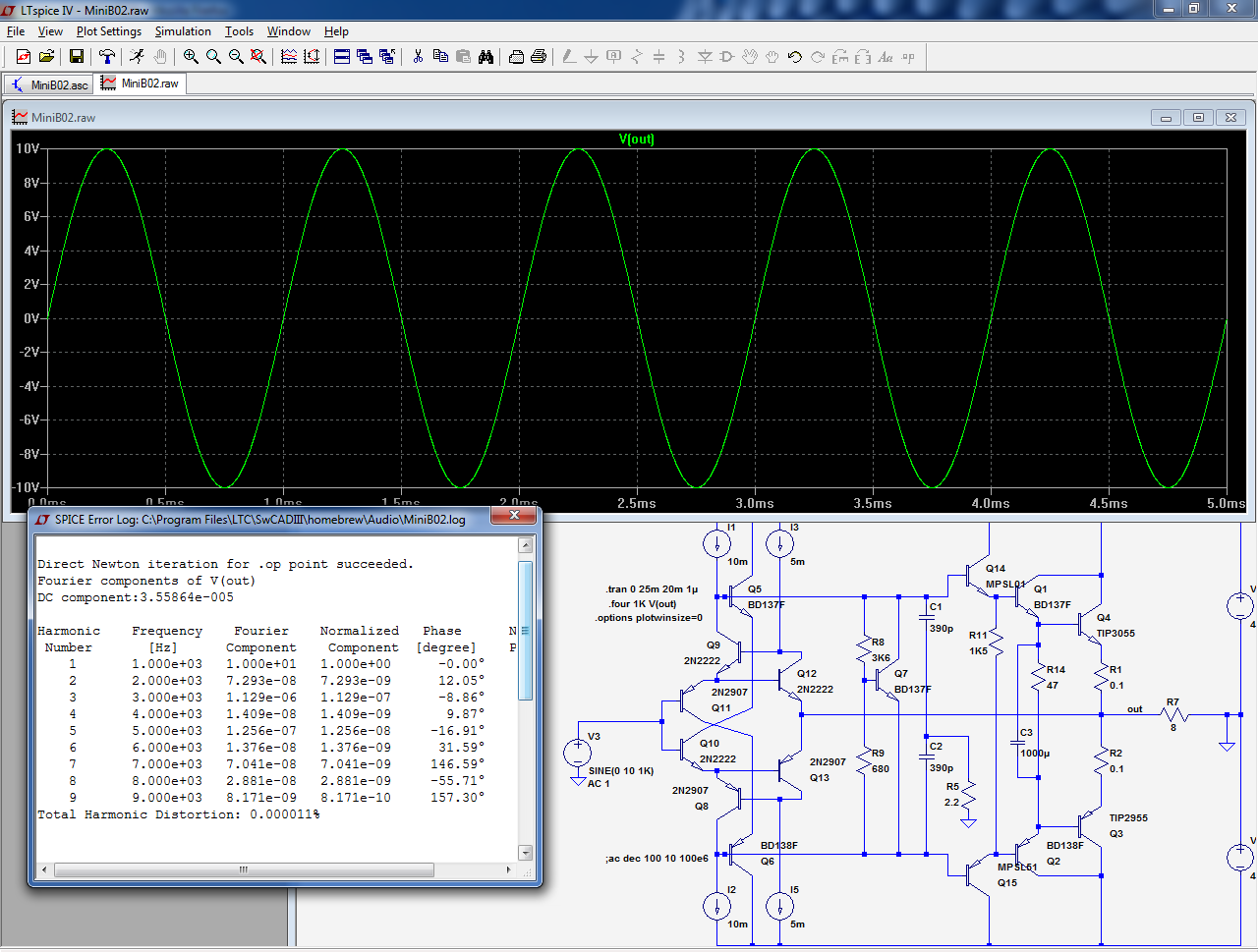

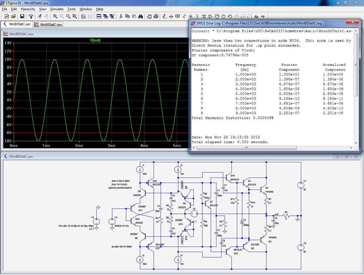

Here is the "double-barreled" version of the buffer.
Surprisingly (and disappointingly), it does not result in better performances, the opposite in fact.
In addition, it also requires intersex matching and thus seems (for the moment) to offer no advantage, except a very marginally reduced BOM

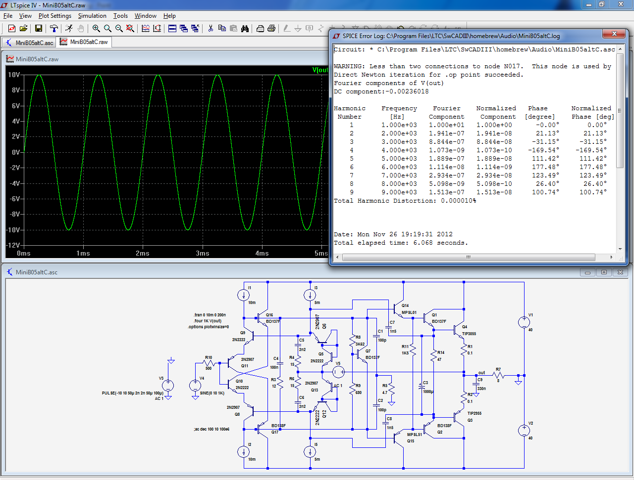

Here is an alternative compensation scheme, adding some feedforward components to the mix.
The buffer now tolerates in excess of 330nF direct output capacitance.
The cost is a somewhat increased THD level, from 40ppb to 90ppb, but it is still tolerable.
Also shown is the effect of a realistic source impedance (500 ohm) on the performance.

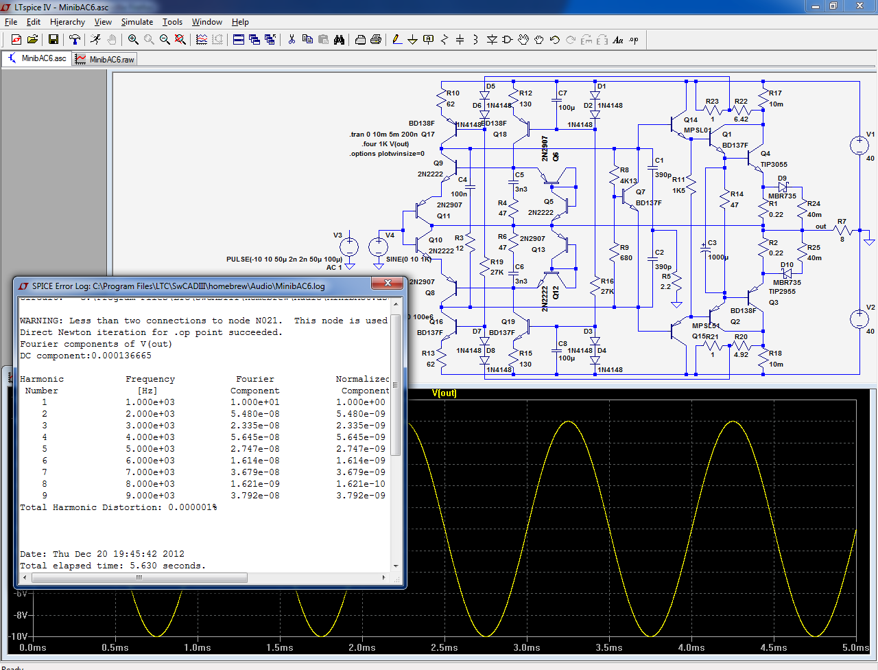

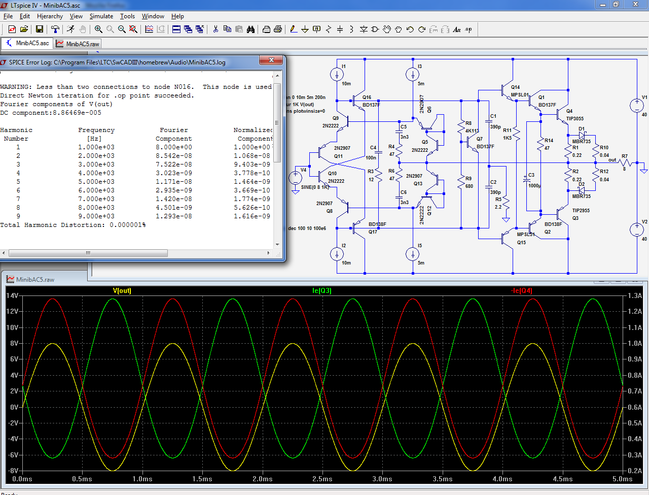

It is possible to combine this buffer with class AC.
This allows pure class A operation up to 4~5W, and a seamless and distortionless transition towards higher levels, contrary to class AB where the increased width of class A operation costs a higher distortion in the transition zone (compared to optimally biased class AB).
The end result is an even better linearity, in the 10ppb range.
This is for the output stage alone. If it is included in GNFB loop (which is perfectly possible thanks to the low phase shift and wide bandwidth) with a matching VAS, a further 20 to 40dB is achievable, bringing the overall THD to vanishingly low levels.

.... pure class A operation up to 4~5W, and a seamless and distortionless transition towards higher levels, contrary to class AB where the increased width of class A operation costs a higher distortion in the transition zone (compared to optimally biased class AB).....
I don't agree, at least not 100%. Consider multiple parallel pairs of complementary output devices where each pair is optimally biassed Class AB (or B as some like to say). You can design this so that the sum of idle current through all the pairs is as high as you need to allow operation in Class A to whatever power level you want, limited only by cost and practical considerations. The transition to Class B will still be optimal, limited only by device matching.
On a practical level I very much like this approach as I believe reasonable device matching is possible for reasonable cost. It allows the heat to be dissipated by more devices, spread over a larger area of heatsink. It reduces the variation in current through each output device for the same power and load impedance compared with a single output pair. This reduces the distortion.
A downside is increased drive requirements. Roender used a CFP driver in his implementation of this approach (IIRC he had about 2W in Class A before transition to Class B).
Brute force is always an option, but class AC has more subtle advantages: the bias voltage is an order of magnitude larger, the emitter resistors are also larger and this means the sensitivity to initial inaccuracies or thermal tracking problems is correspondingly smaller: with class AC, you are sure to get your performances without having to parallel too many components and without finicky thermal adjustment and compensation issues.
I agree that a fully automatic bias really is the way to go, but short of that, class AC is already a step in the right direction.

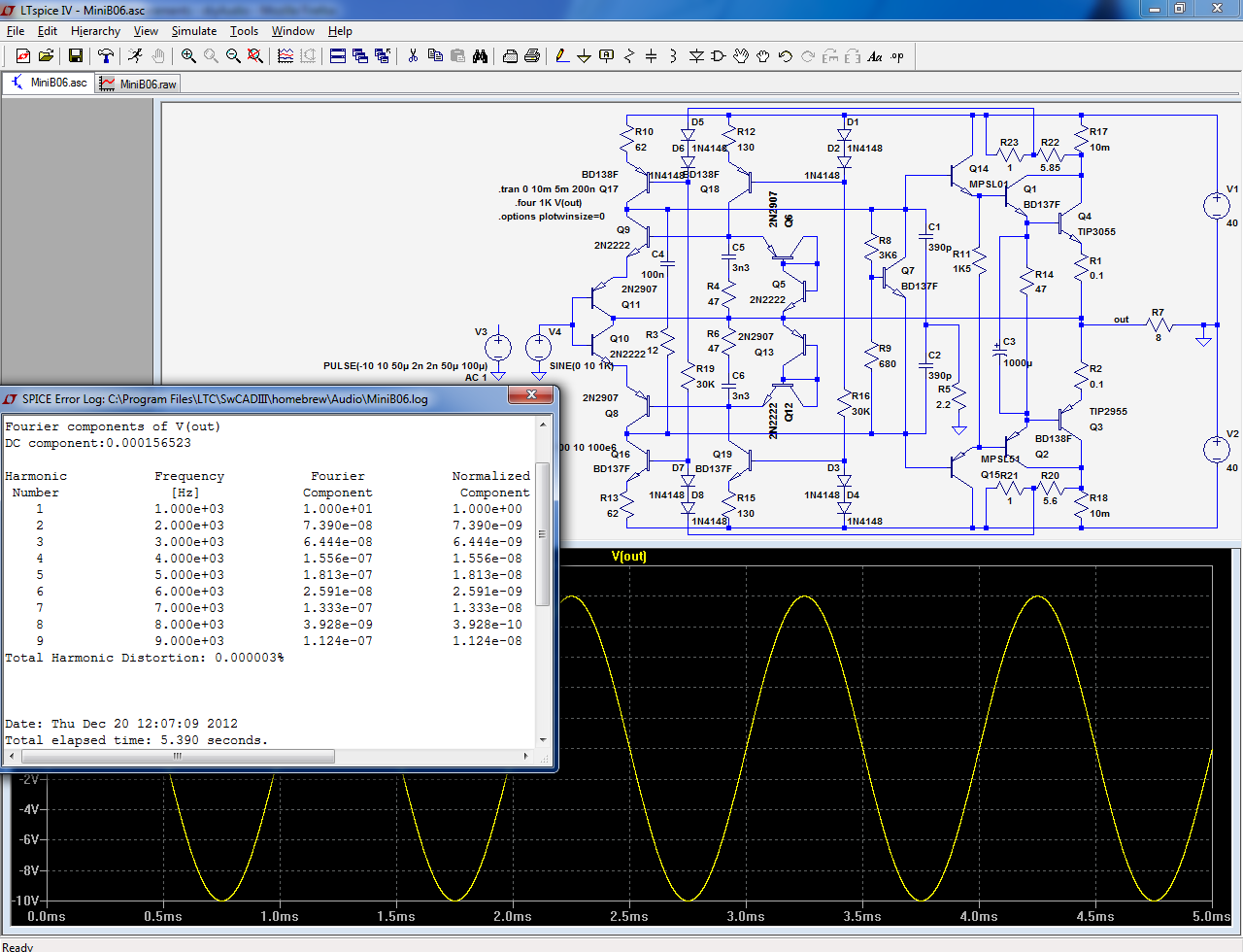

What is the difference if real current sources are used.?..
Here it is, somewhat rationalized, and with real current sources.
The sources are crude and minimalist, but active.
This allows a further improvement in linearity, and also gives an opportunity to compensate for the poor complementary of the output pairs.
The class AC version could also benefit from such an improvement.
