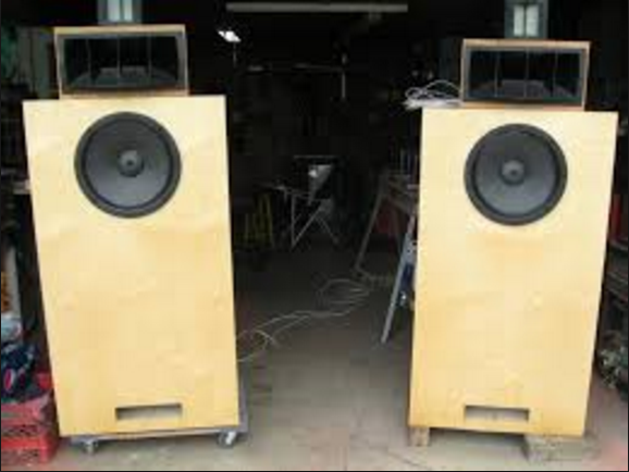

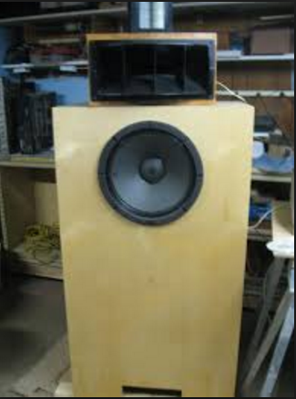

Here's one build: Altec 416b MLTL, design by GM
PB is holding the pics hostage, but did manage to copy these two [attached] low res pics off a Google image search, though not sure if he ever added the full width horn baffles with the foams kits I recommended to mimic the M19's.

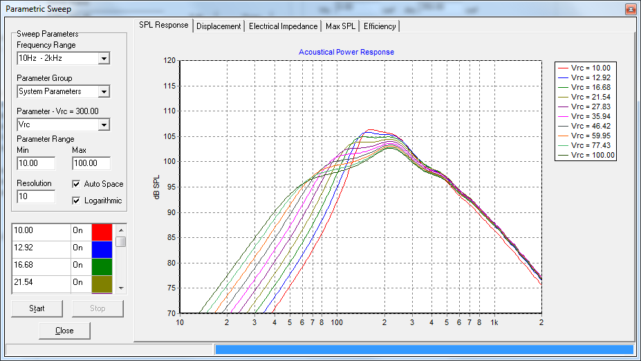

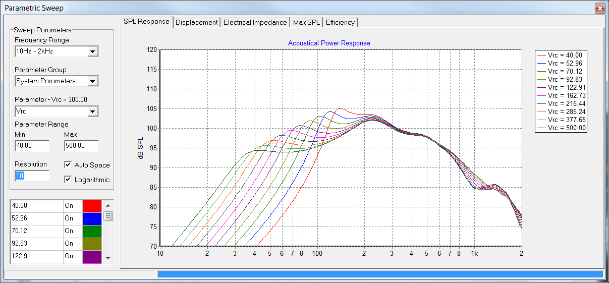

One possibility I'm exploring is an A7-type horn with a very small closed rear chamber for the 515 ... in the range of 1 cubic foot (or less). Simulations indicate this will extend the response beyond the 220 Hz peaked cutoff of the bass horn, and cover about an octave below cutoff, so the response of the complete system (515 + 1 cu. ft. closed rear chamber + A7 horn) covers 100 Hz to 800 Hz, and is also reasonably flat.
If the horn were removed, the simple direct-radiator+box would have a peak of several dB around 100~120 Hz, but the combination of the horn and the peaked direct-radiator combines to give a reasonably smooth response over the passband. In effect, it's a hybrid ... a direct radiator from 100 Hz to 220 Hz, and a horn from 220 Hz to 800 Hz.
The real A7 does the same thing in principle, but is grossly mistuned, with a 60 Hz peak that is 10~12 dB below the main 220 Hz peak, and response that drops like a stone below the 220 Hz peak.
The catch with a A7+small closed rear chamber is the response only covers 100 to 800 Hz, and drops off very sharply below 100 Hz. So another woofer is needed to cover 30~100 Hz, which doesn't really save any drivers (or space) compared to the dual-416 approach, and a 100 Hz crossover is probably necessary. The main difference in functional terms is probably directivity, with the A7 maintaining some degree of pattern control down to 300 Hz or so, which isn't really true for the dual-woofer approach.

Back when I was working with Bjorn Kolbrek on the AH425, I mentioned an alternative version of the A7 - a much smaller closed-box version using modern optimization techniques. Bjorn, to my surprise, actually owned a pair of A7's at one time, and not only that, measured them in the anechoic chamber of a local University. More recently, he's shown me simulations of the A7 horn combined with different volume rear chambers in both vented and closed alignments. The simulation is surprisingly close to the actual real-world measurement of the A7, so I trust them for the closed-box variant. (Bjorn's data is shown below in Figures 1, 2, and 3.)
My original idea was using the 515 (or 416) without the annoying requirement for an electronic or digital highpass filter. I know that below cutoff, horn-loading acoustically disappears, and the driver acts much as it would without a horn at all. Also, when a vented box is working below the box frequency (Fs), the box provides no acoustic loading ... the driver is effectively in free air, like a dipole.
This is a roundabout way of saying that an A7-style vented rear chamber provides no loading at all below Fs, which is around 60 Hz for the A7. The woofer is free to move, which isn't a good thing with either a 416 or 515, which have short underhung voice-coils and have very limited linear excursion (a few mm at most). In the standard Altec A7 (a rear-vented short horn) or Model 19 (a standard T/S alignment vented system), an active highpass filter is a very good idea, since both are unloaded below the Fs frequency, and this does no favors for the 416 or 515 drivers.
My thought was to use a very small closed rear chamber for the 515, which substantially decreases compliance and thus limits VLF excursion. The trick is selecting the correct rear volume, tuning it to the cutoff of the short bass horn, and taking over below the bass horn cutoff ... dual-mode operation, as it were, and using modern simulation techniques, which weren't available to Altec when the A7 was designed in the mid-Forties.

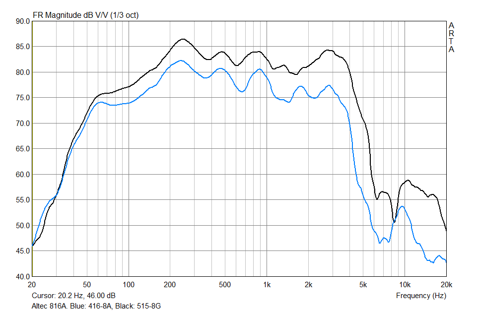

Figure 1 is Bjorn Kolbrek's anechoic measurement of his A7 with 515 and 416 drivers (416, as expected, is the lower, less efficient curve). Figure 2 is Bjorn's vented simulation of the A7 with different rear-chamber volumes (in liters). Figure 3 is Bjorn's closed-box simulation with different rear-chamber volumes. Note the discrepancy between the measured response and the simulations above 300 Hz; this is due to the increased directivity of the A7 horn, which is not reflected in the simulations, which are total power into the room simulations, and do not take directivity-gain into account.

Yeah, with a 515-8G, HR says the magic number is right at 10 L.
