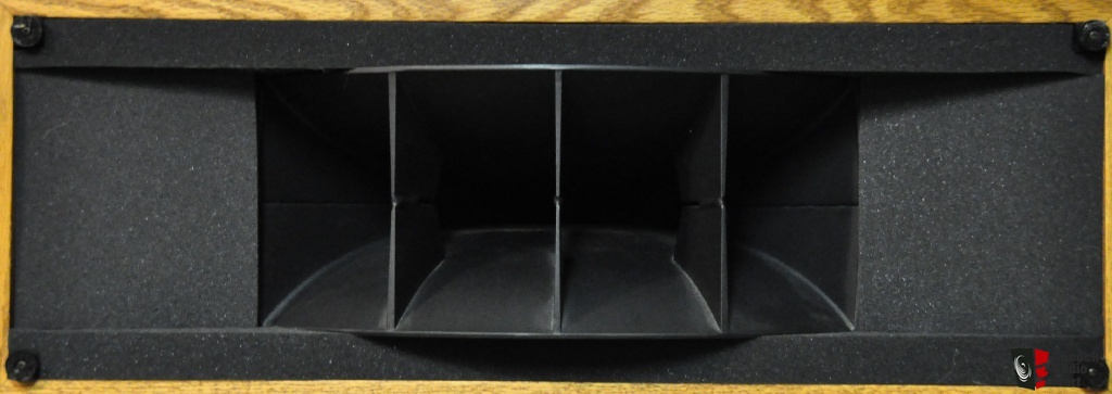

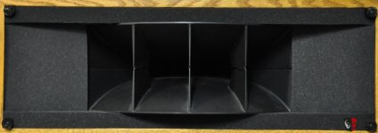

Foam around the horn? Explain please. I have M19s but they never had foam around the horn.foam around the horn is gone

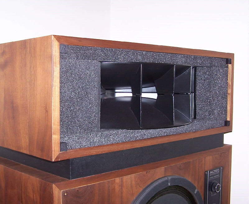

Yes the M19 had foam around the 811 horn. Most foams have rotted away so most M19 pics you see have no foam around the horn nowadays. It was part of the design to dampen reflections and ringing.

Aaah! That's the reason why mine had that harsh and bell sound 🙂 They were missing of the foams 🙂Yes the M19 had foam around the 811 horn. Most foams have rotted away so most M19 pics you see have no foam around the horn nowadays. It was part of the design to dampen reflections and ringing.

FWIW, the earliest ones just had raw fiberglass insulation packed around the horn like the Valencia, Santiago, but dealers wanted to display them without grills so they all got the cool foam upgrade.
They don't reduce the horn bell's 'ringing' enough for some folks, so recommend adding duct seal, mortite or similar to at least the top bell.

Here's a brochure link where if you click on the pic it will enlarge it and show the foam around the horn. And for sure definitely do what GM and Cal mentioned to dampen the horn etc.

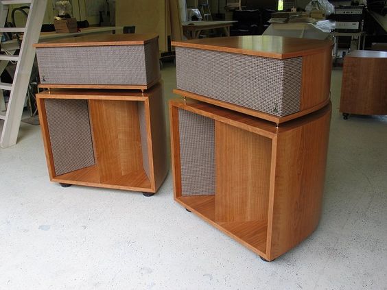

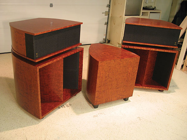

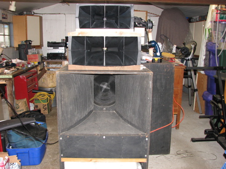

That would be awesome to build a M19 like that and MLTL loaded!. Here's a few pics of the Volti cab. I'd do it like this in concept where the horn is in it's own sand or lead filled box sitting on top, and then the cab underneath could be whatever size works for sitted ear height and MLTL loaded with either a single 416 or side by side twin 416's. That would be some great efficiency if the twin 416's could work, or if not a single would still be killer!
Nice idea, indeed.That would be awesome to build a M19 like that and MLTL loaded!.

I posted the pics of the Volti cabs only to show how one could do the horn separate in it's own box like they do, then build the 416 cab underneath as a MLTL, not loaded like in the pic of the Volti or as a Klipsch etc. Anyhow that's sort of like how I'd do a custom M19, with help though of course. Then if staying with the 811 horn it could be set in the box and you could pour lead shot all around it or sand etc. Then layer some foam all around the horn on the front baffle alike to how Altec did it, or perhaps a bit more thicker foam would be helpful around the 811.
