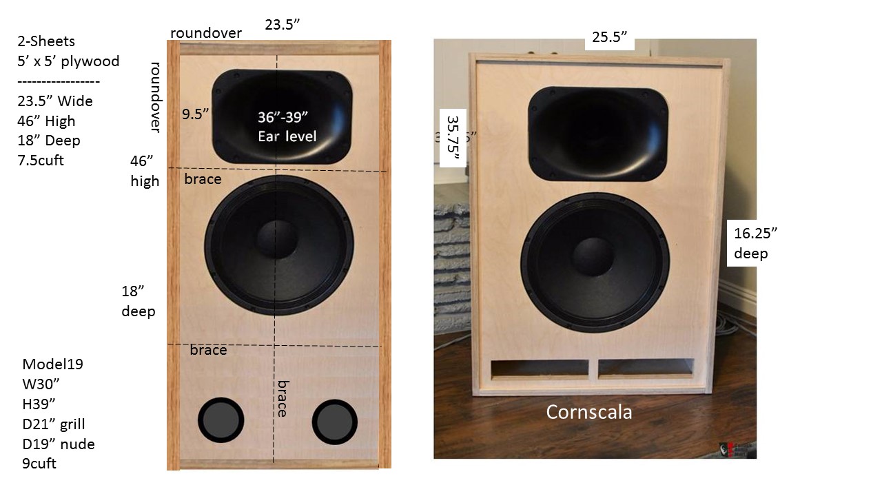

It is a clone of a 18Sound' kit.
No, looks loke a Crites kit
Thanks for the info. Do you know what ports are used in the first design? Size, length, whom purchased from? Is this a 12" or 15" woofer? Maybe a link to what ever article these came from?
Google "crites speakers"
Yep, did that when djk said Crites kit. I was looking for ported slim/tall cabinet for 15", since the Altec Model 19 was 15".

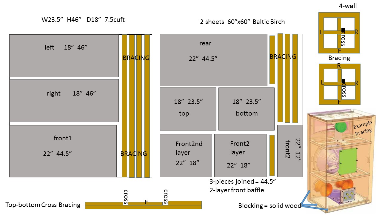

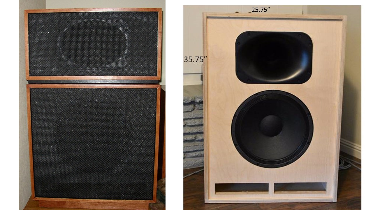

Anyone built this?
Can anyone provide any other details on the design (cabinet volume and tuning, measurements, who designed this, etc.) or point me where to find them? Thanks

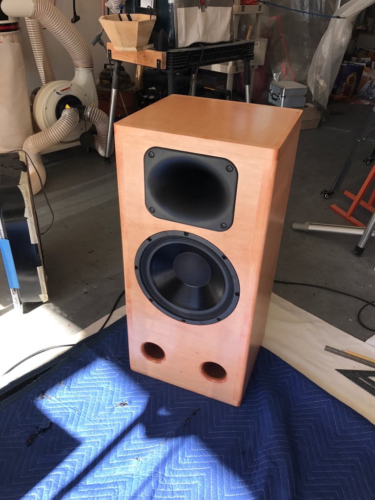

I've seen a few people mention Wayne Parham's Pi speakers, but no one has followed up with their thoughts. Wouldn't they be a valid alternative, or are they too bass shy?
For a 15" driver, the 4 Pi is fairly thin at 18".
Anyone built this?
Not with these drivers, but numerous folks have built M19 replicas with Altec and/or GPA components: MODEL 19
Official Altec cab plans, tuning is around 35 Hz IIRC:
Vintage Altec Lansing Model 19 Cabinet Plans
Model 19 Shop Working Prints

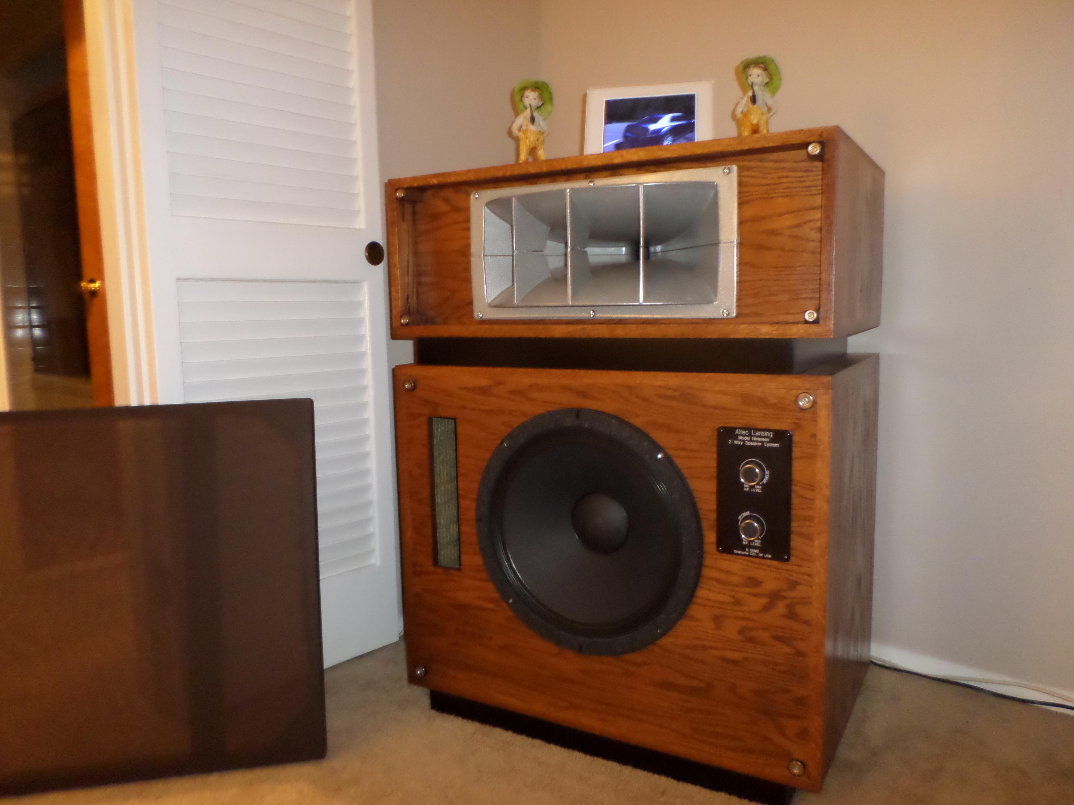

I built a 100% copy of the Altec Model 19 speakers with 3/4 inch solid oak..
and they sound GREAT !! here is a picture without the grill....
I made grills also... the grills are held on with 3/4 for the top and 1 inch cup magnets for the bottom that
work perfect !

I USED ALL GREAT PLAINS DRIVERS AND CROSSOVERS...
416-8C MID WOOFER AND 902-8A HORN DRIVER...
the sound of the Altec Model 19 is hard to beat..
I think if I remember right.. with shipping the cost was somewhere
around 1300.00 dollars with shipping... but its all new stuff !..
