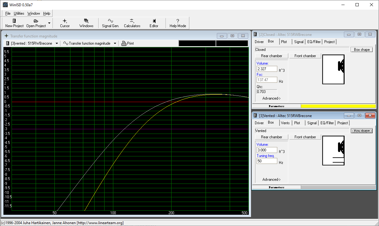

Don't see why it should be much, if any, real difference than 515B/later 288 drivers, so very benign IME.How’s the impedance curve on the 515RWB and the 288 Hollywood in general?—is it like a jigsaw? ( one of the most notorious, the Quad ESL57 )
Qts is .38 so relatively decent magnet strength overall.
Fs seems high around 72 Hz
For ported/reflex usually tuning is slightly above or below Fs
I wouldn't want such a high tuned port.
68 to
With conventional " Alignments " the data doesn't translate to well.
I dont like " making up" alignments like many seem to do.
But my attempt is just adding " a little bass" to whatever it shows in a standard .707 Qtc sealed box
and using a port tuning not to high to the moon.
Ends up being somewhat generic for some modern live sound drivers ironically
3 cubic feet / 85 liters tuned 50 Hz.
Seems reasonably, a port tuned any higher would be obnoxious.
Yellow / sealed .707 Qtc Grey / ported
All I got

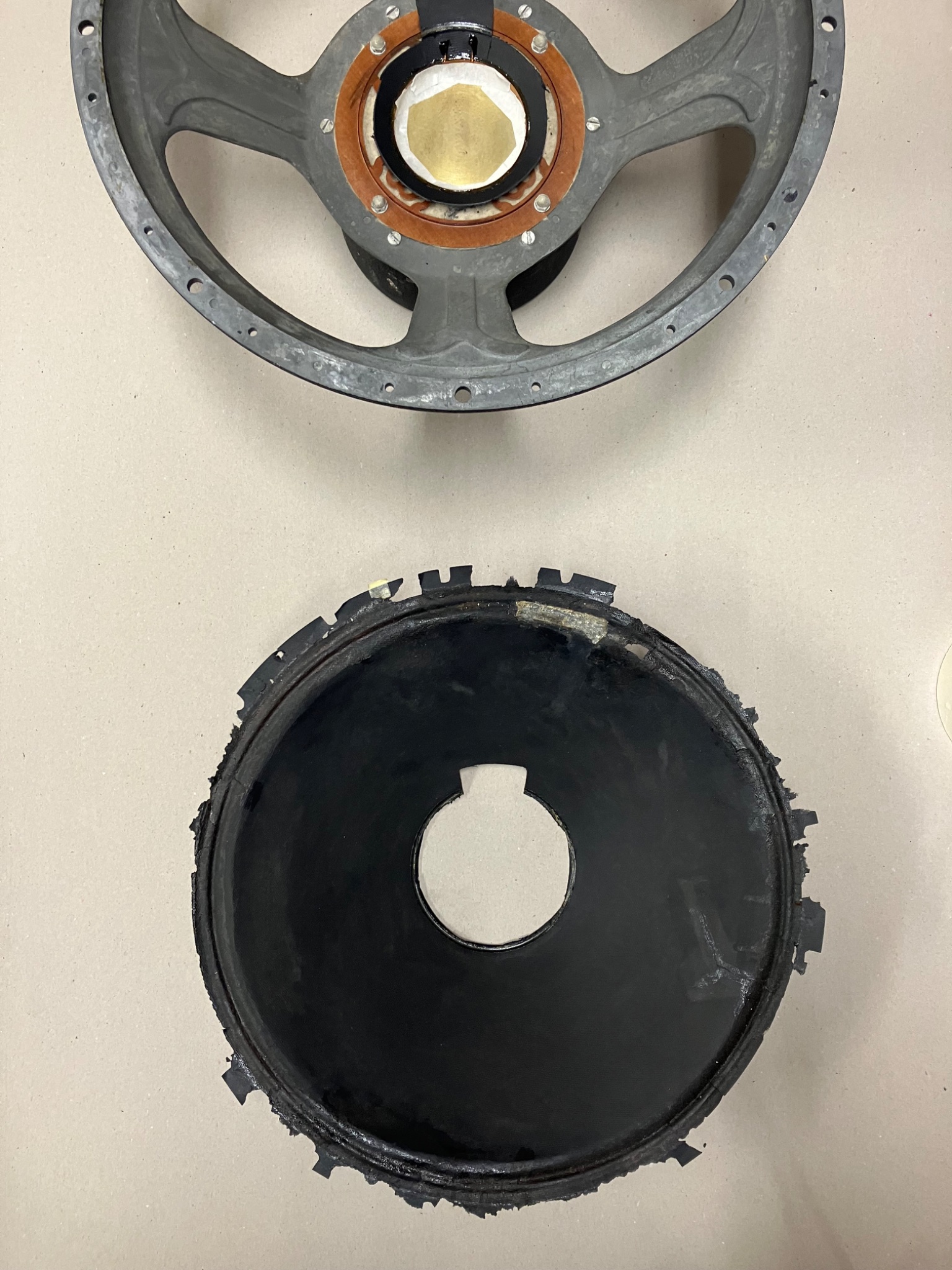

Can a lower mass on the replacement cone causing the high Fs, if this a plausible situation:
1. How do I find a reference value on the RWB cone?
GM has already pointed out that the RWB cone is probably the same cone used in earlier models, with field coils? Both has no standard TS parameters…
2. How precise should this reference be? —I do still have the original cone, but it is is cut down, see attached photo. Is this a good enough value?
3. been told that; by adding mass / coating to the replacement cone, it can, maybe, interfere with the mid range frequency produced from the 515RWB, one solution is to use a low-pass filer around 500hz..the dividing is already low, but should it roll off naturally in the top?
4. What should I use coat the cone with for adding mass?

I’m stuck. I need a referanse weight of one 515RWB, if not the extra mass I will coate my 515RWb will be too imprecise.
I will need a reference on a complete 515RWB to fingers out how much mass is missing.
It will probably never be tuned, as the original paper cone was intended; for replicating voices ( the voice of the theater ); but this is what I have to work with.
my interest for getting these a5 parts not only to play, but to sing is of great interest.
If I could get a referanse weight to work with I can do further research and see how it plays potentially better than it does today, then I can further update DATS measurements.
