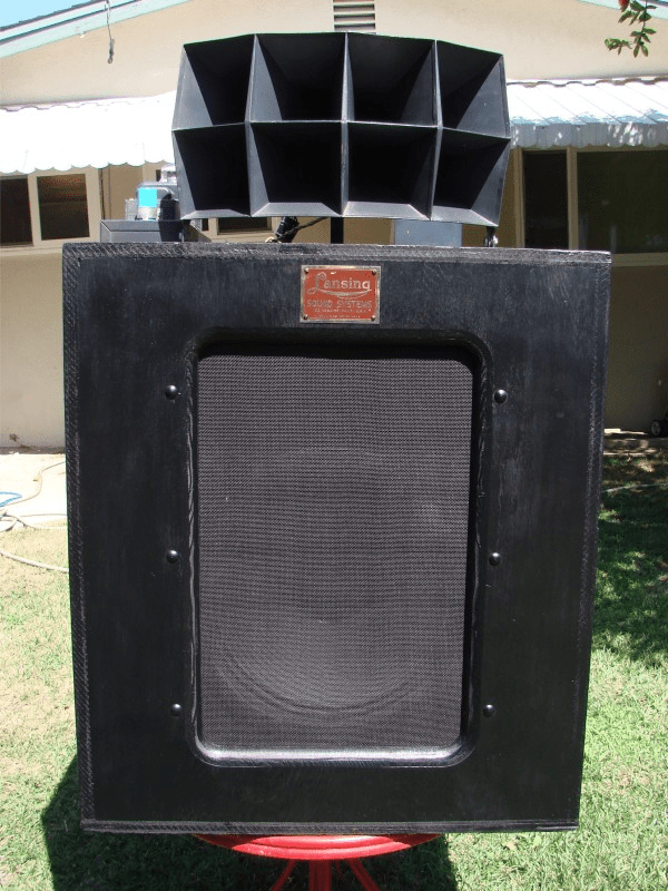

Early 1937 812 Iconic shows 29.5" high 25.5 wide 17.5 deep
I would just capture the look, and use 18mm plywood with much more modern bracing.
Rather large panels, need good bracing. Nothing too magical about resonating, ringing cabinets.

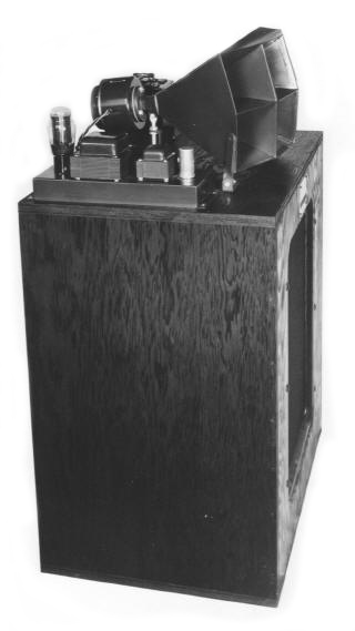

Seems like they have the plywood edges showing on the front, which was also done 1942/43
With the more common Iconic style cabinet. Which I like the raw simplicity for some reason.

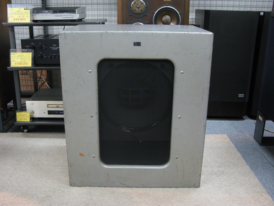

far as I can tell around 45 with the Hammer Tone silver paint jobs is when they made the front baffle
larger and hide the plywood edges.

As noted, plywood edges show on early cabinets.
Later on the silver hammer tone cabinets hide the edges

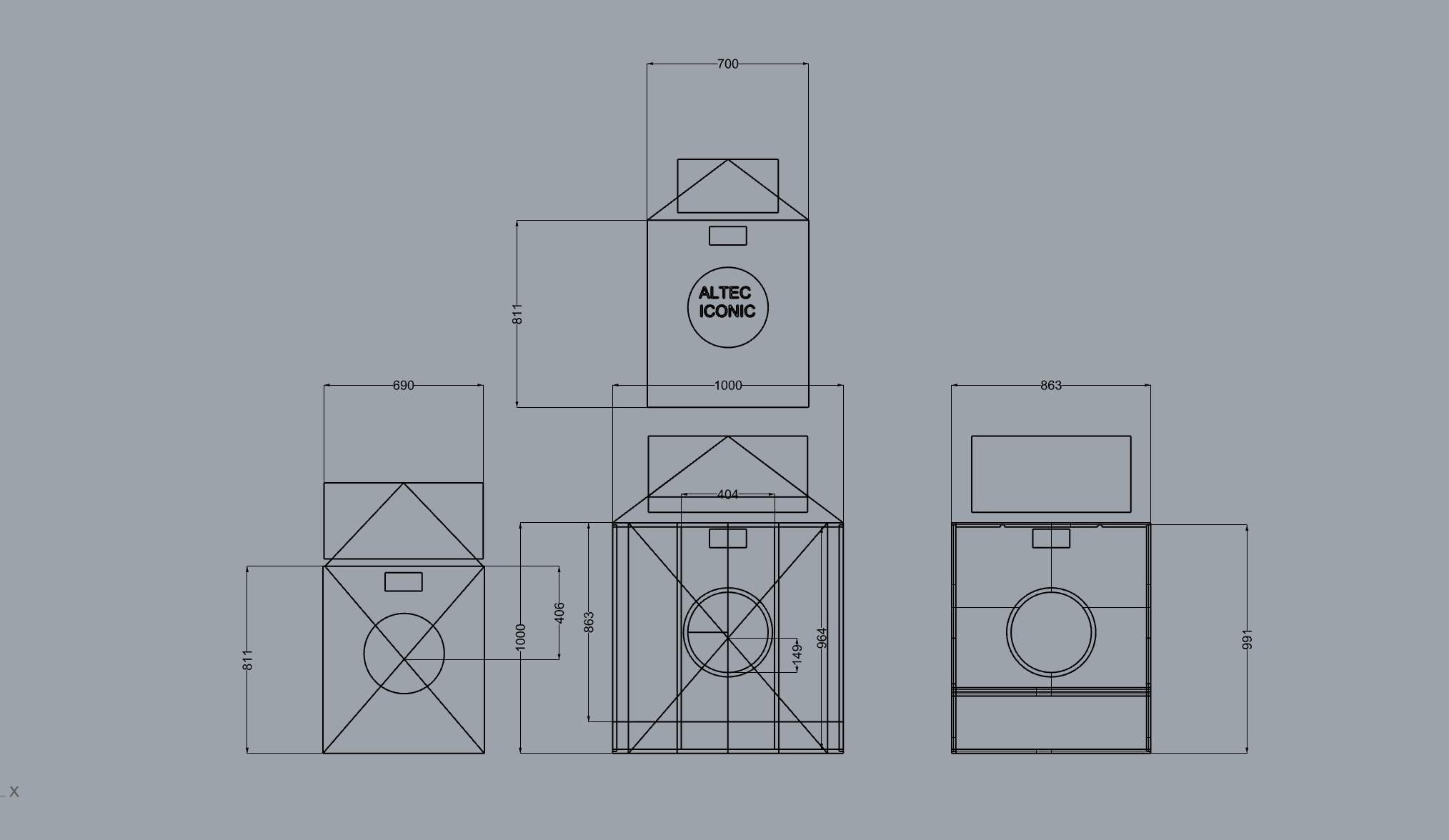

Yesterday I figured out that the original dimensions of the Iconic cabinet will look very small beneath the 1005 multicell horn; it must be much larger than the horn used with the early Iconic cabinets? Will try to rearrange the drawings to figure out how to keep the correct proportions on the box, it will become a bigger box, trying to figure out a way of keeping the proportions and still keep the 202L cabinet.
1. first I was thinking making open chambers to fill out the dimensions of the box, but this would probably make the box to resonate badly?
2. second thought is to rearrange the drawing, see second attachment, last sketch on the lower right hand, and make a sand (dry ) filled plywood box, beneath the correct ( 202L ) cabinet... ?

That alignment is not great. You need to lose the dip just before it ro;;s off. As is may give you more theoretical LF extention, but you uually pay in other ways.

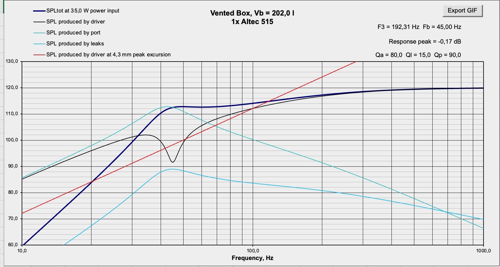

Btw… —any interest in figuring a better alignment if I source the TS measurements we did on the reconed 515?That alignment is not great. You need to lose the dip just before it ro;;s off. As is may give you more theoretical LF extention, but you uually pay in other ways.

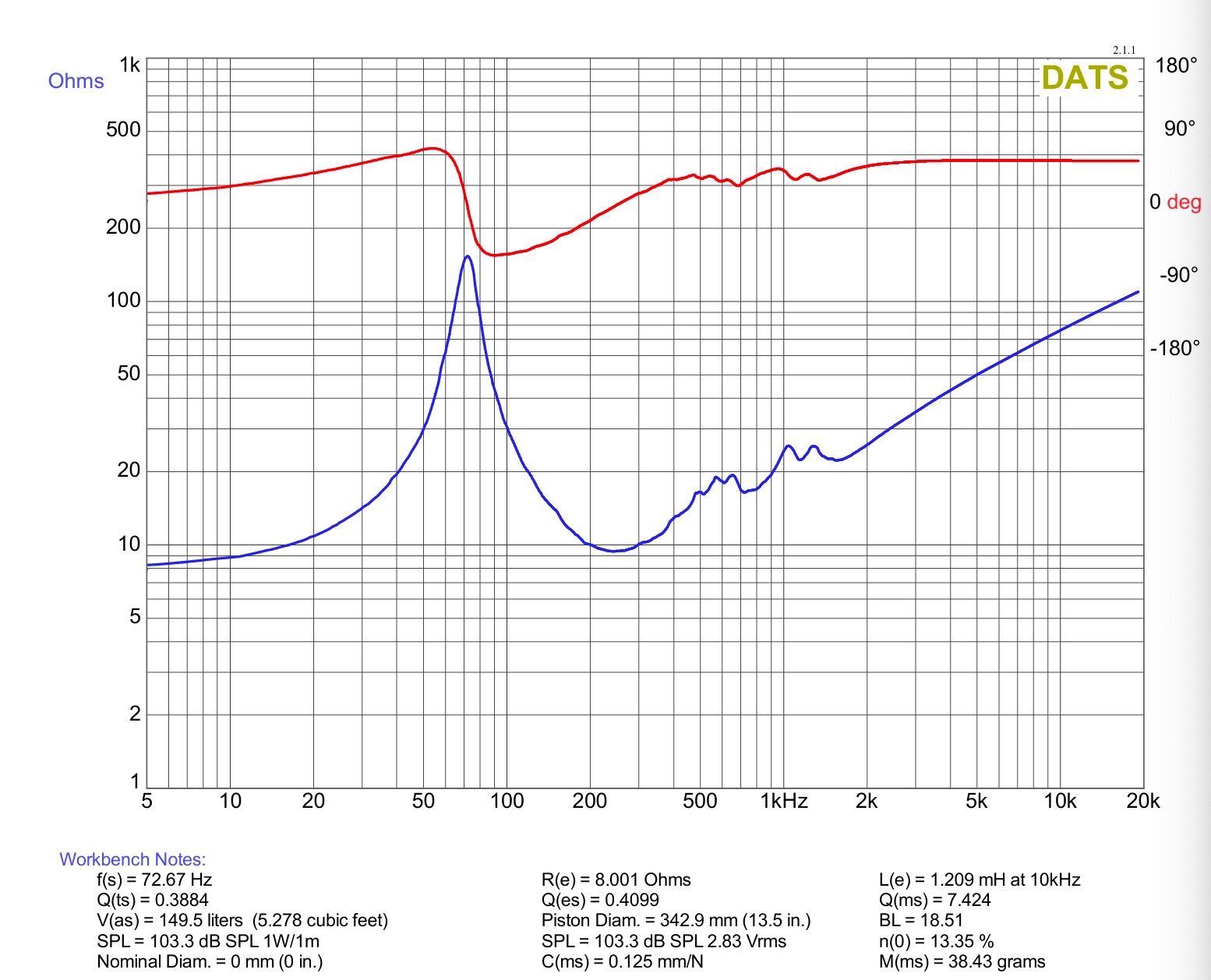

Referring to my last reply here, with measured TS parameters of 5151RWB.
This is above my own knowledge; calculating / running simulations an ideally volume of a ventet box for any driver….
Volumes in size above first proposal (~200L ) is not a problem.

Thanks! If I understand you correctly:
MAIN QUESTION:
1. Do I got a damaged 515RWB, or was this driver ONLY made for horn applications?
--It was taken out from a 1940s H110 cabinet; that's combination of a horn and bass reflex cabinet, right?
The driver did have low measurements with a multimeter before the re-cone : 8.2 ohms, according to others it should have been above that measurement, but still within usable range.
Fs/ Qts RATIO COMPARISON:
The "standard" Fs/Qts ratio of a 515B = 24.7/0.17 = 145.3
My 515RWB gets 187, is that a too high ratio?
I have also on hand, NOT INSTALLED, a complete second paper cone with a newly produced coil with 20ohms windings inkl. new phenolic spyder.
I do not find standard TS parameters of the 515RWB ( produced from 1945-1955 )
I've been told that the 515B ( produced from 1955-1978 )had better capabilities handling low frequencies, the 515B was also more versatile when it came to use different enclosures?

Firstly, IIRC the RWB originally meant it used the original Lansing 15x cones in Altec's new 15" frame for cinema/etc., replacements, so designed for high output impedance amps with either fixed or variable impedance tone controls to get the desired frequency response.1. Do I got a damaged 515RWB, or was this driver ONLY made for horn applications?
As such then, there's nothing wrong with yours, just has an incredibly powerful magnet, so for horns or (relatively) small sealed, reflex speakers.

Hi,Firstly, IIRC the RWB originally meant it used the original Lansing 15x cones in Altec's new 15" frame for cinema/etc., replacements, so designed for high output impedance amps with either fixed or variable impedance tone controls to get the desired frequency response.
T/S per se didn't exist, just the underlying specs, Fs, Mms, Mmd, n0, etc.. FWIW, when I visited the plant in '68, quality assurance (QA) just measured n0 (scroll down to bottom).
Correct, changing over time as the electronics changed from tube to SS and all that implied to the point where many had relatively weak motors due to increasingly prohibitive AlNiCo cost.
Regardless, the 'name of the game' if I was still active is I'd use Samarium cobalt (SmCo), which can achieve the original WE/Lansings's field coil strengths required for the 'heart attack' fast transients live music achieves.
I'm trying to warp my heard around the information you're sharing:
If I'm understanding you correctly; the alnico magnet of the 515 has a almost 10 times more impact on the n0 measurement than a random modern, very well, produced woofer / midrange drivers?
515 RWB n0=13.35%
Random modern woofer / midrange with alnico magnet : n0=1.42%
