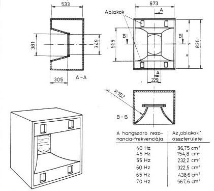

Thanks! Don't recall this one, but FWIW here's the '70s simplified 'official' various cab drawings for local shops (828/#11) to make after building/shipping costs became too great to continue.
All the 'official' available I'm aware of including the one I used in '64 for the 825.

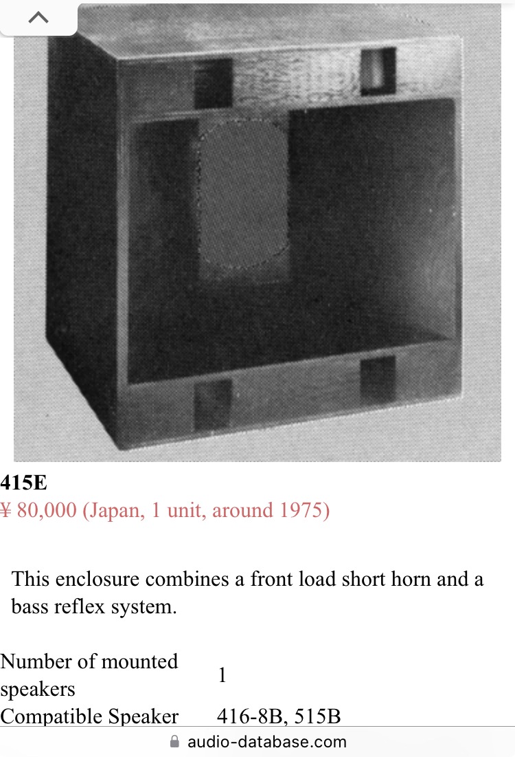

The Altec 415E cabinet… Never seen this cabinet before, but I REALLY like the looks of this one. Again, I do not find any drawings…, does anyone know where to find?
https://audio-database.com/ALTEC/unit/enclosures.html

Not seen the 415E but I'm not sure I like it. The reflex ports being both above and below the woofer means that the top horn is now further from the woofer and generally I thought it's best to keep the two close together.
This one looks like the JBL 4560, a short bass horn reflex PA cabinet, which was often used for life rock music in medium sized venues in pairs and multiples. It has a chest compressing, dry thump, when used for drums. There is not much below 70 Hz and it was used up to 800 Hz. For lower frequency it was often used with 18"or 2x18" W- bass bins. I have heard it in life PA use so often, I still remember it's sound very well.
Not the best for home use, it needs some distance to the listener, maybe 5m, to be enjoyable and, as mentioned, no deep bass at all.

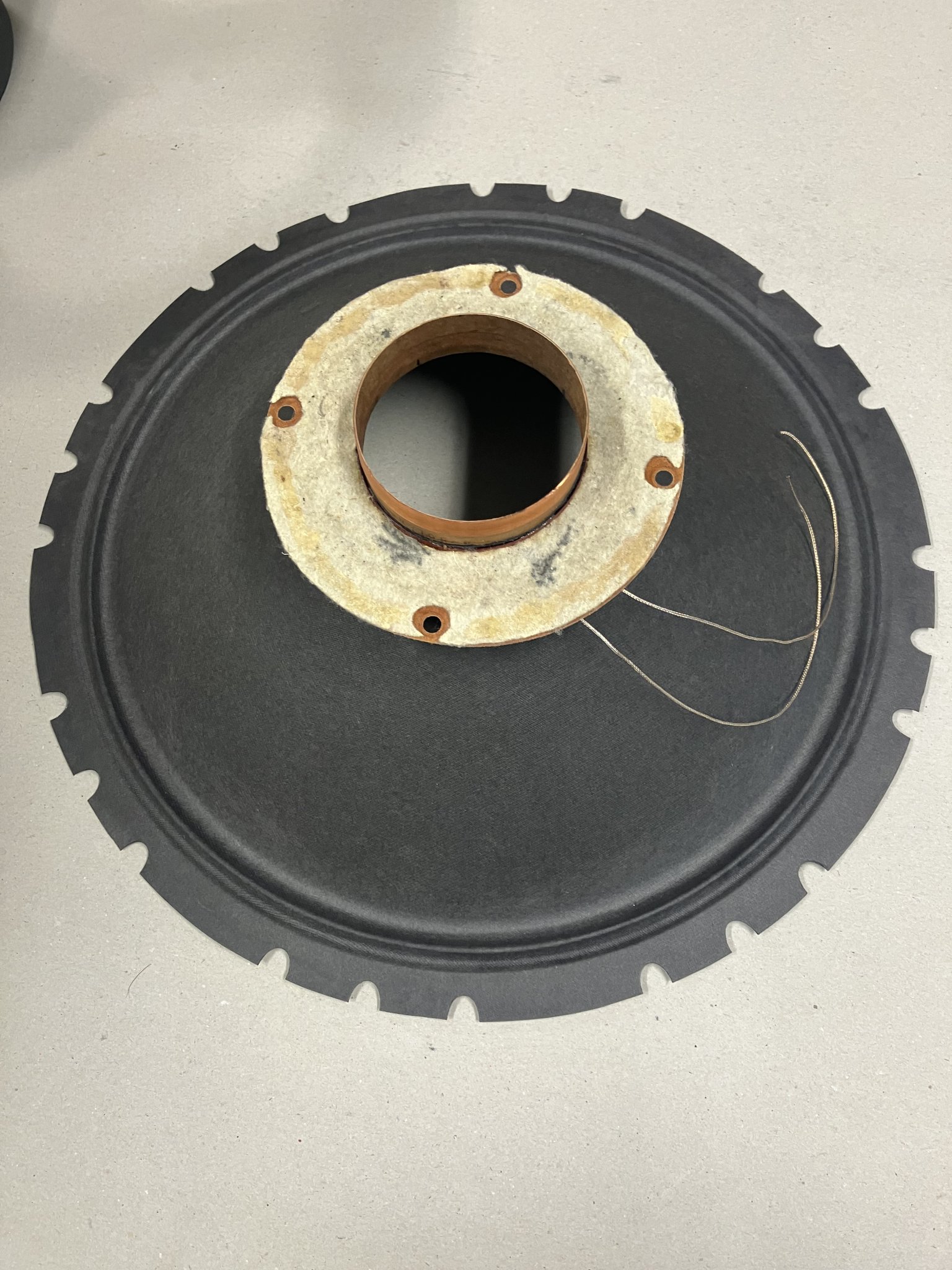

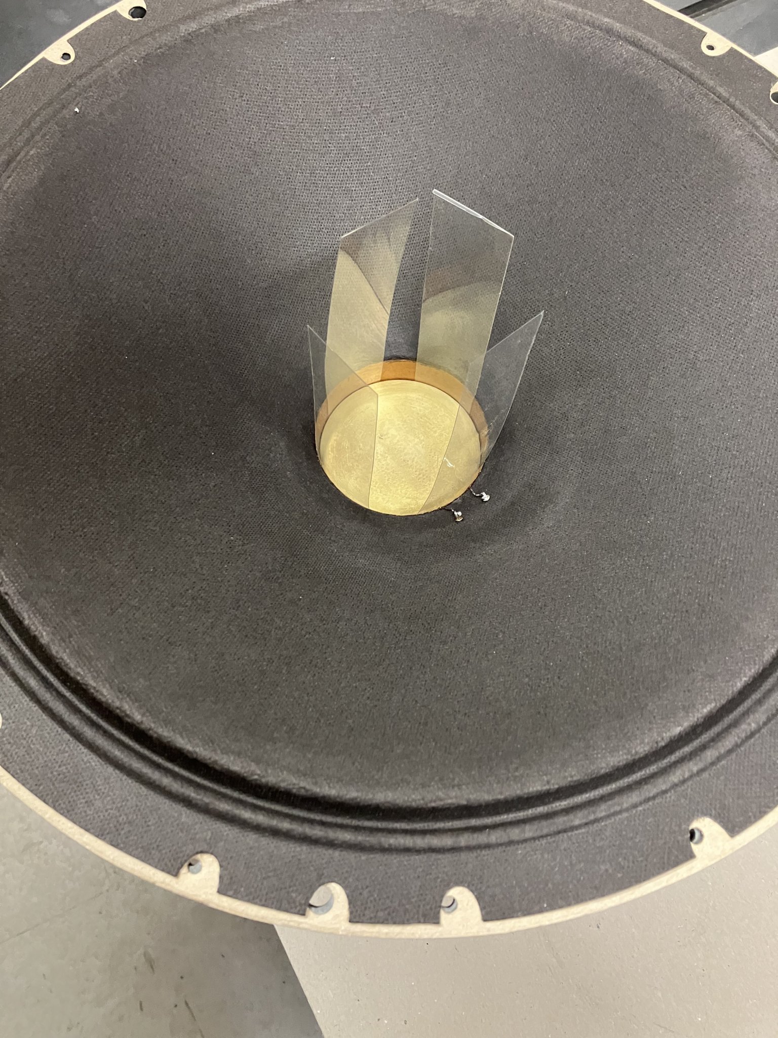

When I finish re-coning my 515, I will measure the driver with a Dayton DATS to get parameters...

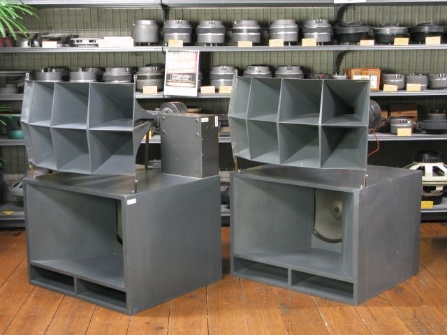

Am I the only one who doesn't like this large horn being driven by just one 15" woofer ? Doesn't that lead to an extreme discontinuity at the horn throat ? I'd prefer this horn with two drivers (like in GM's avatar) although there will still be some discontinuity. And parallel walls in horns aren't that good either. The A7 would be better regarding both this issues but still not perfect IMO.
I guess the RCA designs were a little better in this respecct than the Altec ones.

In a small to medium room a pair of 4560 loaded with 2220 woofers will go down to 45hz with a near rear wall listening position. Room reinforcement probably helping the bottom. I have a pair and have measured them myself in two different rooms with professionally calibrated microphone.This one looks like the JBL 4560, a short bass horn reflex PA cabinet, which was often used for life rock music in medium sized venues in pairs and multiples. It has a chest compressing, dry thump, when used for drums. There is not much below 70 Hz and it was used up to 800 Hz. For lower frequency it was often used with 18"or 2x18" W- bass bins. I have heard it in life PA use so often, I still remember it's sound very well.
If you start stuffing ports you can bump that even lower with a small loss of spl at the bottom.
These go flat to about 25hz with all ports closed off and about a 6db shelf applied at 150hz.
Keep in mind this is for home use probably a watt or less normally, not pa use, not party levels typically.
The integration at about 4m isn't perfect but it's no worse than what an 825 or 828 would be IMHO. Still very liveable.
I feel the 4560 is more flexible than an altec a7 and doesn't result in the hf pointing way over your head when seated. They are just the right height. I think you'd like the 415e since it appears to be quite similar.
No, unfortunately not.Hi, thanks for the input, do you got plans for the RCA cabinet?
There is a very nice looking one on e-bay currently:
https://www.ebay.com/itm/166597741054

I find the looks of the Altec 415E better, maybe it will work better if this cabinet is flipped 90 degrees? Or tilted up in front?
Attaching drawings of the 415E in this post+ photos, found on web, on the 816 cabinet…
Thanks!

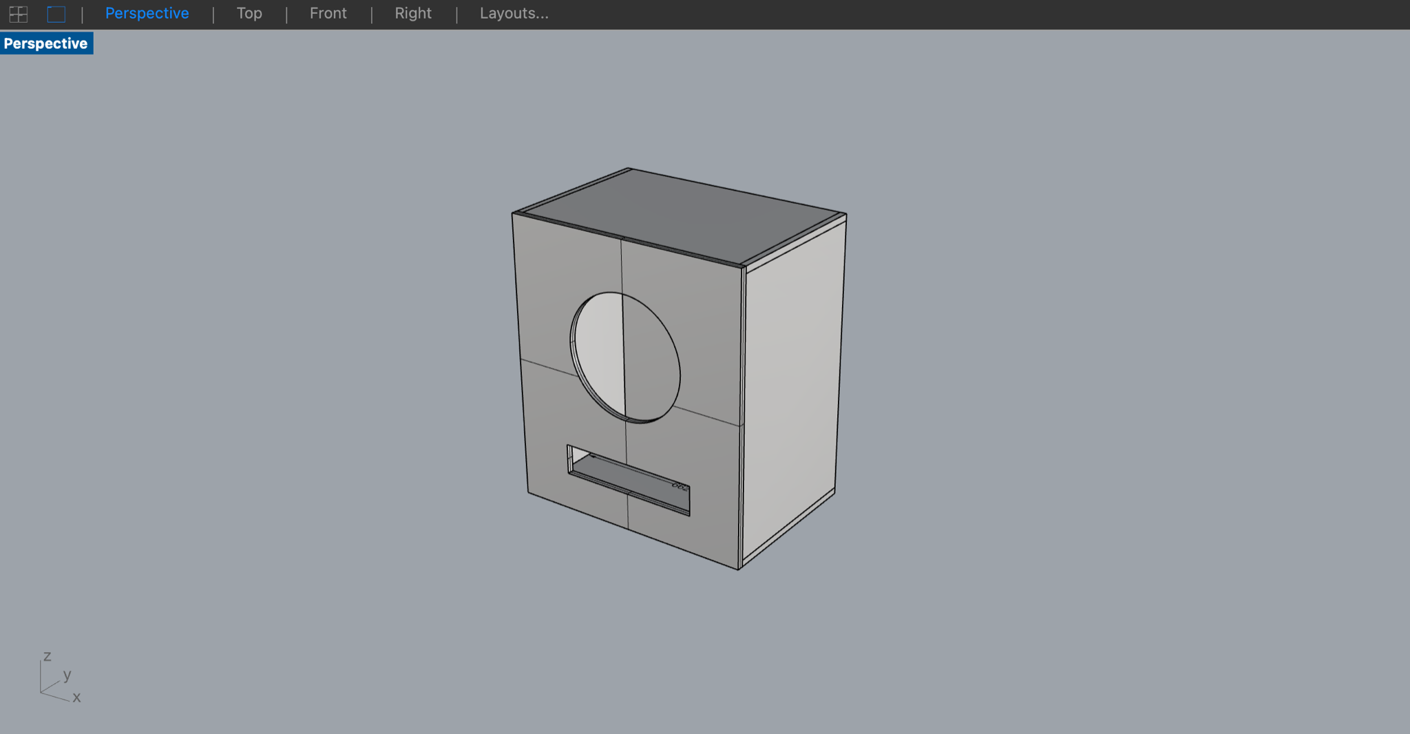

I have made drawings for a 202liters vented cabinet based not the proportions of the Altec early black 612 cabinet, will make lapjoints, nail and glue it together ( the opening on the attached 3D drawing is probably not correct in size )
Should I make this cabinet out of 3/4 (18mm )inches pine plywood or 5/8 ( 15mm )?
