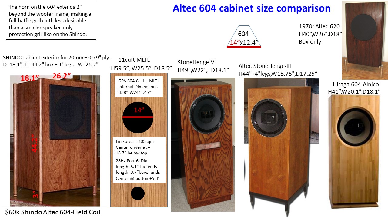

From the dimensions I found on the SHINDO website, their large SHINDO cabinet for the Altec 604 is about 4" taller than the Altec 620 cabinet. This puts the center of the horn tweeter at about 37" - 38" height.
Yes I know, what I have done is a long and careful R&D before my building of speakers. What I came up with is that I have to have 250 liters (9 sq.f) or more to reach about 30Hz as the lowest frequency then Altec 620 is a good starting point. There are many who build with 620 if it is so then there must be a reason that they are based on that construction.
The size is no problem for my part neither the place nor the gf has any objections just it looks good and sounds nice.
I have never heard a couple of Shindo's speakers but have a friend who has some of Shindo's amplifiers and preamps they are good then I have looked at Shindo, Jean Hiraga and others. Then I have a lot of experience of my own buildings with full-range, two-way and horn building over the years but I still check what others have done and try to avoid mistakes.
I will have 940-960 mm approx. 38 in up to the underside of the horn in my own experience, the treble becomes more enjoyable in the horn system maybe right or wrong but for me it becomes perfect, try it!
