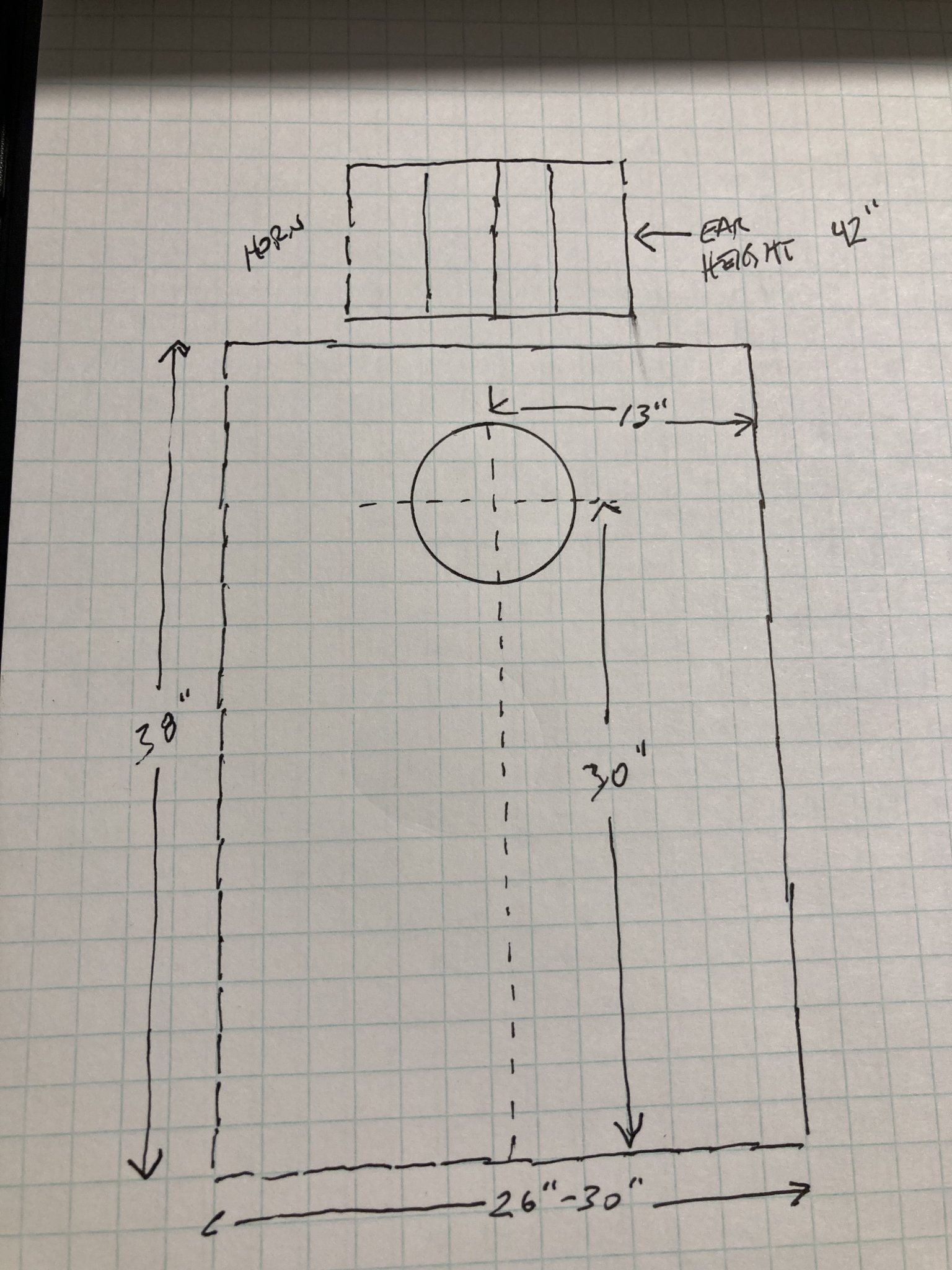

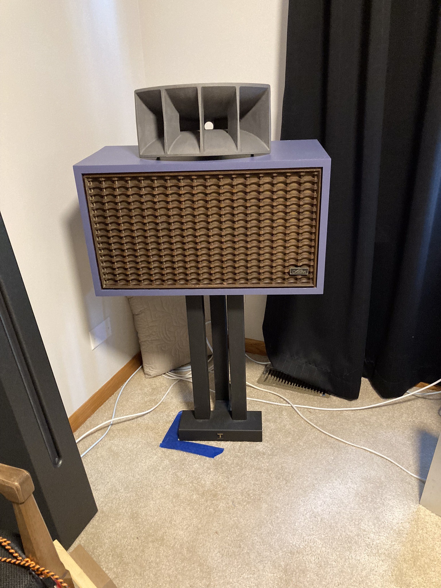

Hi, I know this thread is a bit old and I requested it to be reopened. I would like to repurpose the 406-8Y from my Bolero’s into bigger cabinets to get some more low end out of the as above in this thread. I’m new to MLTL cabinets and they are very intriguing!
GM, could you help me with a design that is roughly 38-40” high instead of the one you outlined above? I want t to plop my horn on top of it.
Your response is appreciated.

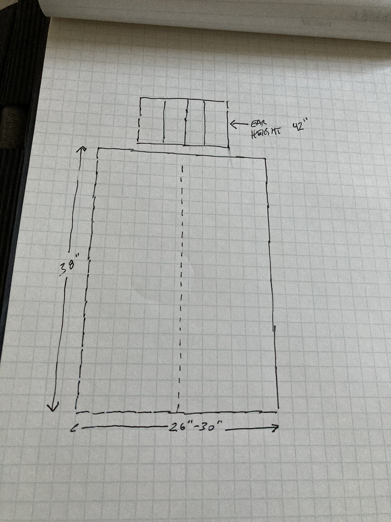

Just read through the posts above and I didn’t find anything about “centerlines” provided by the member who wanted the cabinets or anywhere else. I can go 26-30” wide and 38” tall. The horn listening height is 42” from the floor. Depth I’d like to keep the depth at 12” or so. If it can’t be designed based off this info I understand. Thank you reviewing my criteria!
I want your desired centerlines, so I could figure out how they line up with your desired cab height's harmonic structure.
Hmm, at this point me thinks I'm better off giving you some data to work with WRT pipe harmonics, so we need to work with i.d. specs and the various driver, vent offset combinations are:
Both the driver and vent should be at a vented pipe's odd harmonics. You can figure it out using Hornresp's 'path' slider in 'chamber' or just use these as proven audibly 'close enough':
Z = (L)x ~ 0 (top), 0.217, 0.349, 0.424, 0.561
Vent offset only, depending on box HxWxD ratio: Z = (L)x ~0.651, 0.714, 0.848, 0 (bottom)
Of course the first one doesn't apply to any ~zero area [CSA] terminated pipe/horns and if your desired ear seated/whatever driver height doesn't line up close enough to your design, suggest you change the alignment tuning [pipe's length] by adjusting Fs to get it to line up with one of these offsets.

- Altec 406 - 8Y
