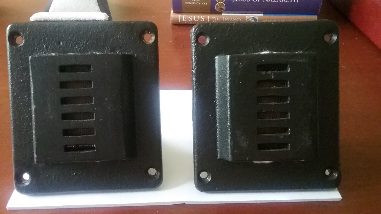

Hi GM - Thanks again for all your help.
I have a couple "Morel" dome tweeters rated at 4 ohm/92db that might work (MDT29-4).
Also have a couple (monopole) Heil Air Motion Transformers - Not the big ones, but sound very nice. These too are 4ohm and appear to be quite sensitive (I don't have the specs).
Jeff
Here it is... finally 🙂
Thanks! Don't recall these.
Regardless, got a sketch of sorts, now just have to find it........anyway, depending on whether my power gets knocked out and for how long before I can post it may be up to several days as my locale typically looses power anytime we get high winds due to living in a near forest of large trees.
