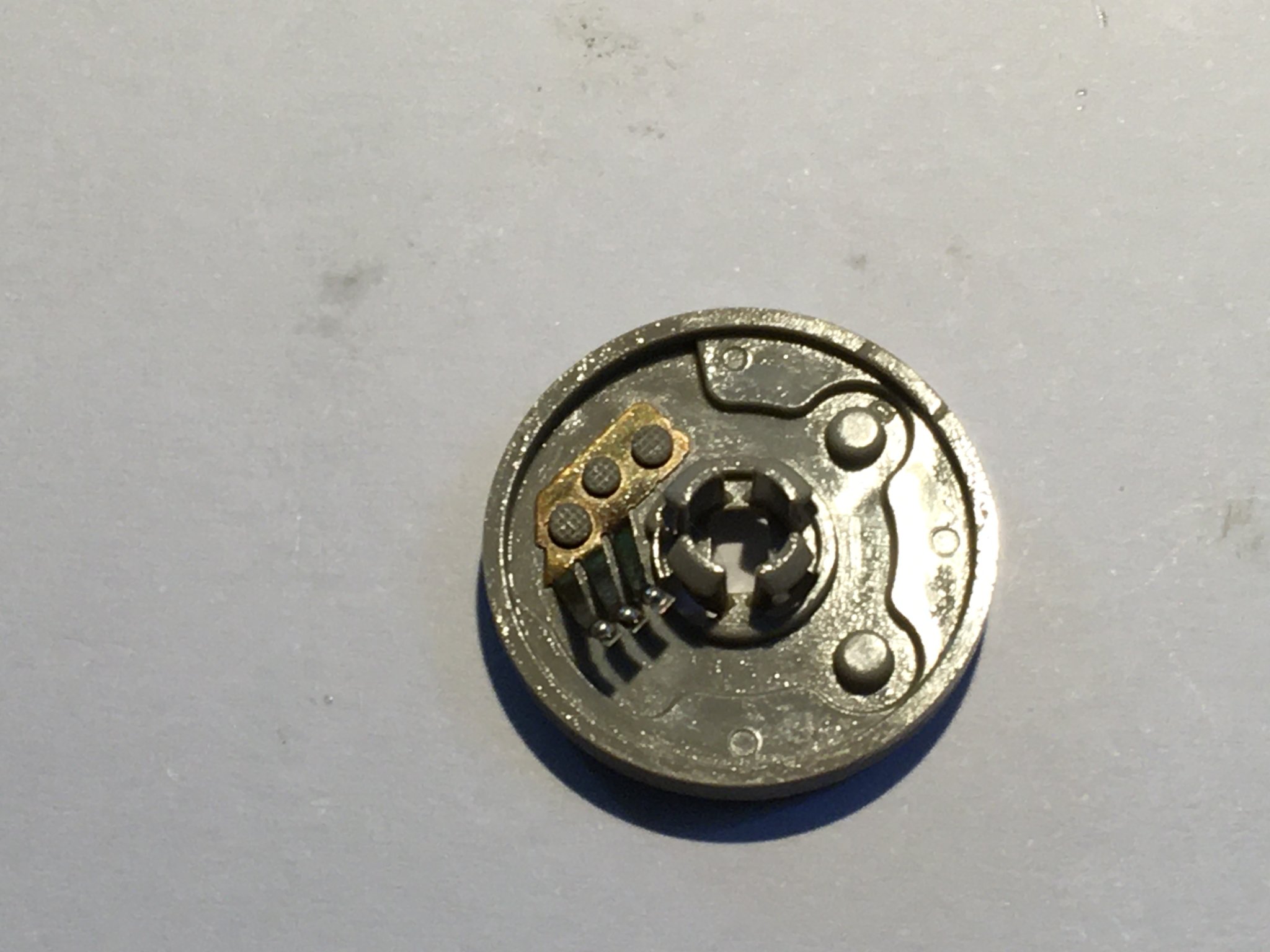

The main reason for the extensive oxidation seems to be the the used contact grease (also a great issue on plastic rotary switches from LORLIN - go to

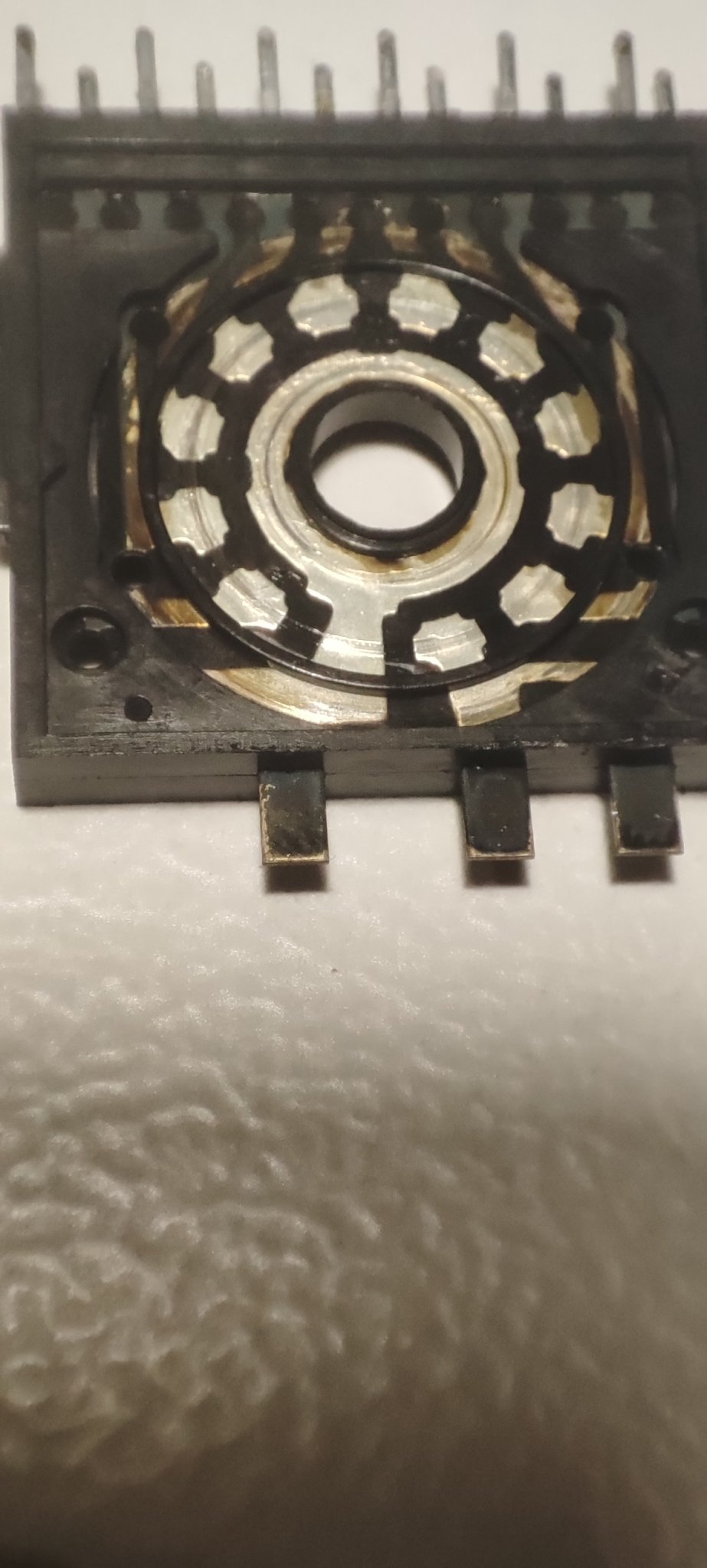

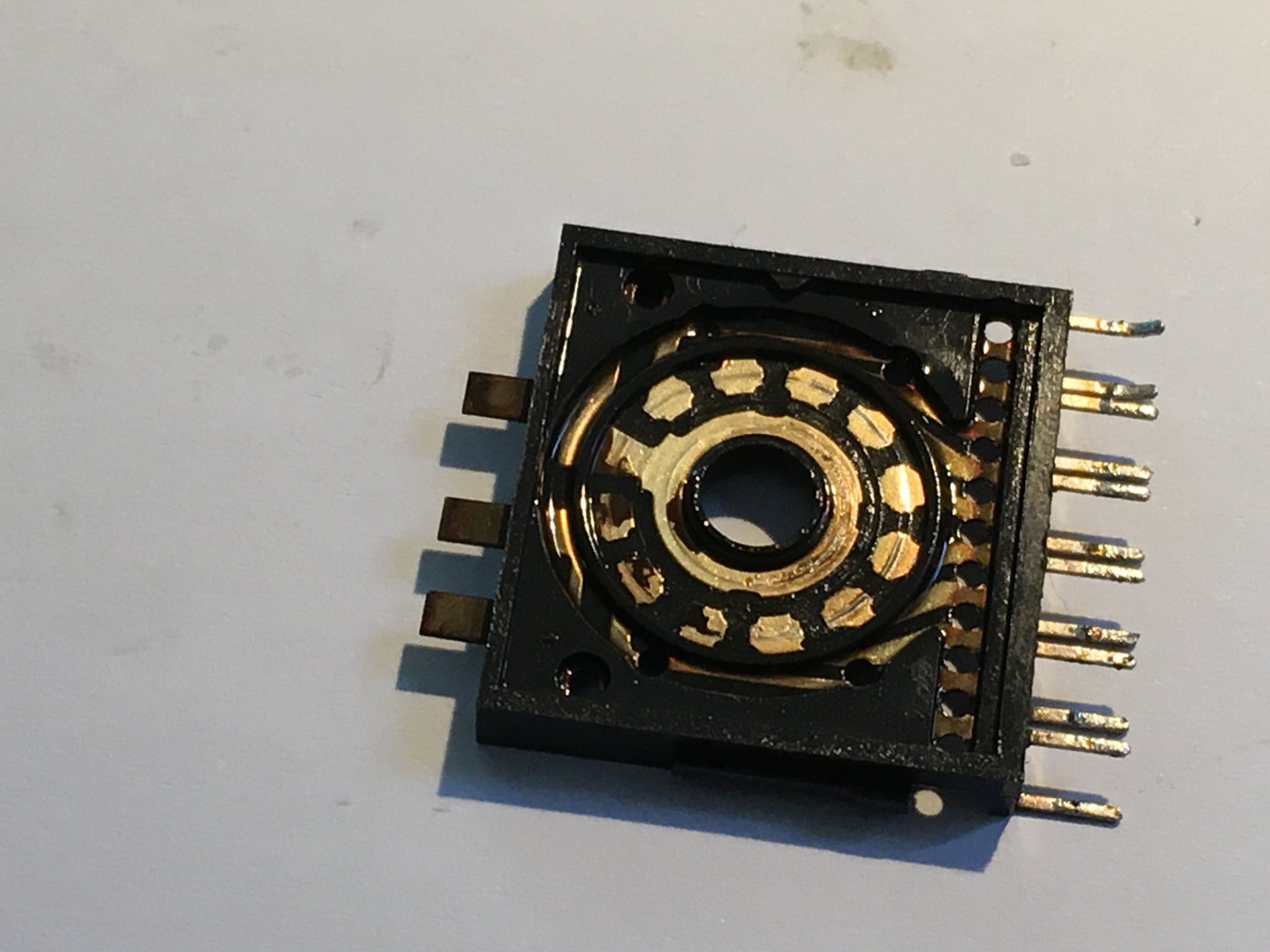

I'm doing the same cleanup on my Arcam Delta 290 rotary switch. I've found Alps to use grease too on the contacts. What did you use in place of the grease?
The photo was taken before cleaning it
Then I won't grease it again!

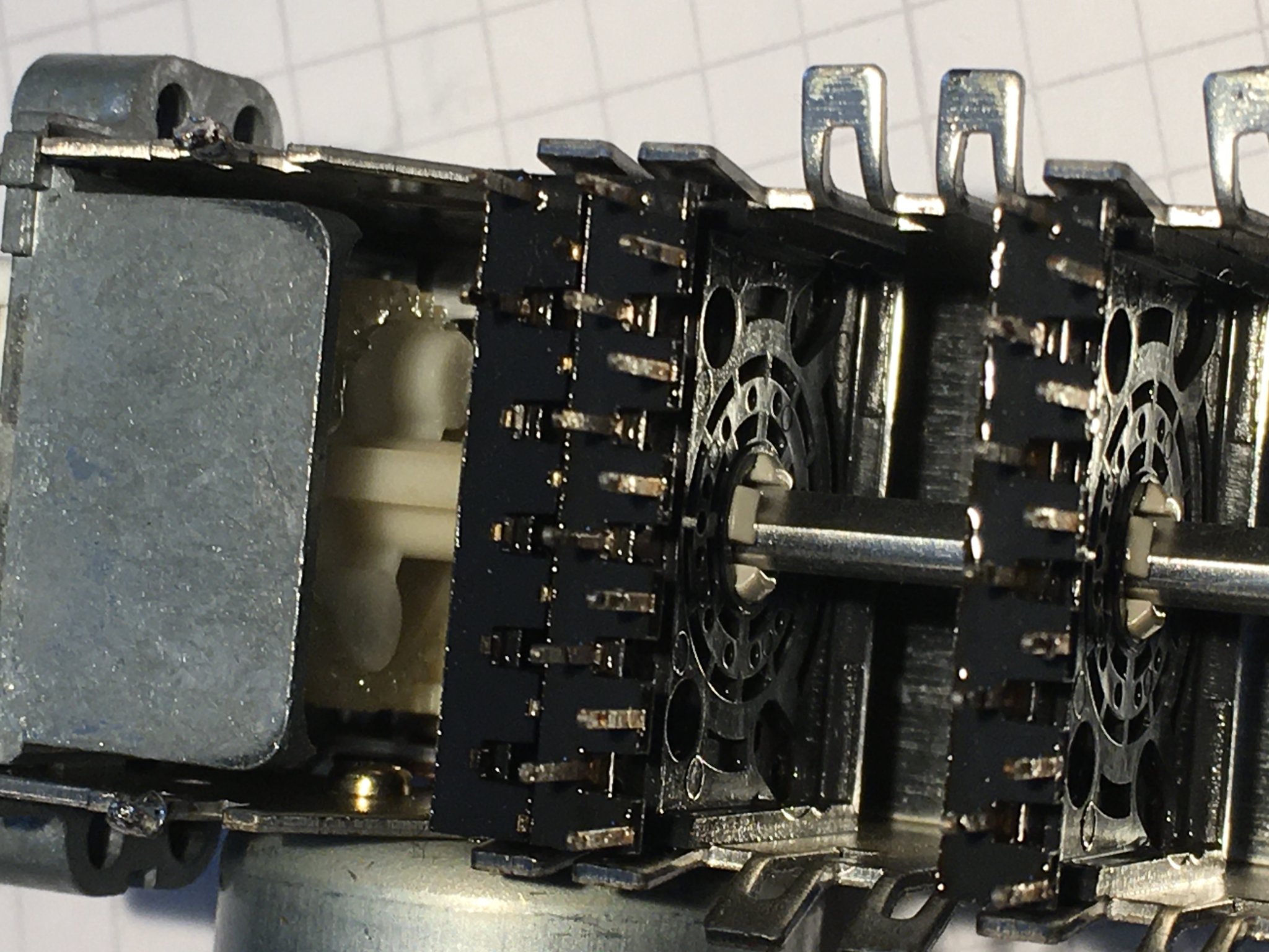

I also own a Yamaha RX-750 and it suffered from the same problem. I disassembled the switch. The switch was full of contact spray on the inside and outside and yet the contacts on certain parts did not make contact and that could be heard in the sound. So with or without contact spray the switch crackles. The switch is cleaned with acetone and alcohol and allowed to dry. That got me thinking. In fact, such a switch is used so little that the parts that are not in contact can oxidize. I cleaned the contacts and also increased the spring tension of the contact fingers. The switch was then reassembled without contact spray. And even though the switch was clean, the switch still cracked. So it must be something different. My theory is that even though they are gold contacts, an insulating layer remains on the contacts despite cleaning with acetone and alcohol. How do you get this layer removed?
I was able to clean sealed relays by connecting them behind an astable multi-vibrator and letting it chatter with a 2 Hz signal for a few hours at a slightly higher voltage than specified. Success assured.
Now back to the ALP. The problem turned out to be just at the beginning and end of the switching point. So there was a spot with pretty good contact and then an area on either side with the insulation layer. The solution was to manually rotate the switch through all positions with a large number of turns at 1 Hz. You essentially sand away the insulation layer by repeatedly turning. So far the cracking has not returned. The same technique can also be applied to potentiometers to a certain extent. I often add some silver graphite for locks into the potentiometer and turn them around. That's better than injecting greasy gunk into the potentiometers.
The pictures are in the dirty state of the contacts.
