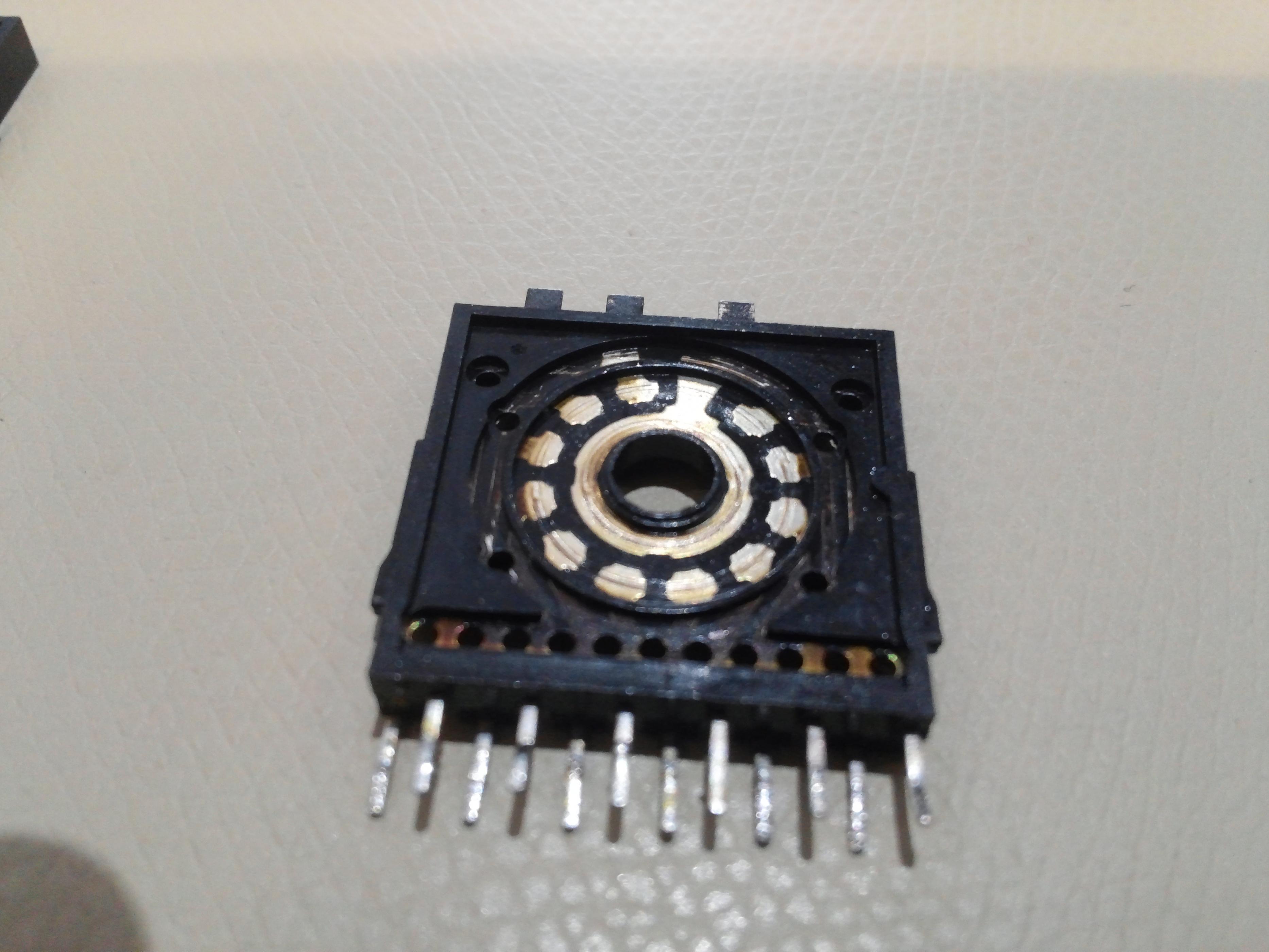

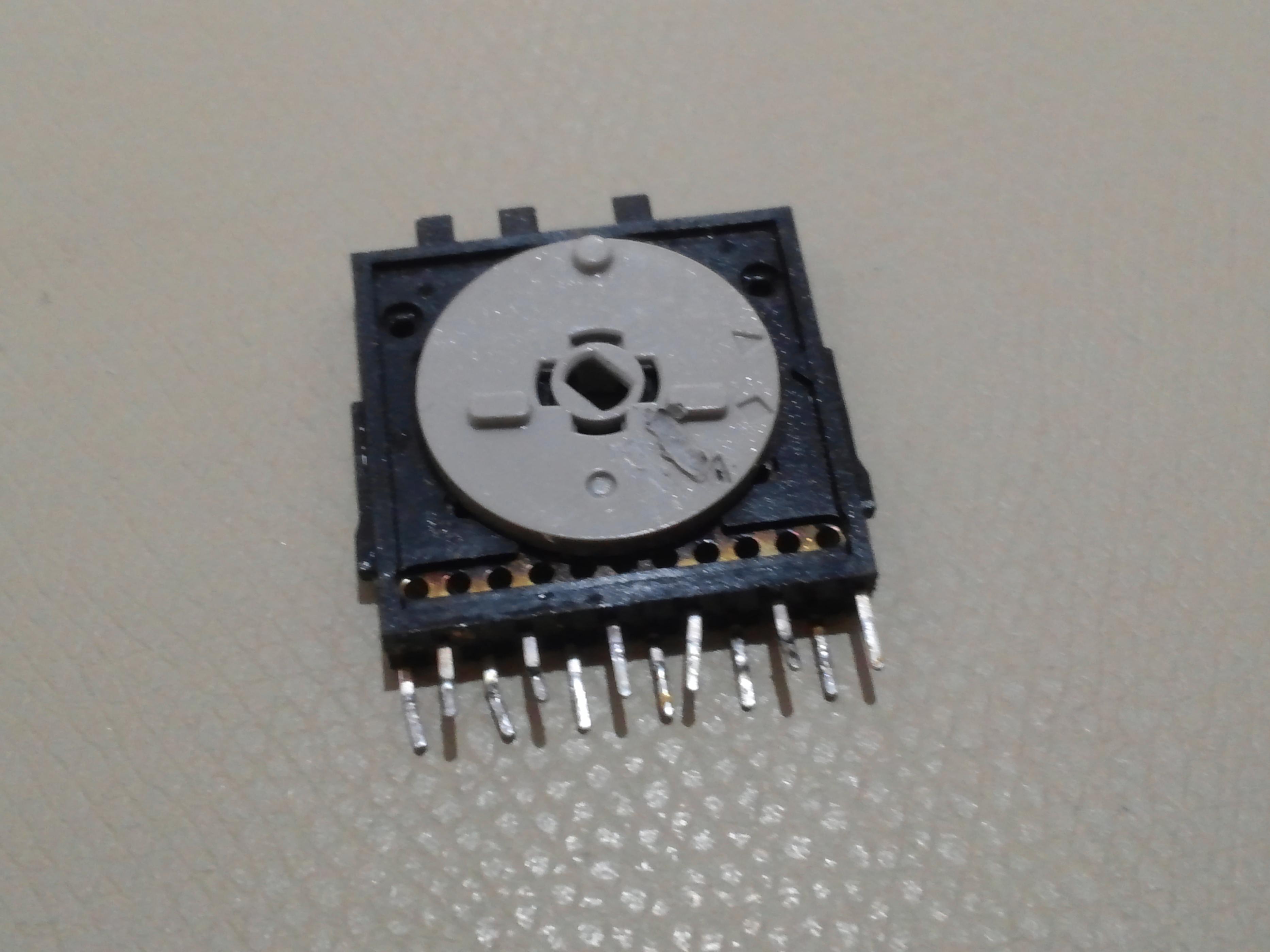

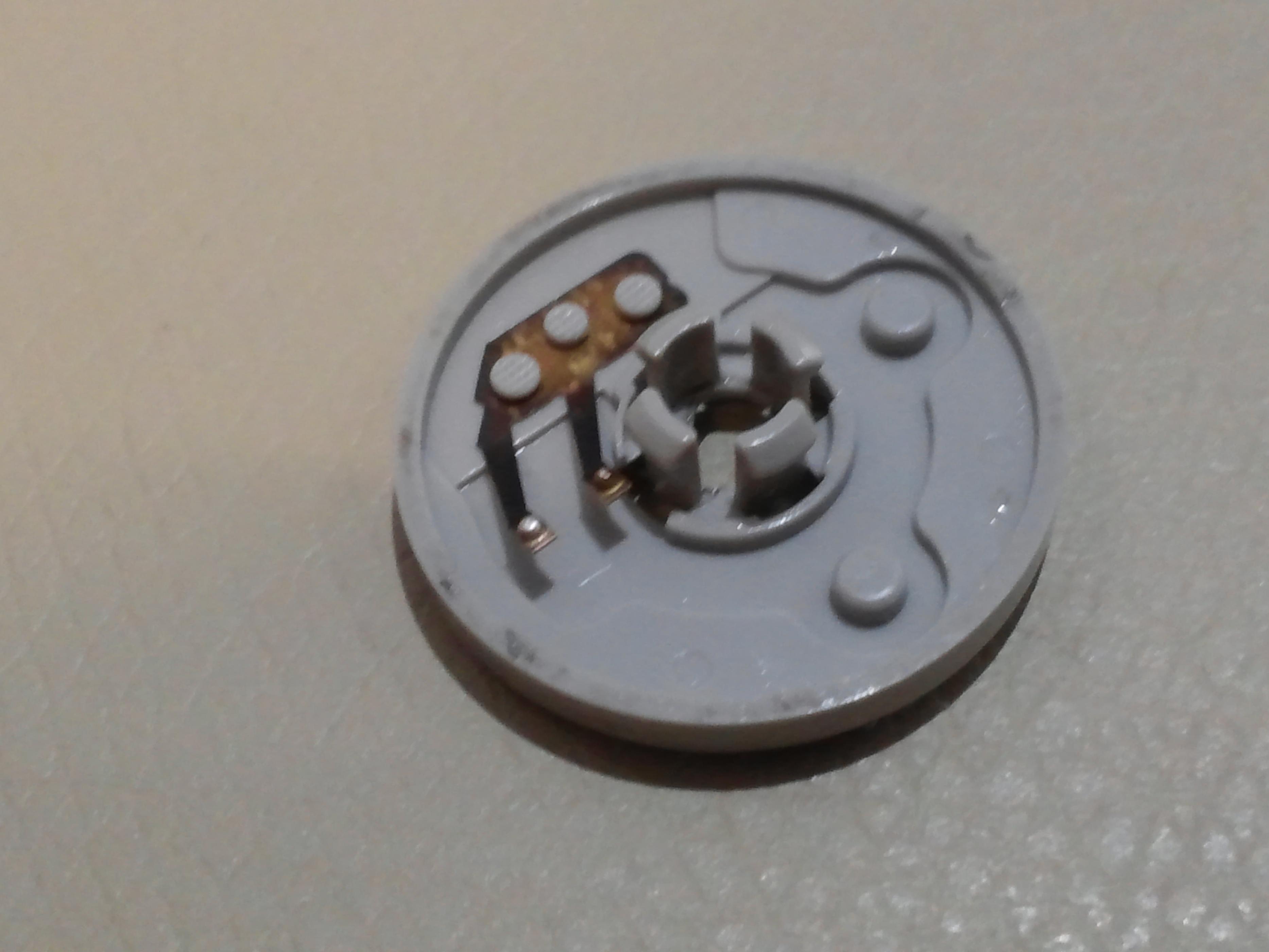

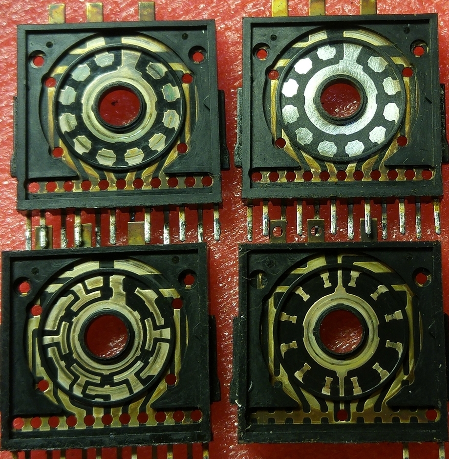

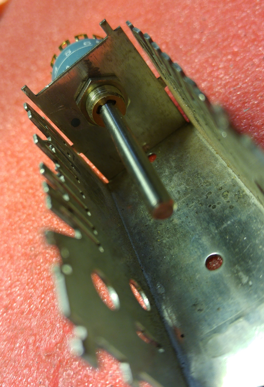

The attached images are from me.
Clearly to see are the contacts before and after cleaning. After assembly the rotary switch and resold on the PCB the user get a kind of operating while the input select like new condition, i. e. without any dropouts at one of the channels.
It is particularly difficult (very hard) to desolder the rotary switch in such cases, where the solder pins were bent before soldering.
In case of breaking the solder pins silver wires must be soldered. That means the risc of alter the correct installation position.

Nicely done! How did you remove the worn ridges in the contacts?
I do wonder though, just how long your patch will survive for.
Many have found such work as only delaying the inevitable.
Real issue is these are Low Quality switches.. Period.
The contacts are thin, soft and largely inadequate for significant ongevity.. at least much beyond the Unit's Mfg Warranty.

However - you are right with your estimate with bad reliability and short longevity in some cases. But most amps work since several years without trouble after doing this work.
In this case I have a question: In which other amp models this kind of Alps rotary switches are in use?

There is some Yamaha , a few Sansui AUX series , the Arcam delta 290 and also got to be a few Marantz also .
The switch has been an issue many years now and cleaning even if done your way ( we do it with other ways also ) so beyond cleaning always there will be an issue of how firm the contacts will be .
Been cleaning some with 100% success but some other i had to replace with relay boards ( lost the remote though ) to keep the amp running .

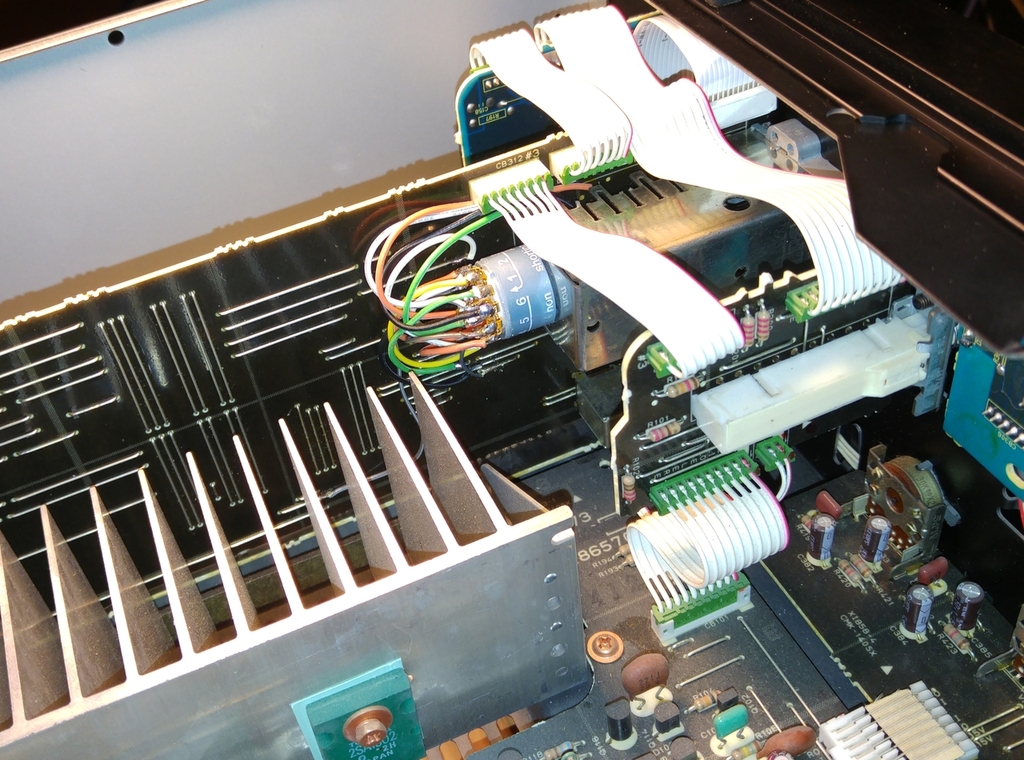

The rotary swich from this amp I have had shortly for disassembly and cleaning:
Minhembio.com - Hemma hos Buj - Under skalet på anläggningen
the closer inside look shows the same problems than the pics from post #1.

Finally, I manage to align the wheels, after looking to
the service manual with the schematics.
But I broke one of the small axis of one of the wheels. Probably
the plastic got stiff with the age. As there remains two of the four
bits. I still put if back, with a spring in order to exert some pressure
to improve the contact.
After remounting, to my high surprise, it works.
Even the motorised command work, at least for most of the
selections (Pb with the Tape2 and Tape1), but this is more than
I need. This amplifier has been waiting for a fix for 10 years.
For the first time since, the sound is perfect.
Thanks for the information, that was really helpful.

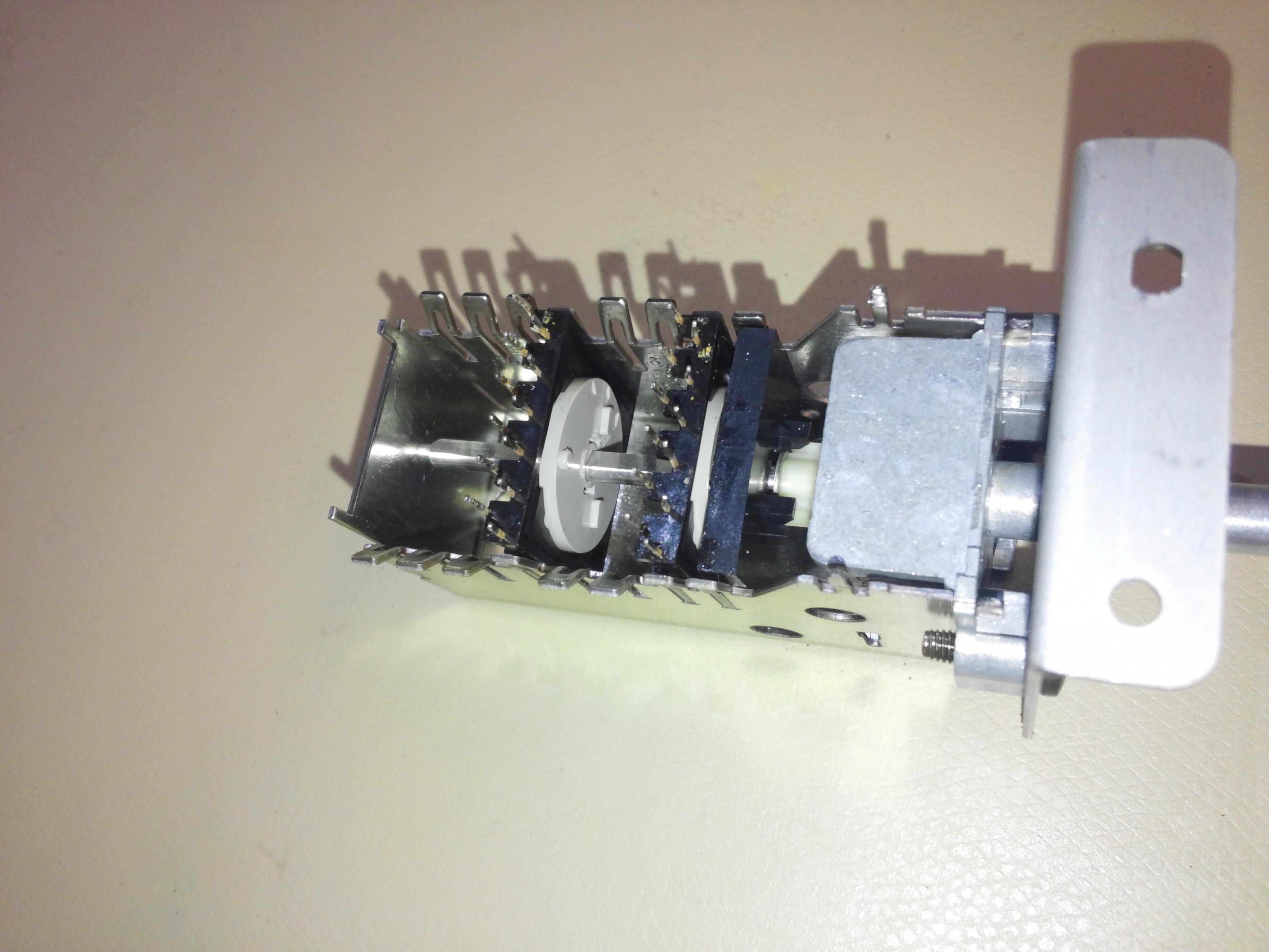

I see that many have issues with the specific switch and i hope that the rather long post below might help a bit.

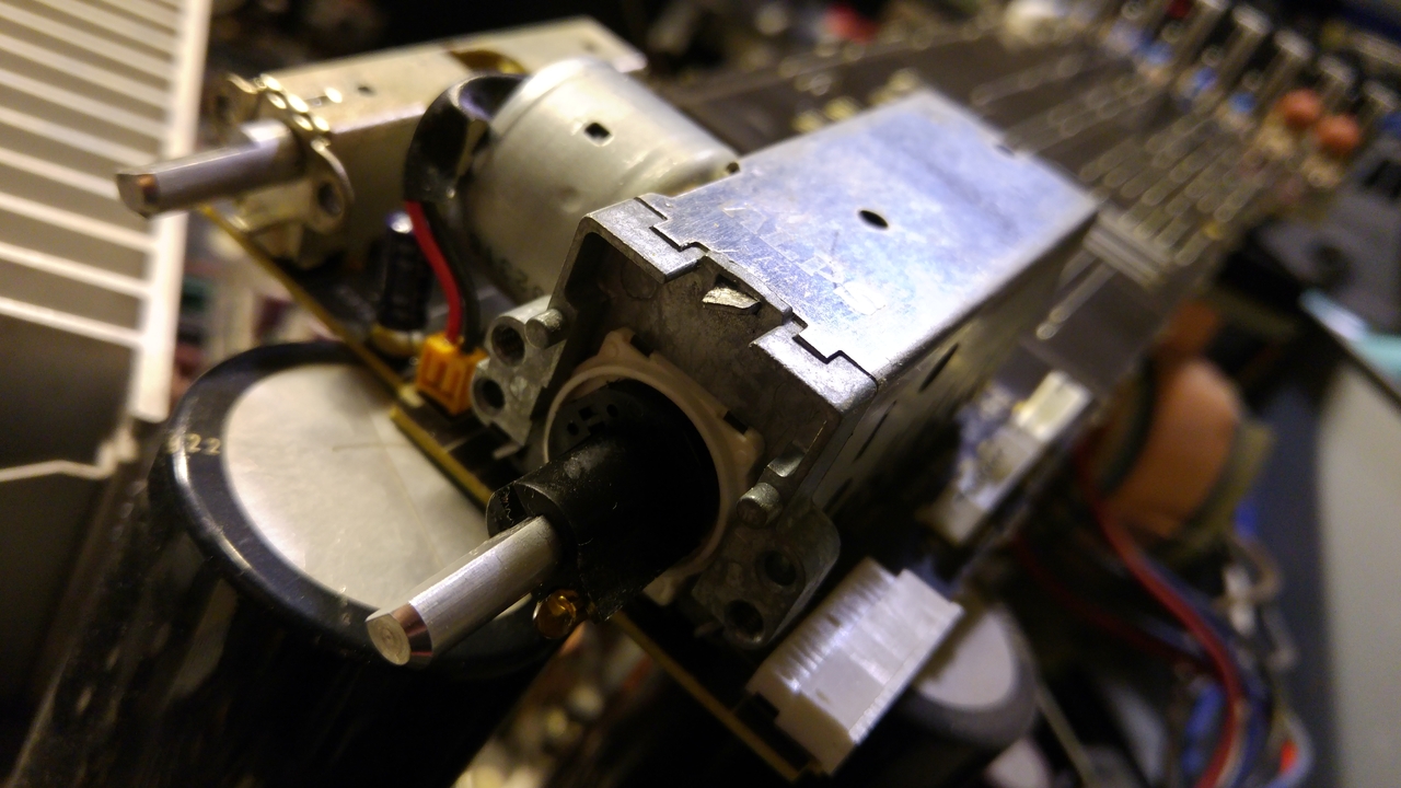

Sometime during the late 80's i bought a Yamaha AX-550 Stereo amplifier.
For about 15-20 years now it accompanies my computer and my turntable.

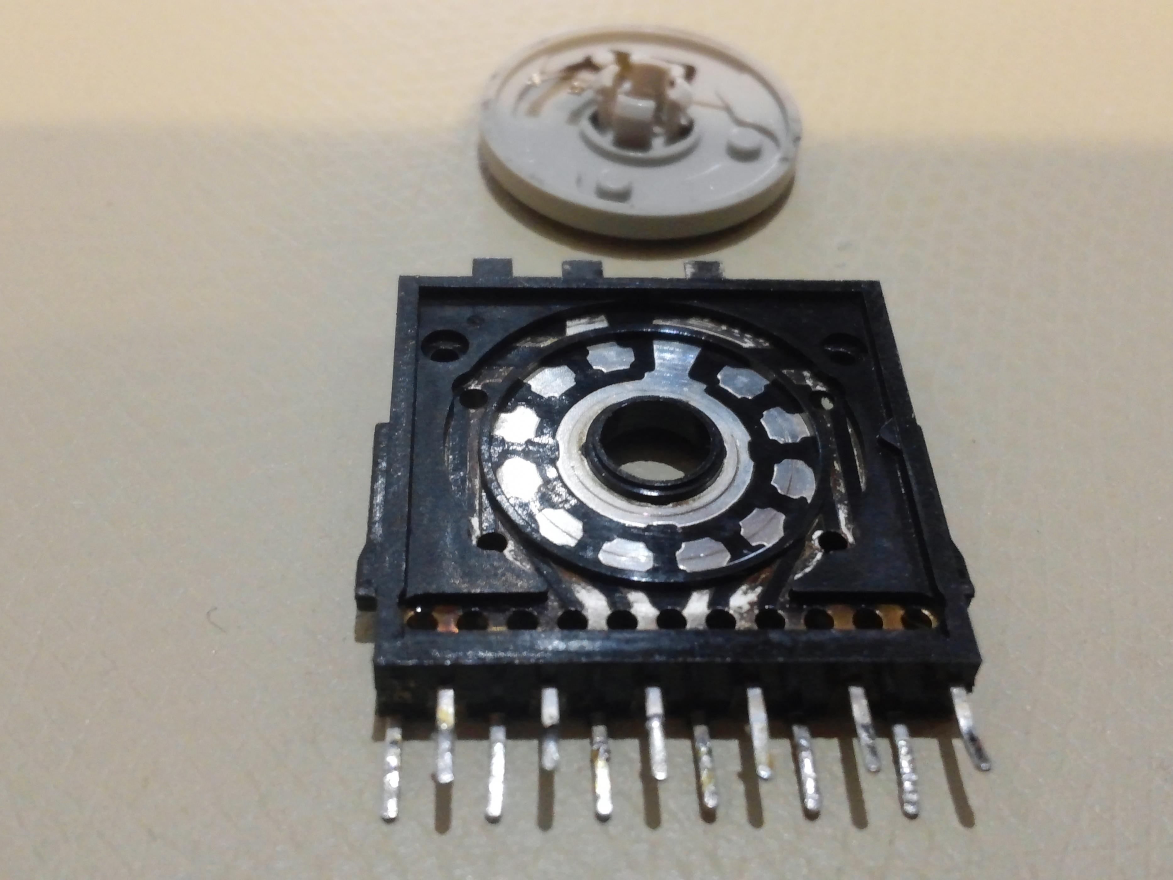

Since ages it has the expected ALPS input switch issues. Sometime long ago i opened the switch and i cleaned it with a contact cleaner spray with oil. It worked for sometime and although i didn't used it much the problems started again in all inputs making it... not really usable.
I also started to clean the wafer using a cheap fibreglass pencil. In the photos below the four wafer are visible with the top right cleaned with the "pen".
Then i changed my mind and decided that i didn't want it to fail after some time. Also i didn't want to go with hard gold plating of the wafers and the sliders.
A search for a replacement switch revealed a few things.
1) The specific switch will fail.
2) Yamaha (i don't know about other makers that were using the same part) sometime decided to use an improved part with gold contacts. The MTBF of that solution is unknown to me.
3) Both part are not available in the local Yamaha service center.
4) The "improved" input selector was found on-line but with a total cost of a bit over 80€ i thought that the price is too high.
So, i started to search what "other" input selector to buy, a cheap with 2-3€ or something better? It was clear from the beginning that there was going to be a no remote control selector. I don't mind, i don't even know where my original remote control is now.

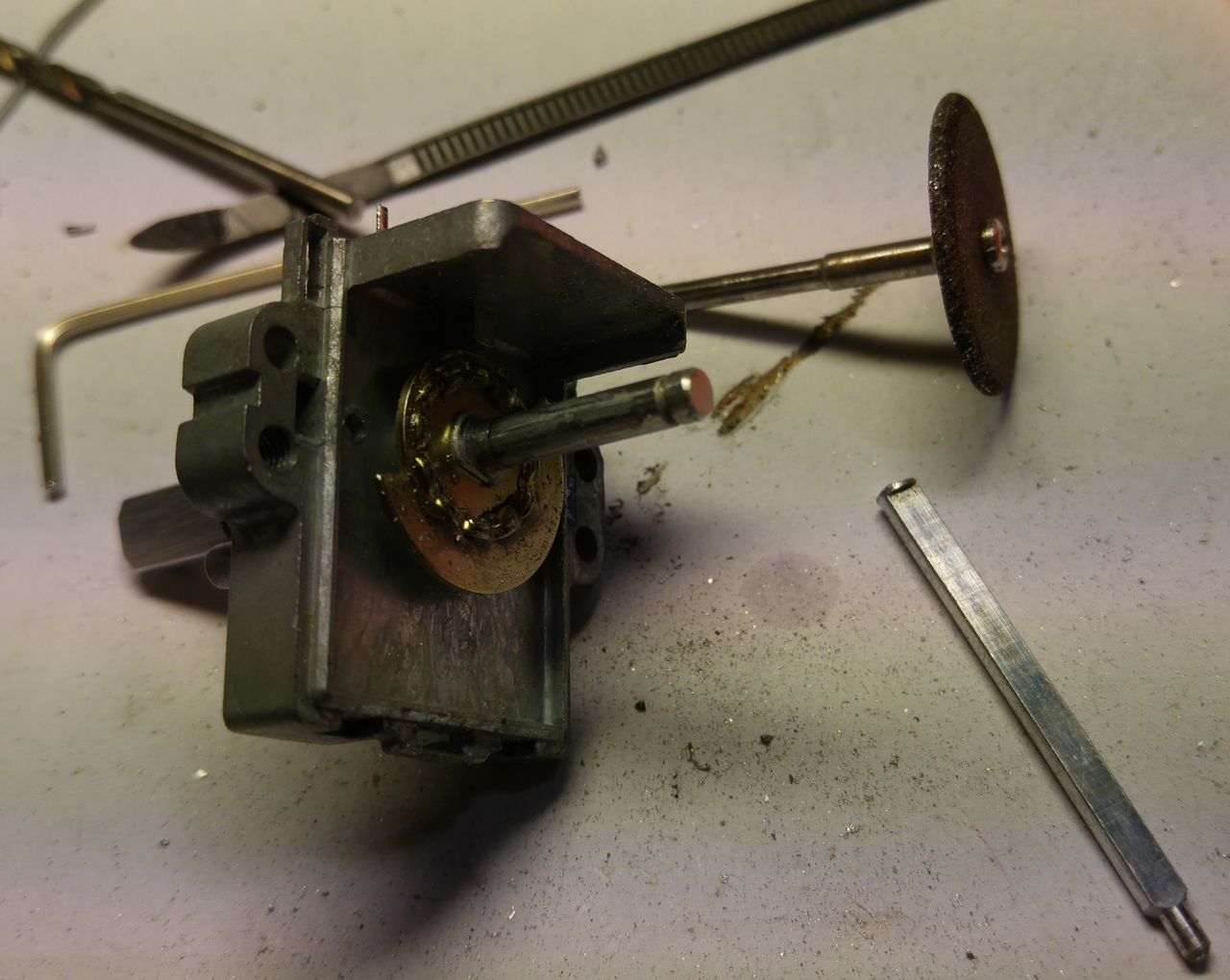

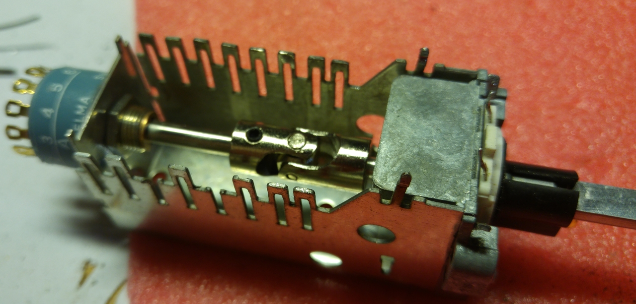

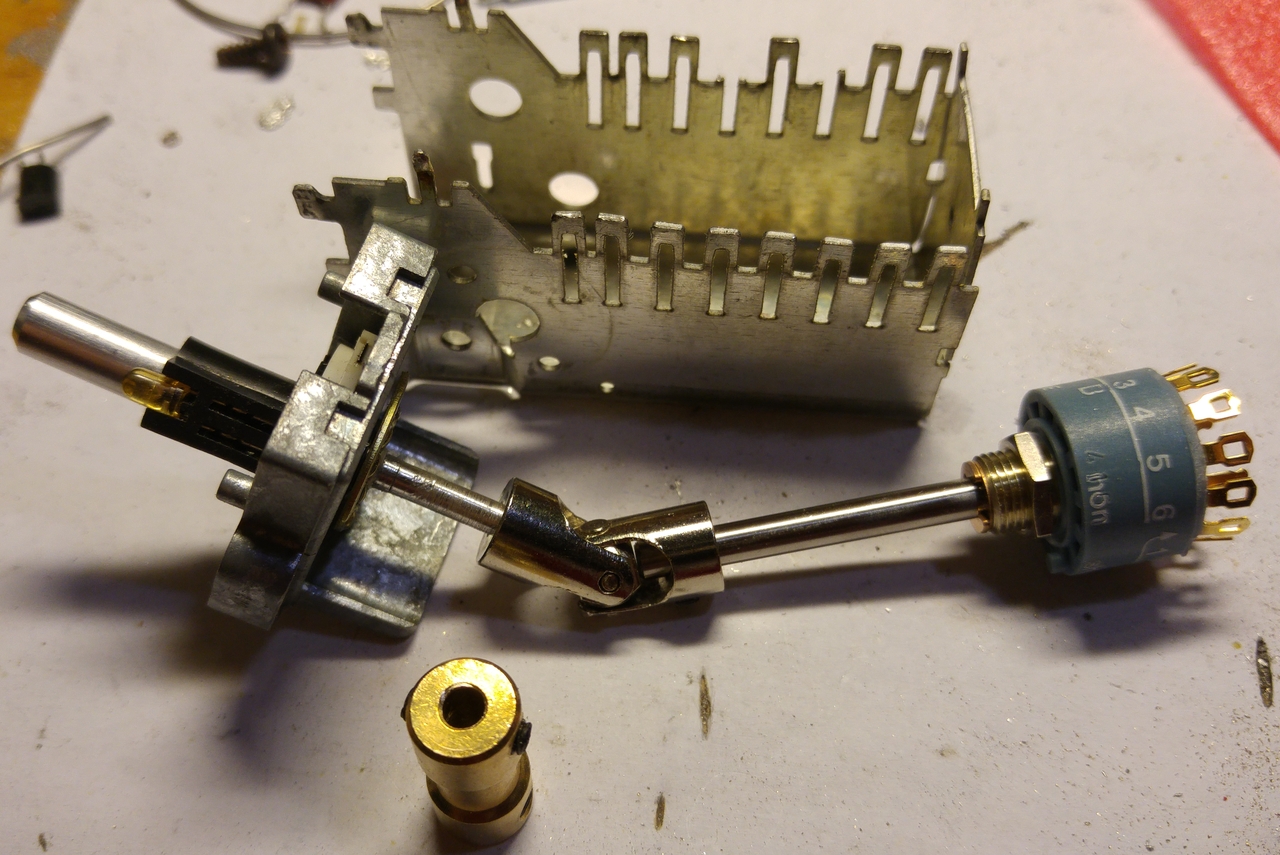

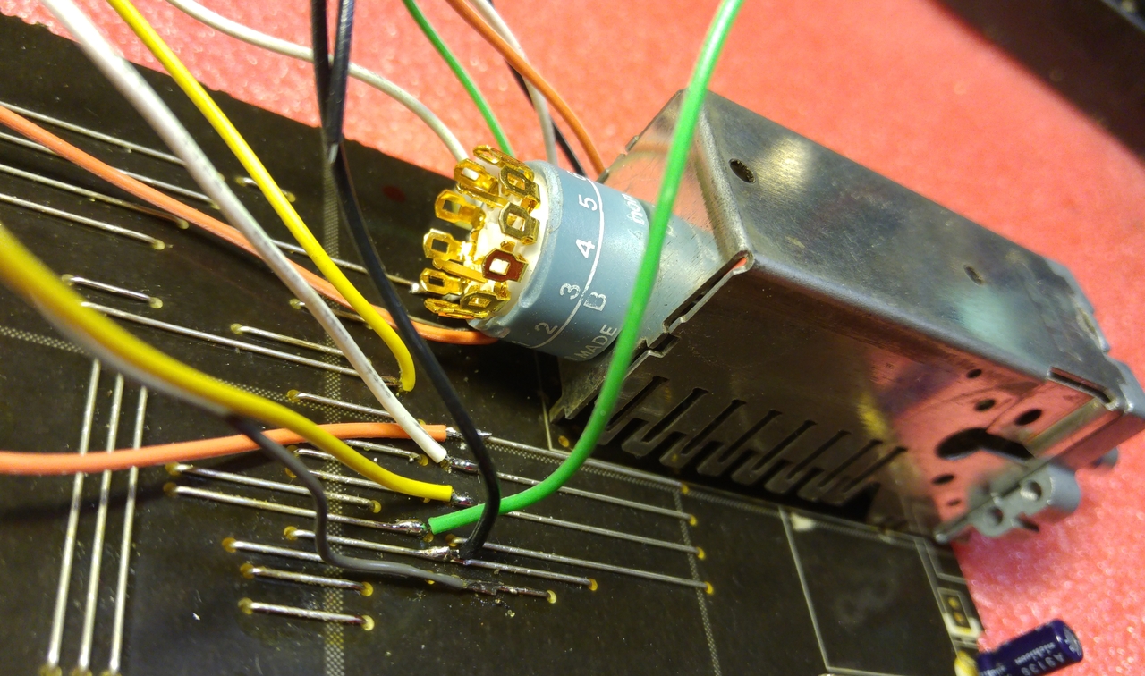

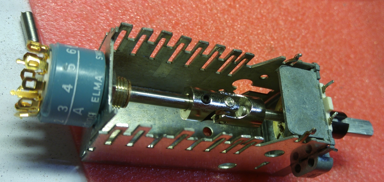

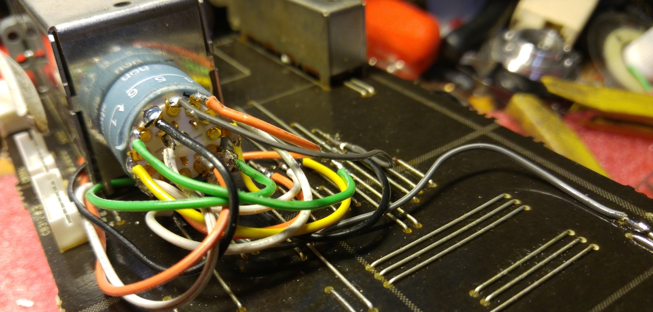

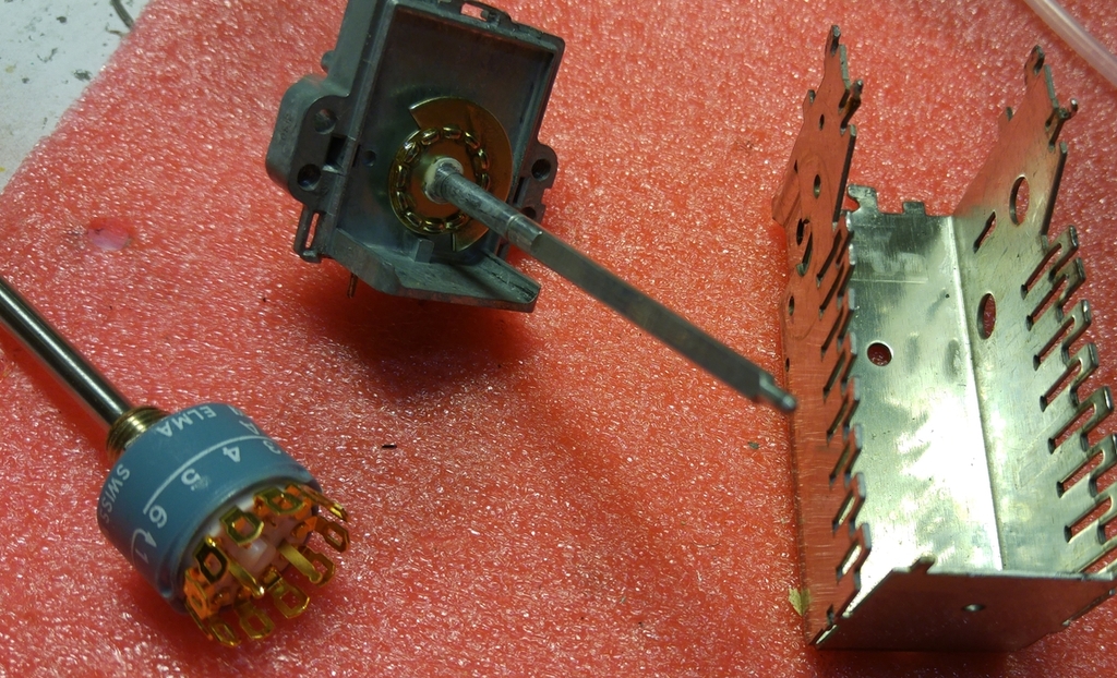

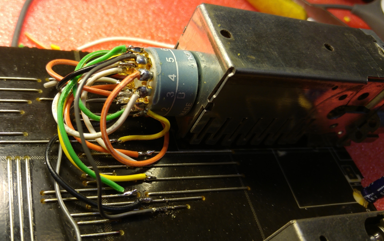

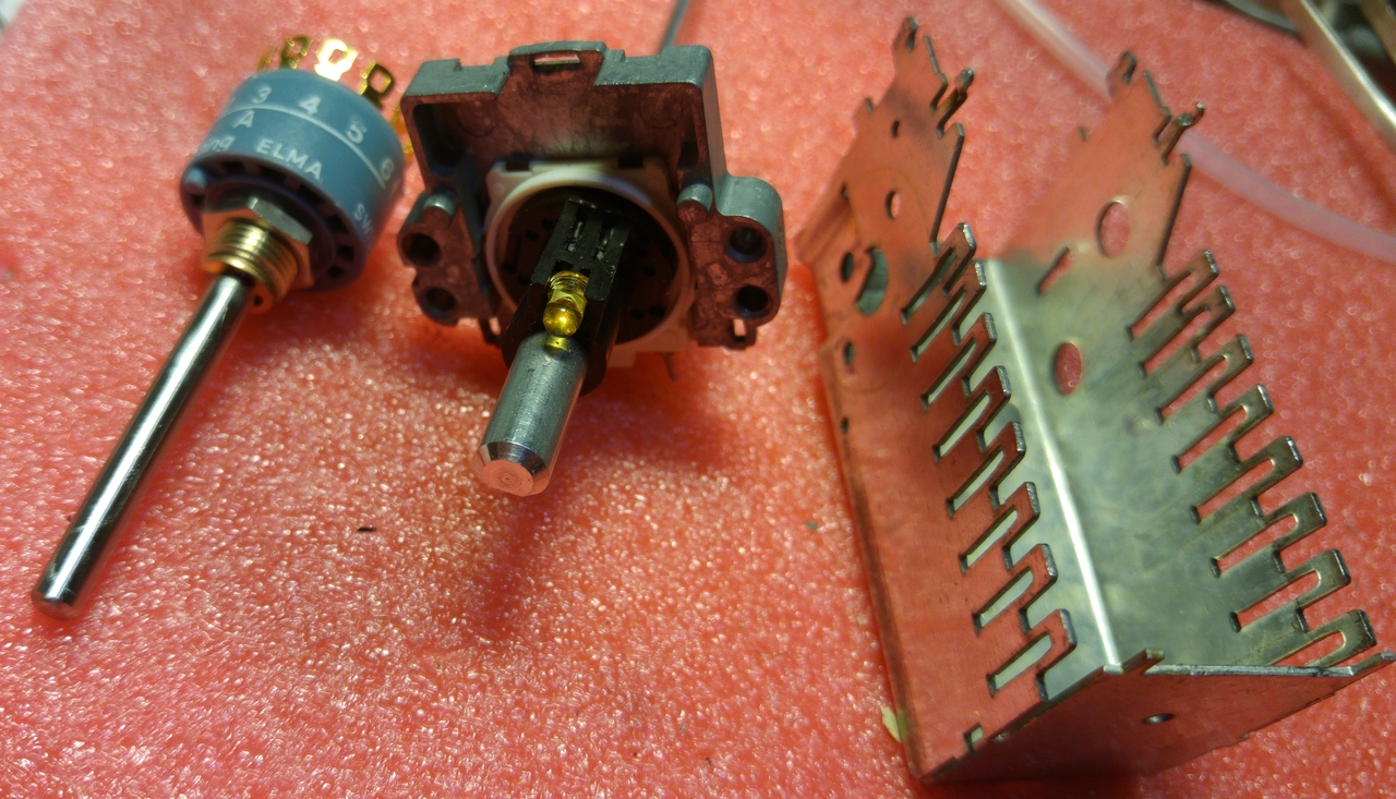

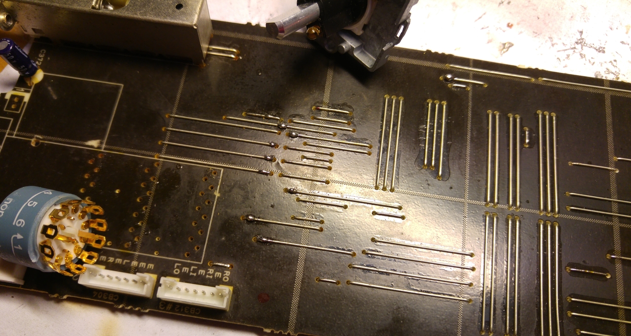

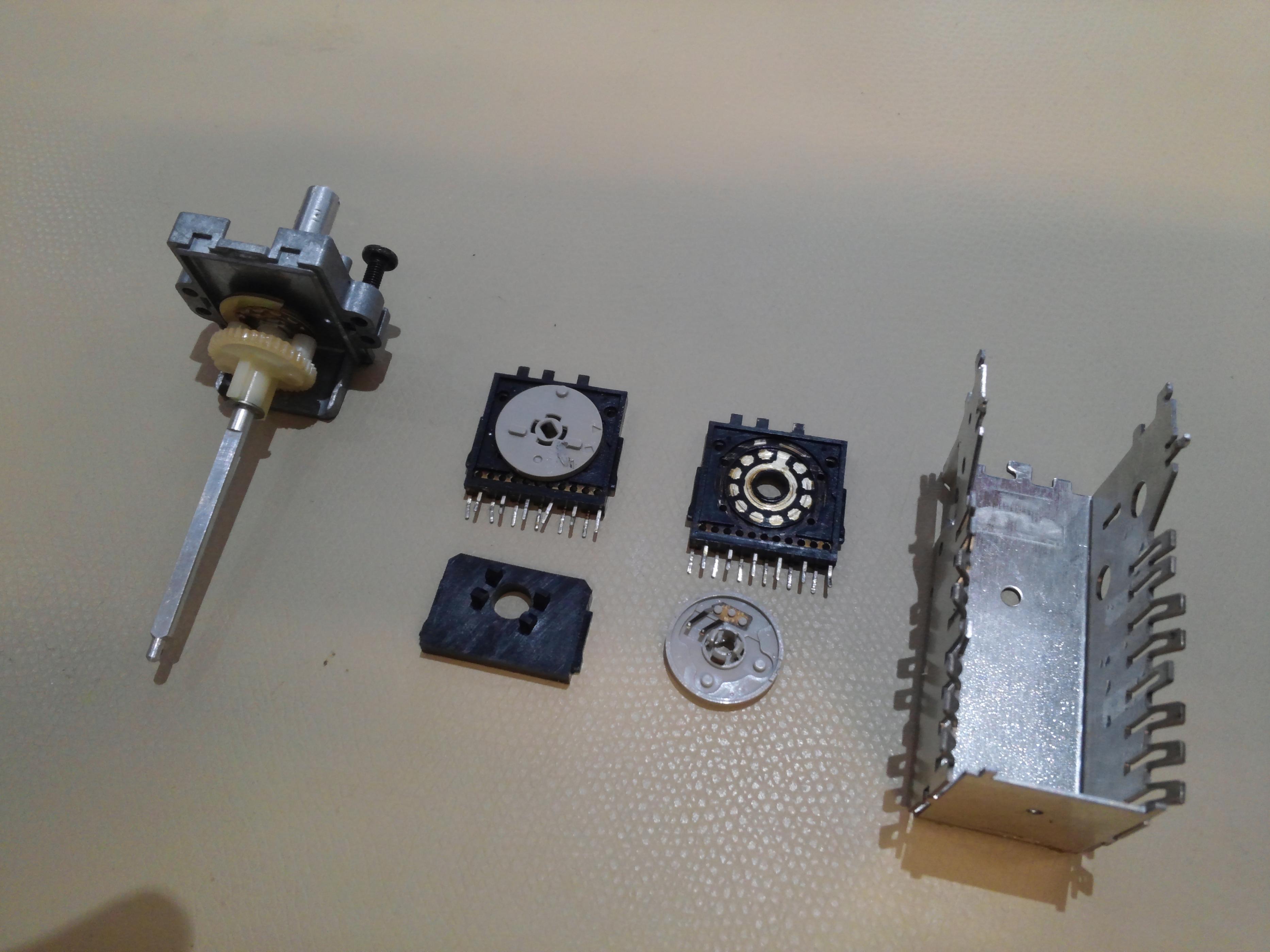

To make the story short, the original switch has four "wafers", one for each channel, one for current position feedback to the micro-controller and one more that i think is for a muting of the audio during intermediate positions of the switch. One more wafer -not really exposed- is in the front side of the switch that has the sliders that provide power to the led.

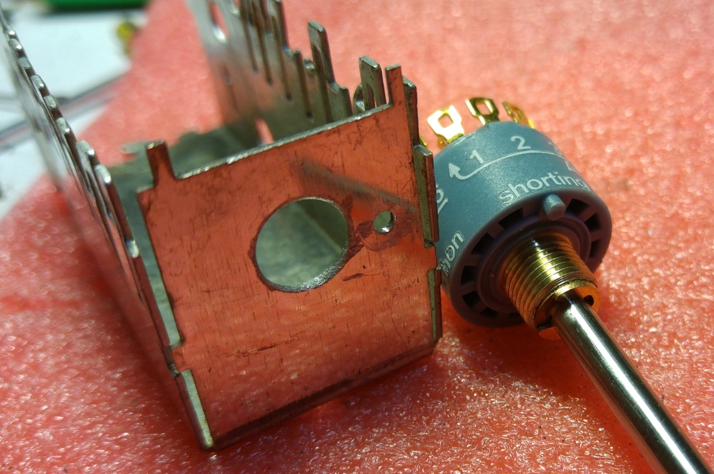

In any case i decided to buy an ELMA switch that can handle 6 stereo inputs (2pole/6 way) with 30degrees step and is of a non shorting type, meaning that it first disconnects from an input and than makes connection the the neighbouring input while you are turning the knob. The price was about 30-32€ and as i bought some other parts the shipping didn't increased my total cost.
I didn't found a switch with the proper shaft type (D) that could accommodate the original Yamaha knob and even the switch i selected has a smaller diameter (3mm).
The good thing is that the solution to that problem was even better that i thought as i ended up maintaining the led indicator on the knob working.
The exact type of the switch doesn't really matter as the solution can be implemented with other types.

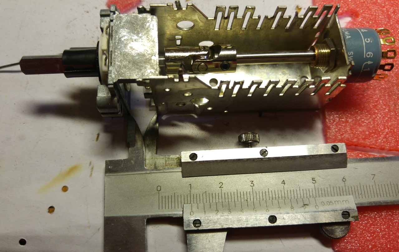

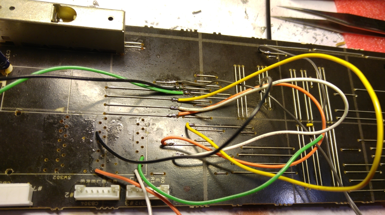

I will try to describe below what i did and then have the photos below continuing with a next post if necessary.
I had to increase the diameter of the hole in the rear side of the original switch where the original shaft was terminating making it large enough to fit the new switch.
A new small hole was needed to keep the switch from turning. That should make the shaft of the new switch concentric with the "shortened" shaft of the original ALPS switch.
There are two ways to join the two shafts together using couplers used in robotics projects and they are cheap. I preferred the one that could "forgive" differences of concentricity of the shaft axles from the simple copper coupler at the bottom of the respective photo. Have in mind that i used couplers for a 3mm and a 4mm shafts. they are available for a range of shaft diameters.
I made an estimation and i cut the ALPS shaft, then i measured how much i have to cut the shaft of the new switch and i did it in a few steps. The reason is that the shaft of the new switch happened to be made of steel and cutting it with the dremel was increasing the temperature of the shaft so i had to hold it firmly with pliers while cutting and give it some time to cool down in order not to melt any plastic part inside the main switch body.

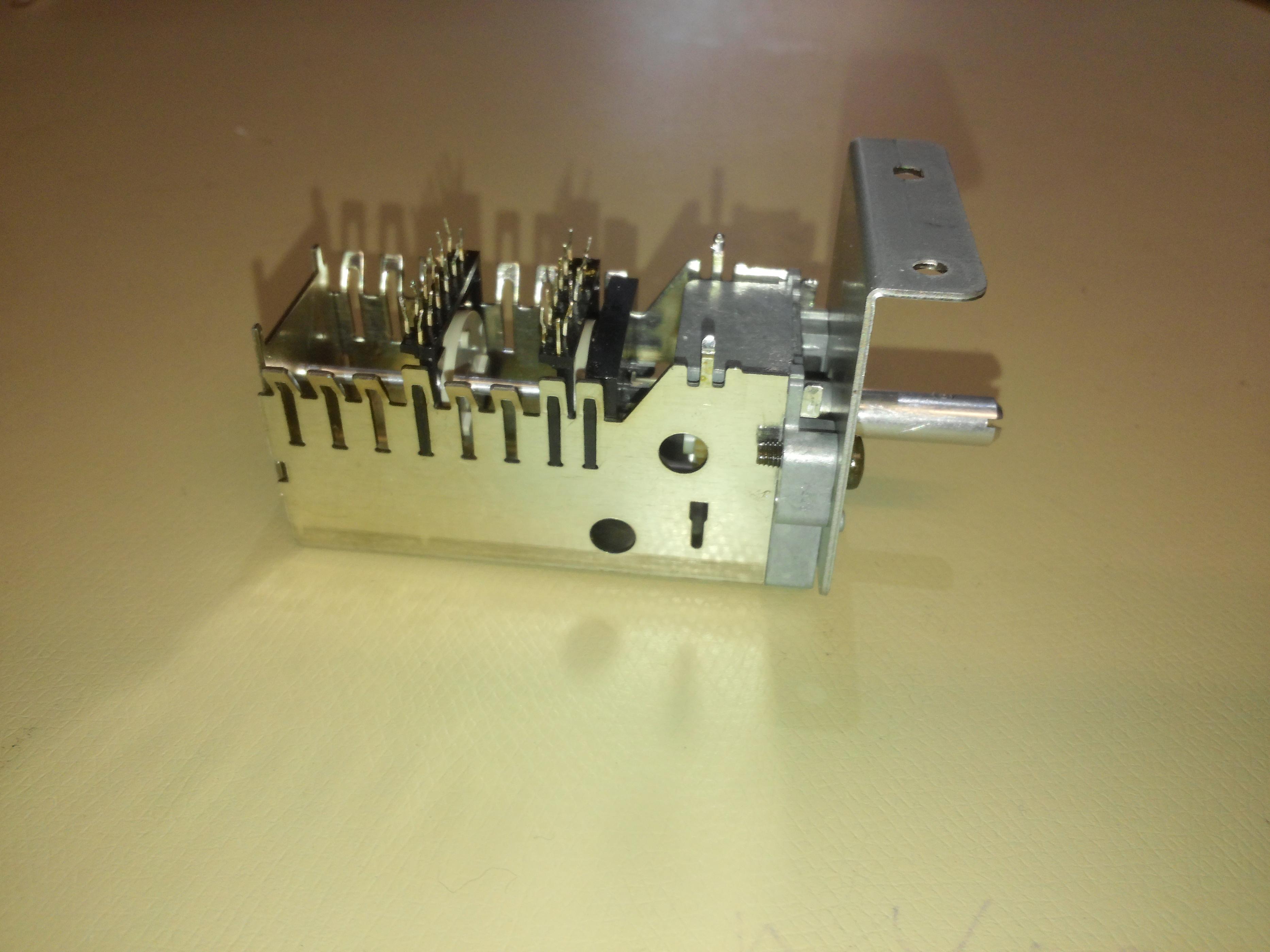

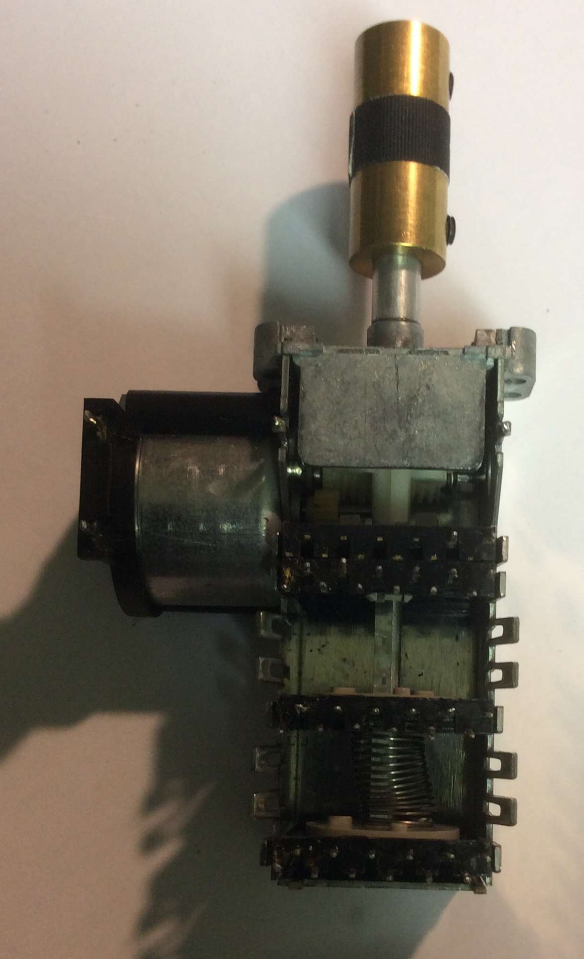

Assembling of the parts is easy and it worked very well for me. I also oiled a bit the join of the coupler.
Then as the completed switch body was covering the connection points on the pcb i used other connection position that i had easily found using the DMM with a help of the service manual.
As the pcb is single sided it has several wire jumpers that most of them can be used as they carry the proper input signals. In total we need 14 connections, 12 for the 6 stereo inputs and two for the outputs. For about 4 connections i used the original holes under the switch body, for the rest i soldered a blob on the proper jumper wires. I didn't want to use long wire lengths and also some of the original soldering point under the pcb was destroyed after the second removal of the switch after first cleaning attempt.
In the photos there are a couple of L/R mixups with the wires connected as i was not careful enough during the wire identification during the soldering.
After one week of the above i can say that my amp works perfect. Of course the job can be done in a better was using a different switch with two wafer that probably has less crosstalk (not that i tested/noticed a difference) between the channels or using better/shorter connection wires.
Continuing in the next post with the remaining photos.....
