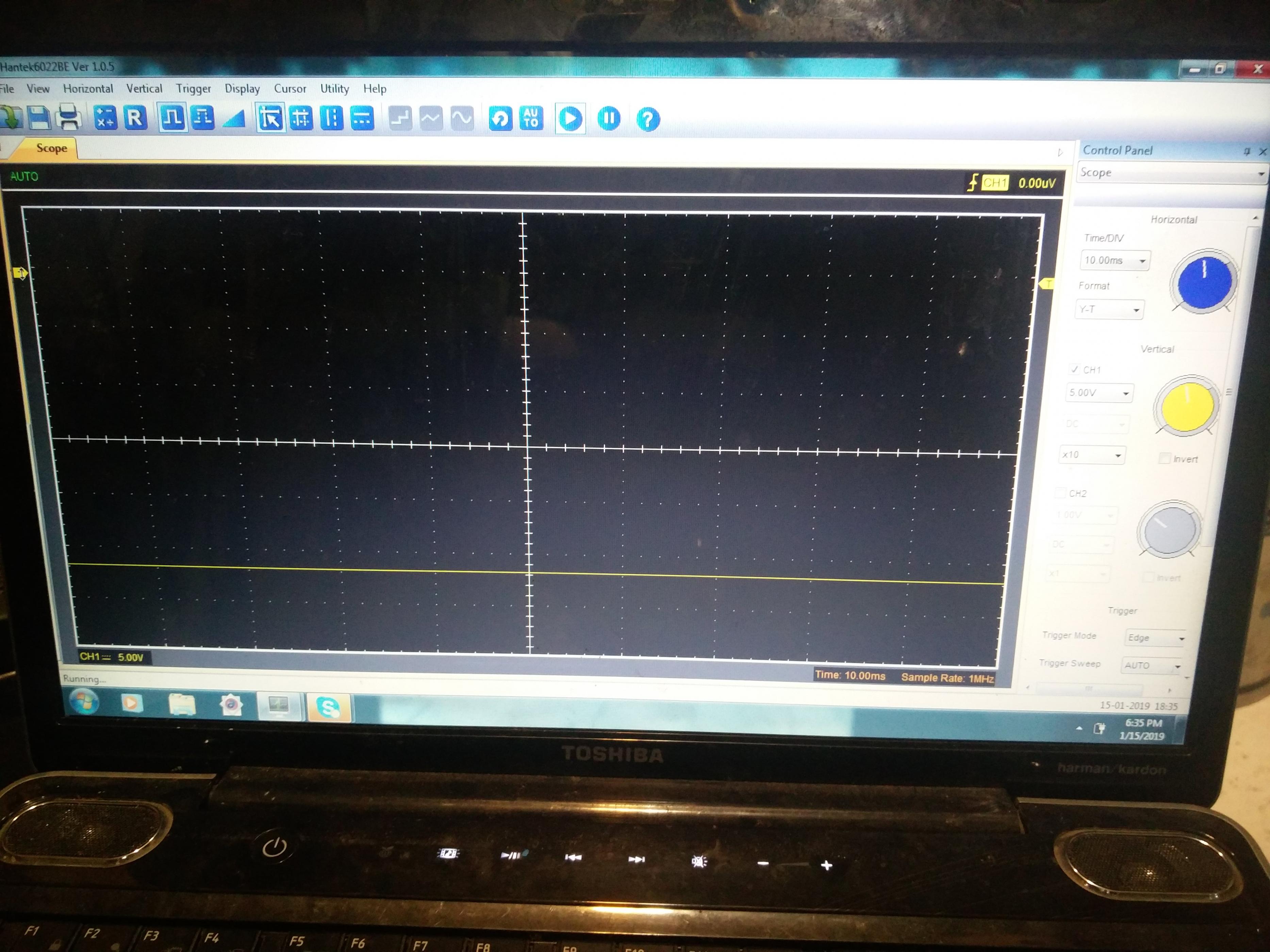

The collector of Q9701 is connected to Pin1 of IC9702 through a 10k resistor. Whatever signal I connect to the collector of Q9701 gets pulled down to a straight line on the scope.

Do you have a series resistor? If so, does the signal get pulled down on both sides of the resistor?
Remember, everything beyond the transistor Q9701 is referenced to the negative rail. (don't ground your scope to the negative rail). That's one reason that you need the capacitor.

The scope is set at 10ms / 5v.

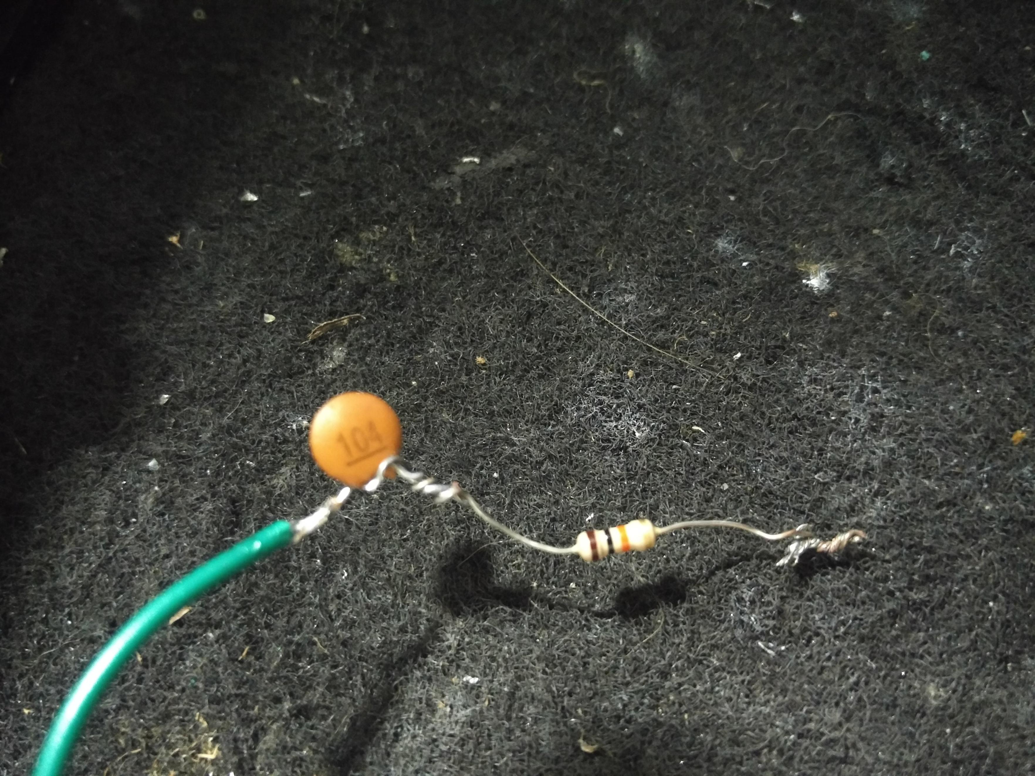

Not sure if I am feeding the signal properly or using the components properly. There is a pic of the capacitor and resistor that I am using. A 10k is pictured but I tried a 1k also with no difference. The signal gets pulled down on both sides of the resistor, but only the amplifier side of the capacitor.
The pics below illustrate what is happening.
The second pic is of the signal after the resistor and capacitor but not connected to the amp yet.
The third pic is what happens to the signal as soon as I connect the signal to the collector pad of Q9701.
The first pic is the capacitor and resistor that I am using.
If they drive headphones, they can drive 10k. I don't know why you get no signal on the collector of Q9701. Is this with or without the jumper to pin 6 of the inverter?
The collector should be near the negative rail. The IC it's driving is powered by 10v referenced to the negative rail.

The signal disappears on both sides of the resistor, but only the amplifier side of the capacitor.
Are you sure that the capacitor is good and has a good connection to the resistor?
The capacitive reactance is less than 100 ohms at 20k and the signal should not drop to nothing when driving a resistor 1k ohms or greater.
Tried a different capacitor and a 1k resistor, same thing is happening. Is there something else I can do to feed the signal into the amp?
