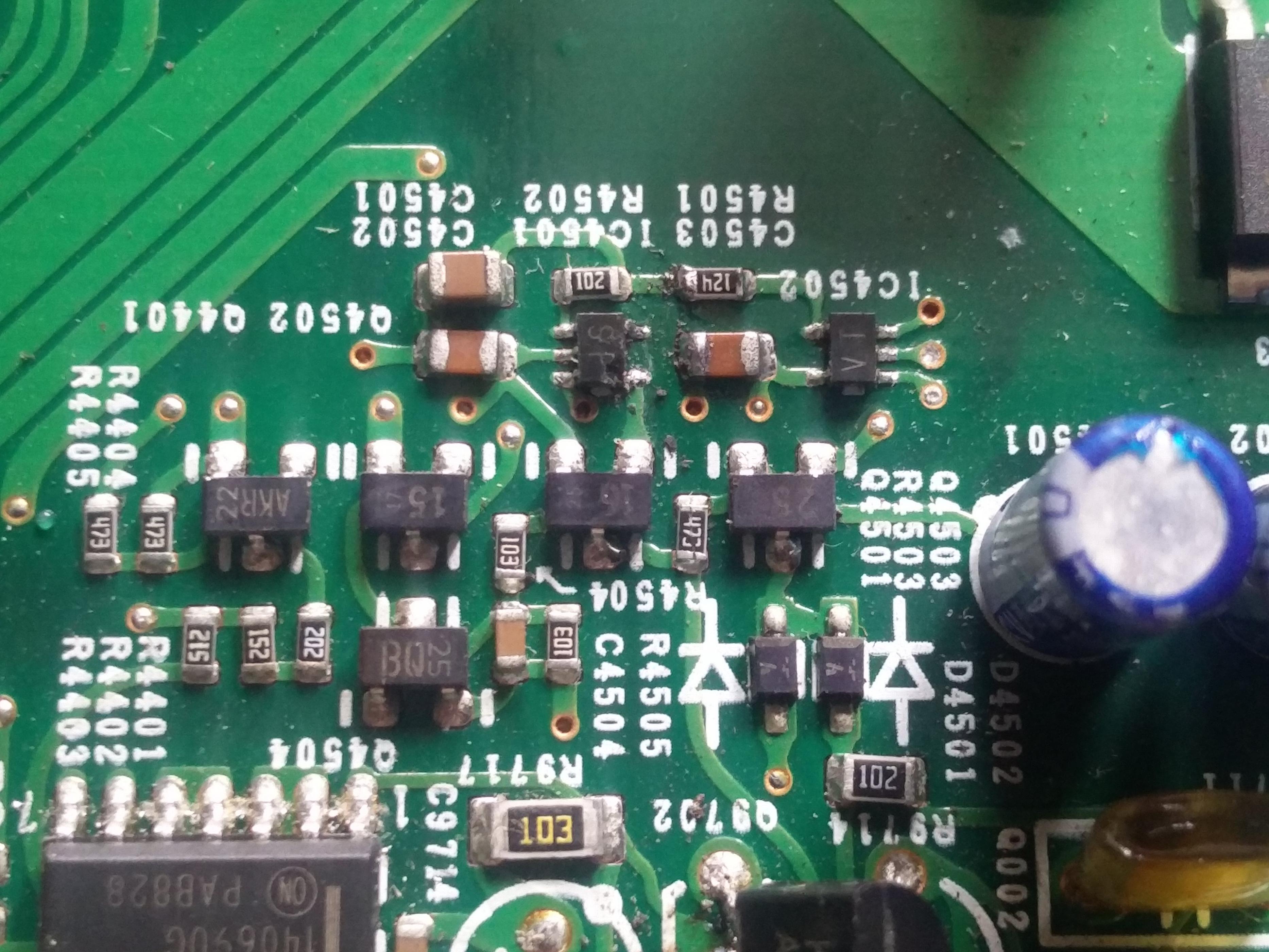

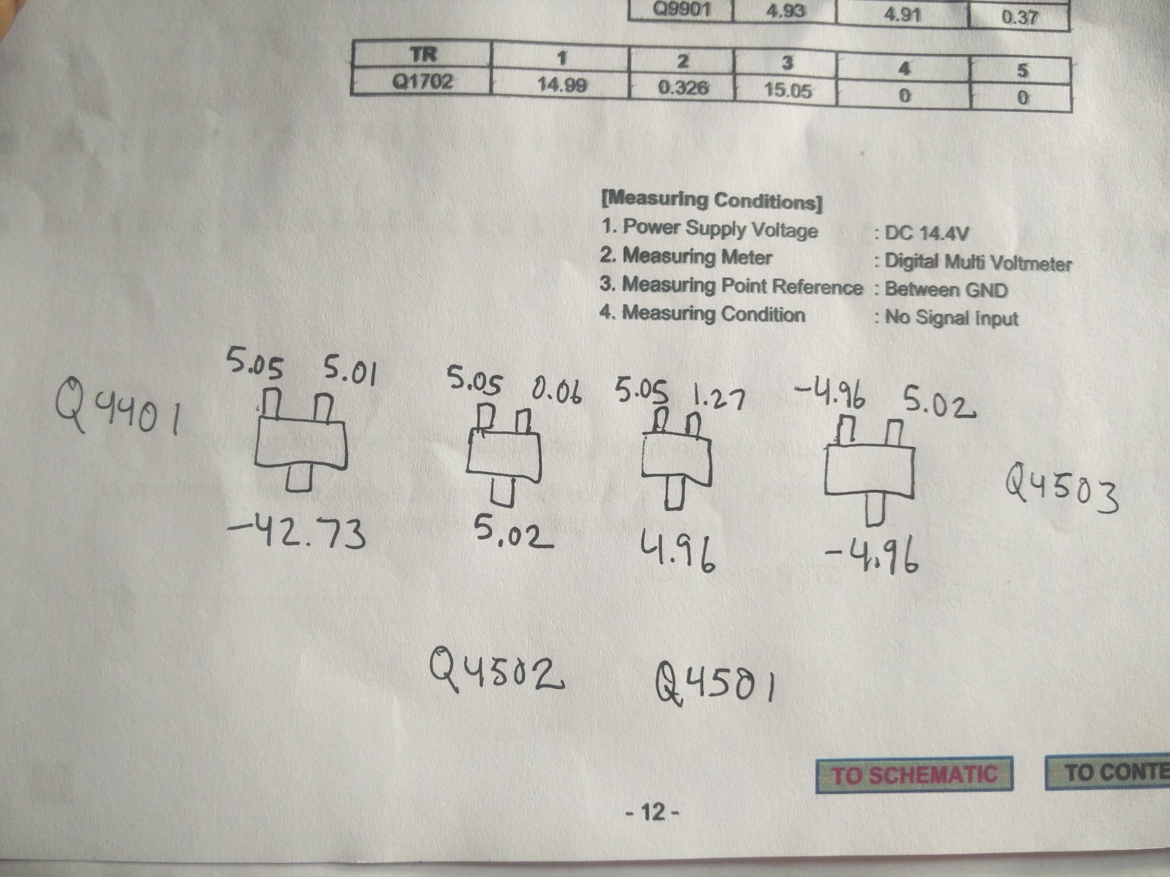

Some more off readings from Q4401, Q4501, Q4502, Q4503.
-42.73 on collector of Q4401 (s.m. says -4.95)
5.02 on collector of Q4502 (s.m. says - 4.95)
1.27 on base of Q4501 (s.m. says 0)
5.02 on base of Q4503 (s.m says - 4.95)
-4.95 on collector of Q4503 (s.m. says -)
