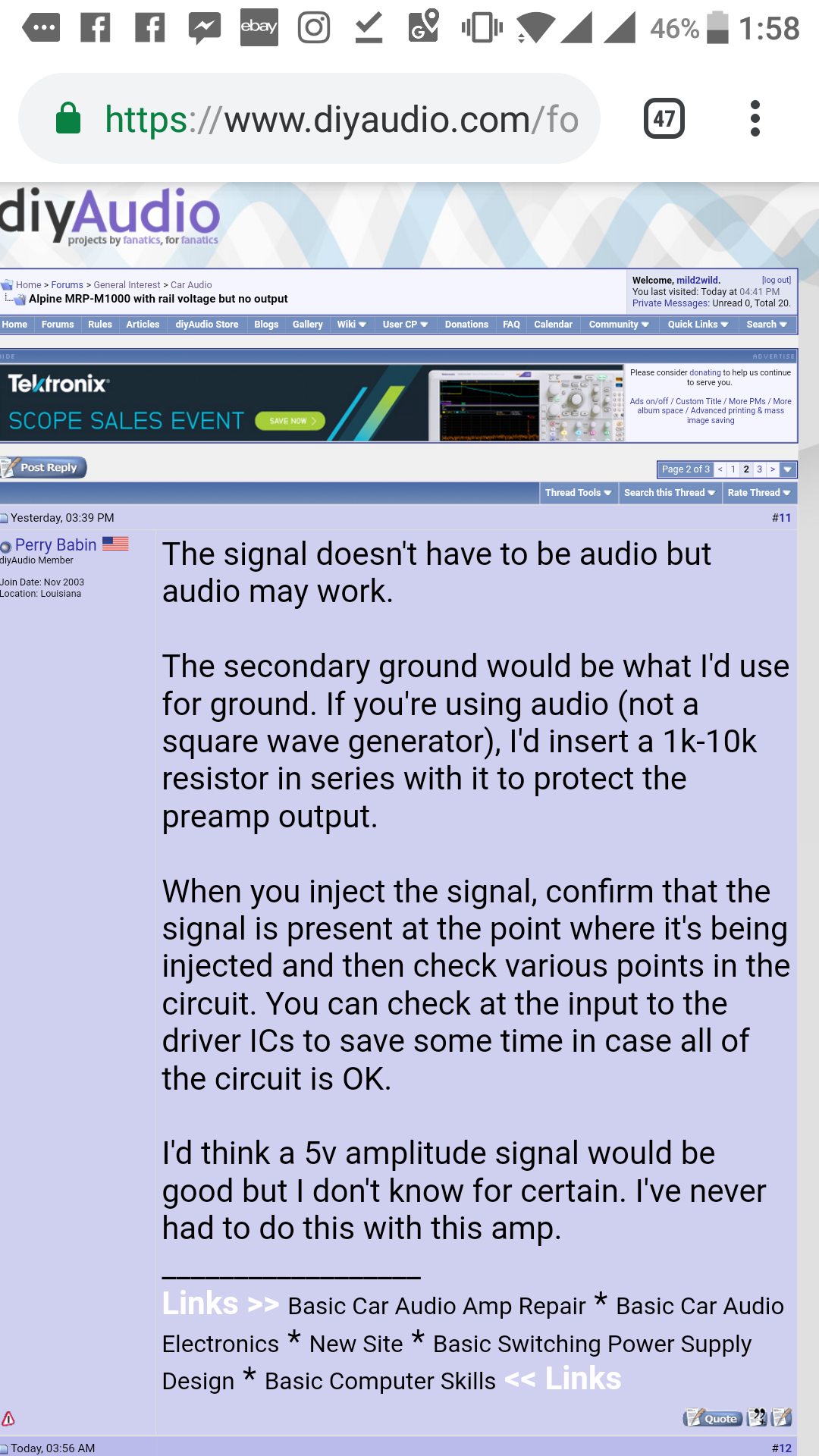

Can you please explain post #11 for me, you said to connect through a 1k-10k resistor. I may have misunderstood.
Can you please give a detailed description of how to inject the audio into the amp using an aftermarket deck playing a music CD?
I don't have a signal generator, other than a square wave terminal on my USB scope designed for probe adjustment. I have test tones on my ipod also...
The output of the signal would connect through a resistor, not the ground side.
What were you using before as a signal source?

I was thinking that the clamping transistors were SMD since that's mainly what alpine uses (and they're epoxied down to the board). If they're through-hole, remove them. That should let the signal from the audio input pass.

I am using a car deck playing an audio CD. I am still unsure of how to inject the rca jack signal to the amp. Please specify.
Do I remove Q9701 and Q9702? Then the RCA male center pin goes to the collector pad of Q9701 and Q9702 through a 1k resistor, and the rca ground connects directly to the secondary ground of the amp?

If you remove 9701/2, the signal that you saw before the op-amp (when drivign signal into the RCA jacks of the amp) may pass through. It's also possible that the DC on the op-amp will hamper the signal passing. Try removing those transistors first to see if audio will pass.
Still testing using the voltmeter at the moment. I removed Q9701 and Q9702 and fed signal to the collector pads through a 1k resistor. I connected the rca shield to the secondary ground. I got audio on Pins12 and 14 of the IR2010S ICs. I had high side gate drive (Pin1) on both IC9801 and IC9802, but only low side gate drive (Pin8) on IC9802, no gate drive signal on IC9801. At some point the low side output of IC9802 also stopped working.
