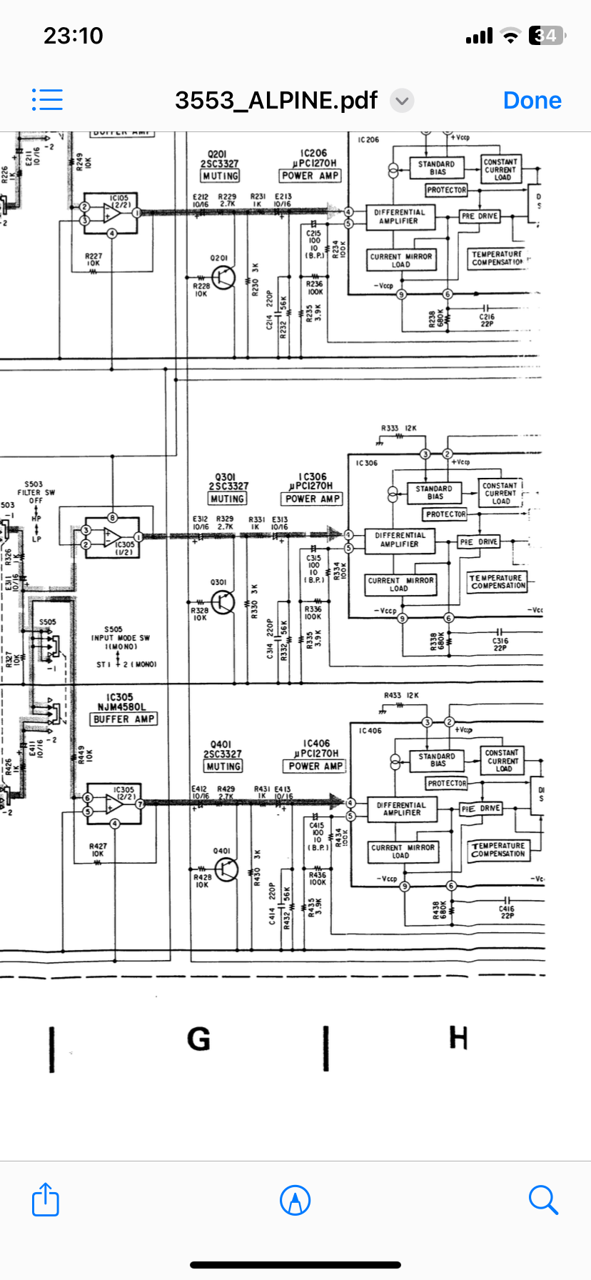

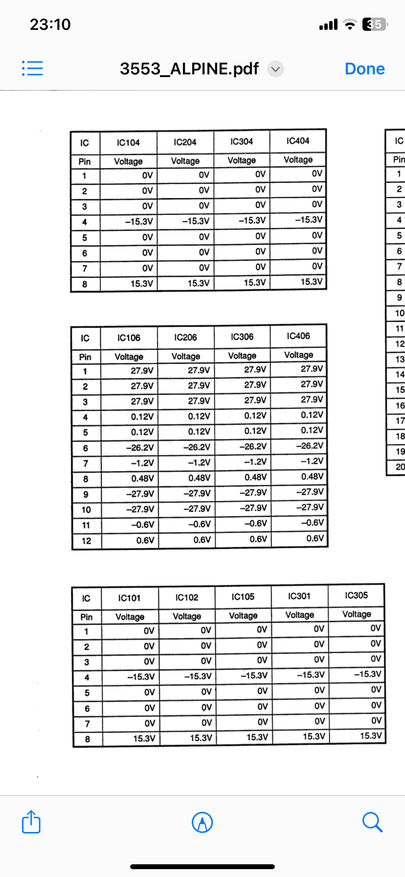

It does not move the membrane of the speaker at power on/off. It is silent. One thing that it’s not related , my DSP starts when it sense an dc offset rise from the player, and when I unlock the car or open a door it tried to start 3 Seconds and then it shut down, it does not start the amps, can I put a cap or something to filter that residual ?!It is wired from a channel , player speaker output to DSP high-level , just so I can trigger a remote.
Sorry to revive the thread . Assuming that output drivers are the uPC1270 ones, in the manual pin 4 and 5 are 0.12V . And that is what i read on speaker terminals. So it could be this high dc offset from factory?
