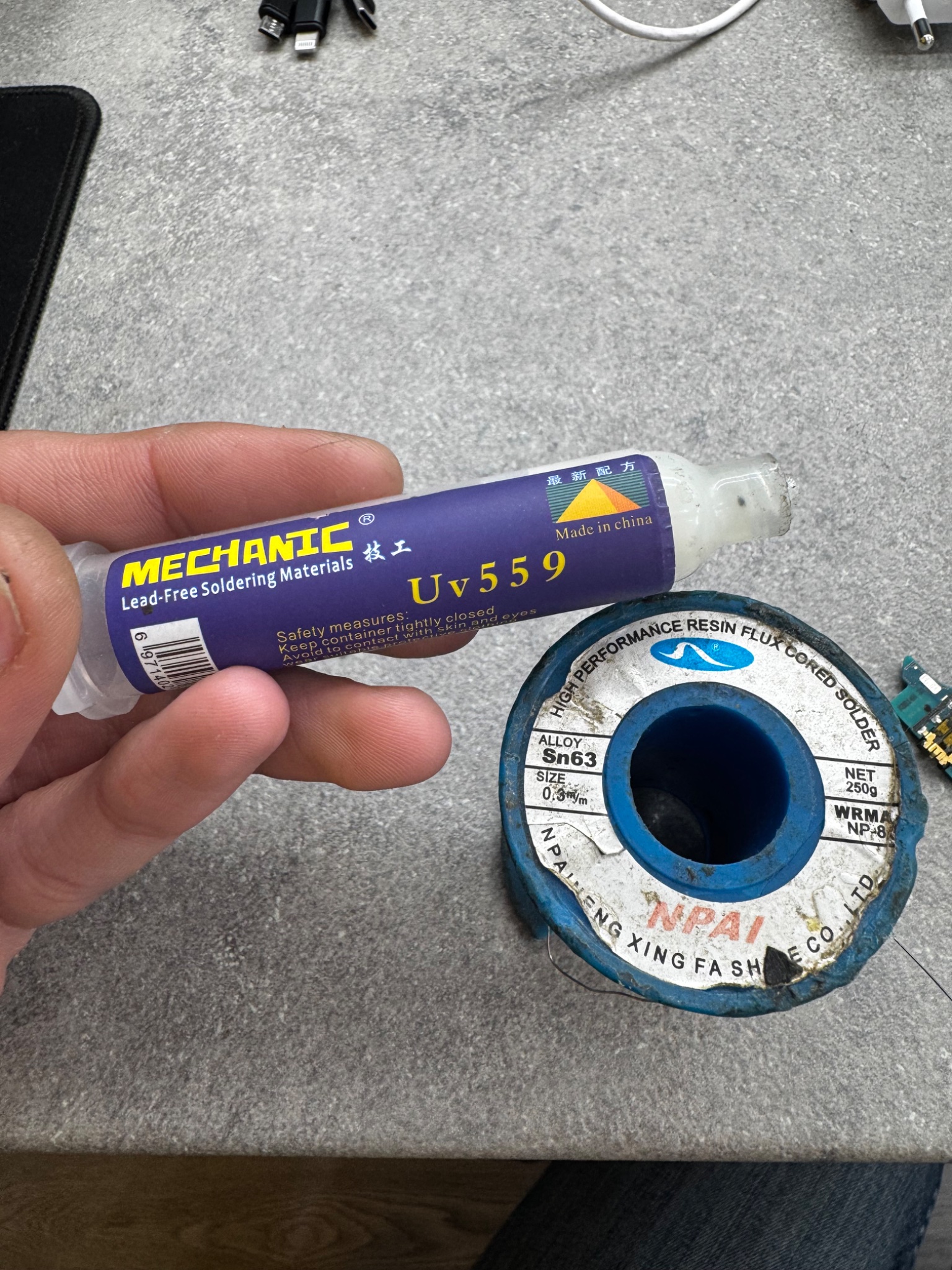

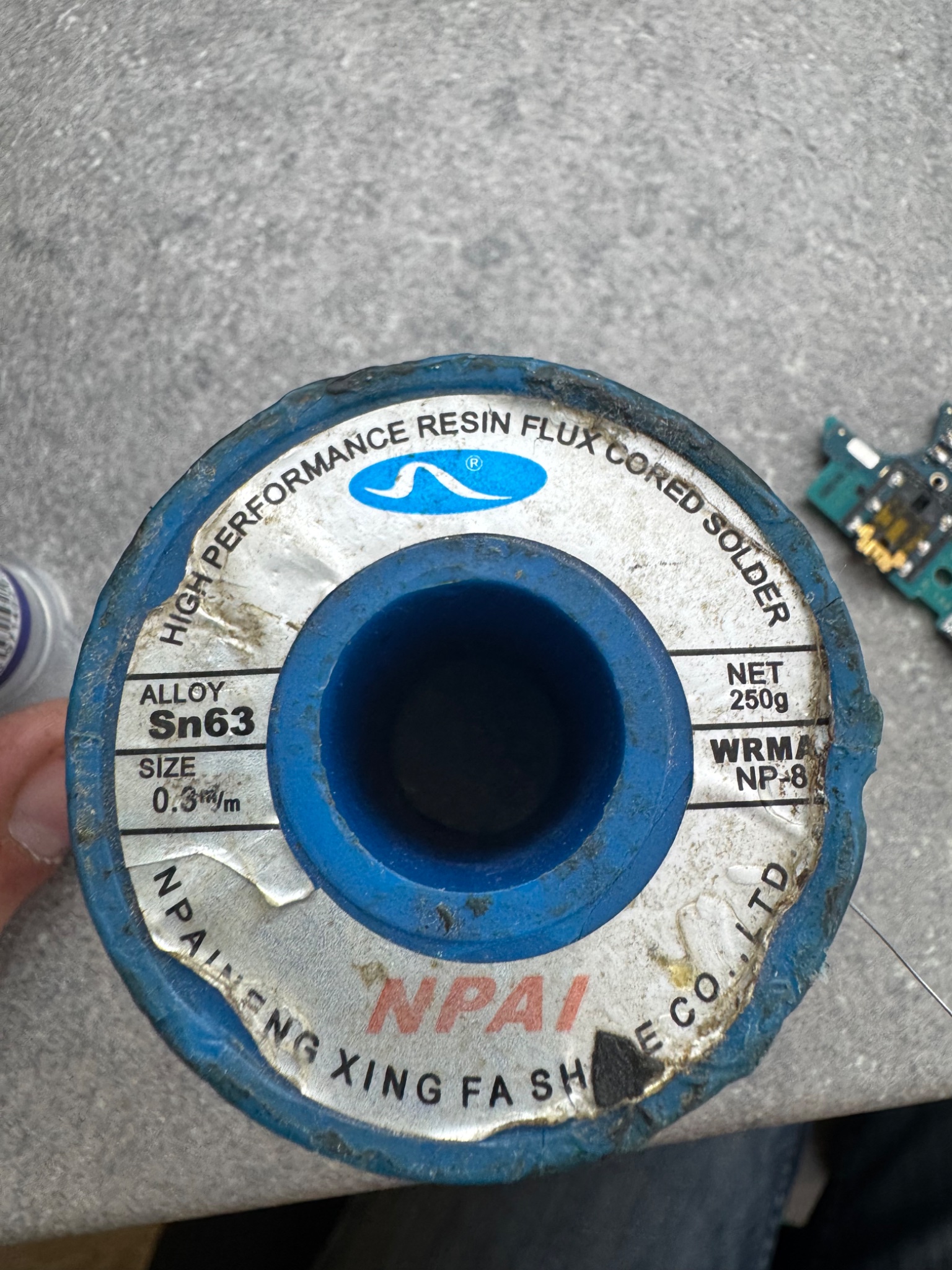

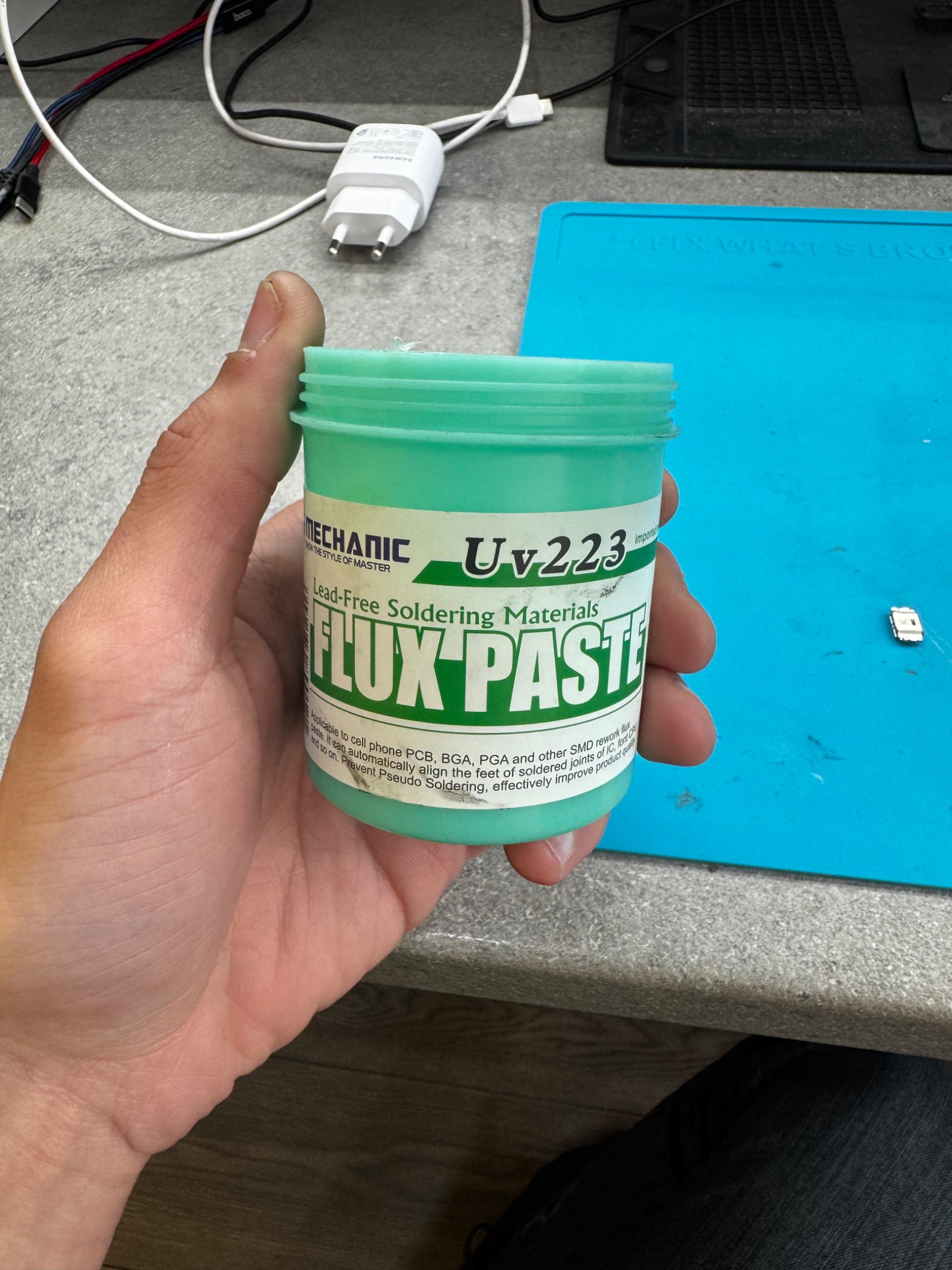

Those are likely OK but I've never seen the brands. What are you using to desolder? You need to remove all of the old solder before you resolder the connections.
Rework the solder connections on the regulator components and see if anything changes.
