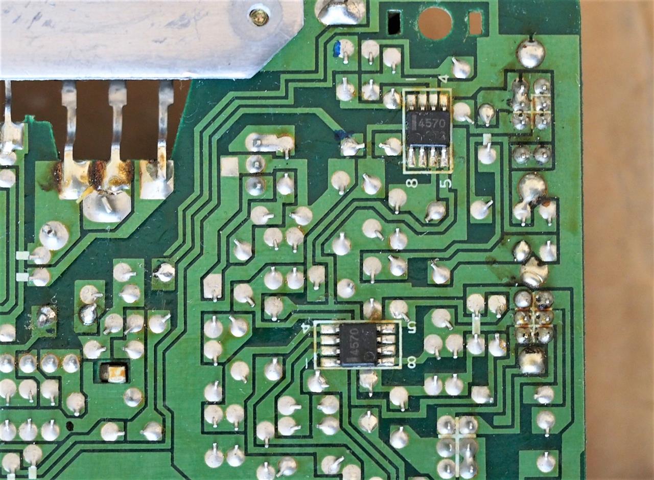

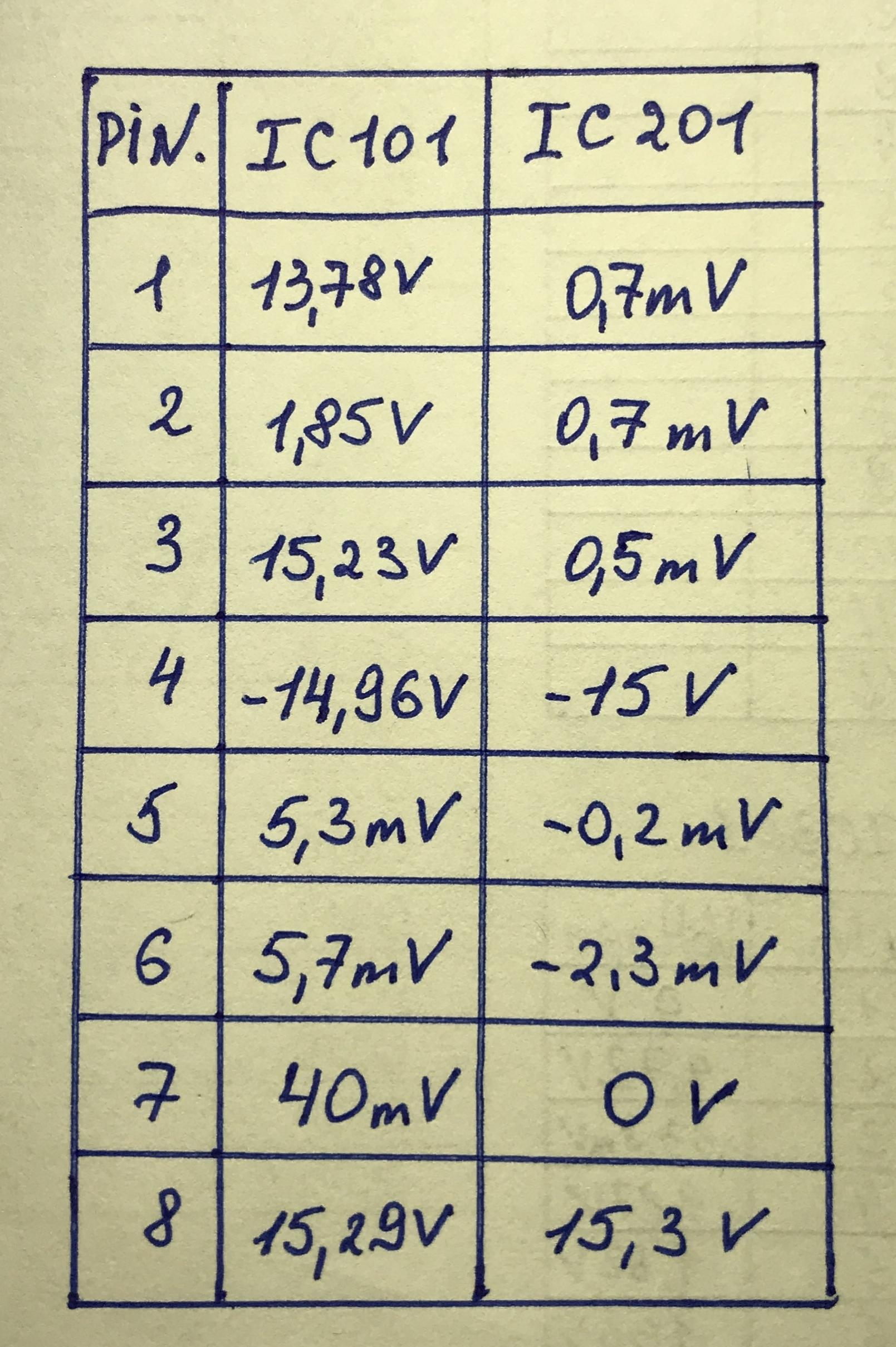

I found a faulty resistor in the -15 volt R328 power supply circuit, after replacing it, the sound appeared in both channels. But I am confused by the voltages on IC101 and IC201, they differ from those indicated in the service manual. Here's what I measured:
IC101
1. 15,15 V
2. 47 mV
3. 5,4 mV
4. 5,2 mV
5. -14,9 V
6. 15,2 V
7. 1,85 V
8. 13,85 V
IC201
1. 15,25 V
2. 0 V
3. 0 V
4. 0 V
5. -15 V
6. 0,5 mV
7. 0,2 mV
8. 0,7 mV
On the rest of the microcircuits, the voltage is normal. It is also necessary to measure the voltage across the transistors according to the service manual.

You have the pin configuration wrong. Repost the numbers.
https://datasheet.octopart.com/UPC4570G2-E1-A-Renesas-datasheet-138184105.pdf
That's the first time that I've seen that sort of error but looking at the diagram again, I can see what you did.

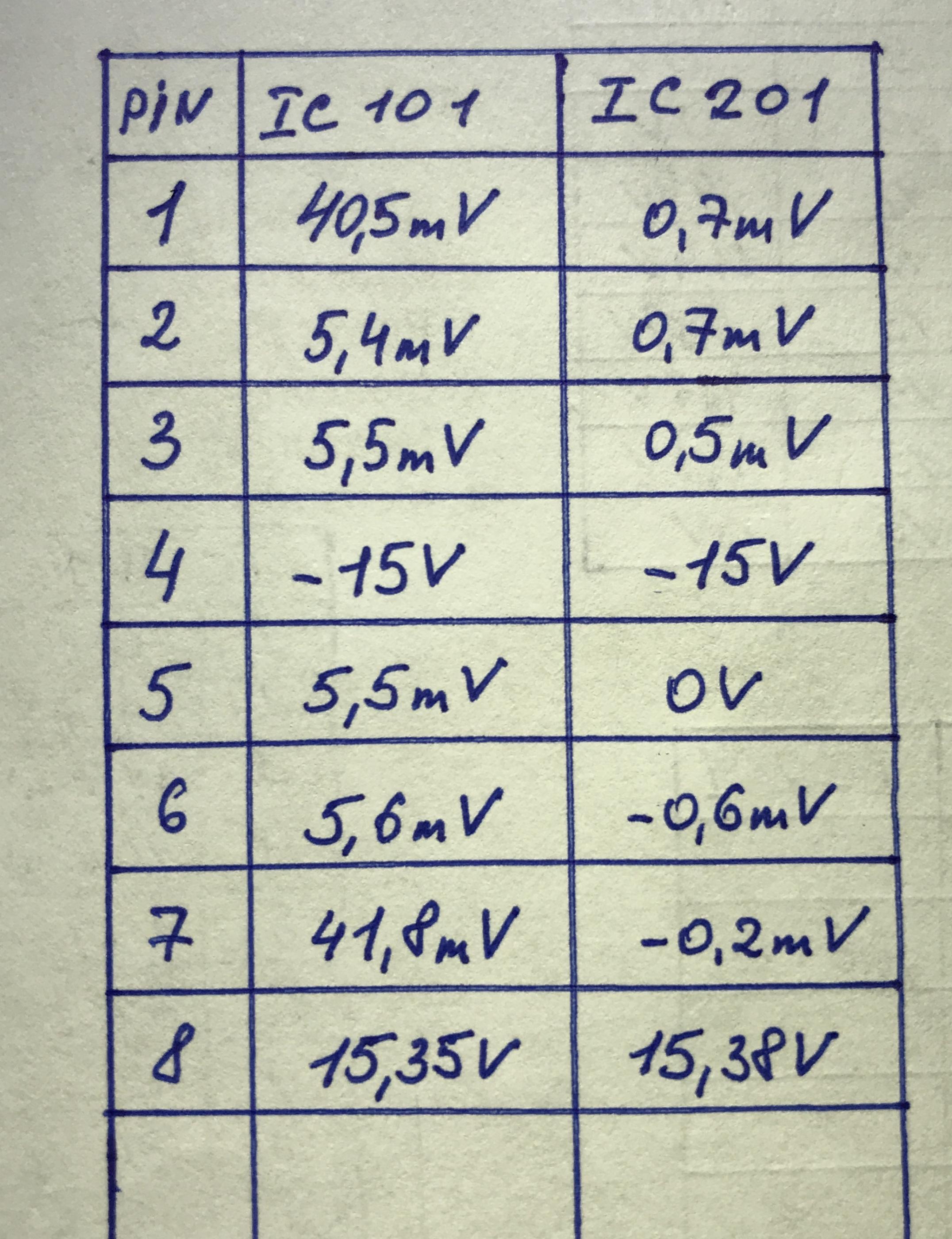

I wouldn't expect the amp to produce audio in this condition. Is the amp in stereo mode?
If so, does the voltage on pin 1 of the 4570 change significantly is you switch from fixed gain to variable gain?
The amplifier is in stereo mode, and when I switch the fixed gain to variable gain, the voltage at pin 1 4570 changes from 40,5 mV to 20 mV;
I don't think the amp could have had audio on both channels if the amp is in stereo mode with 15v on pin 1.
The numbers on the service manual won't be exactly the same. Which voltages are you concerned with?
