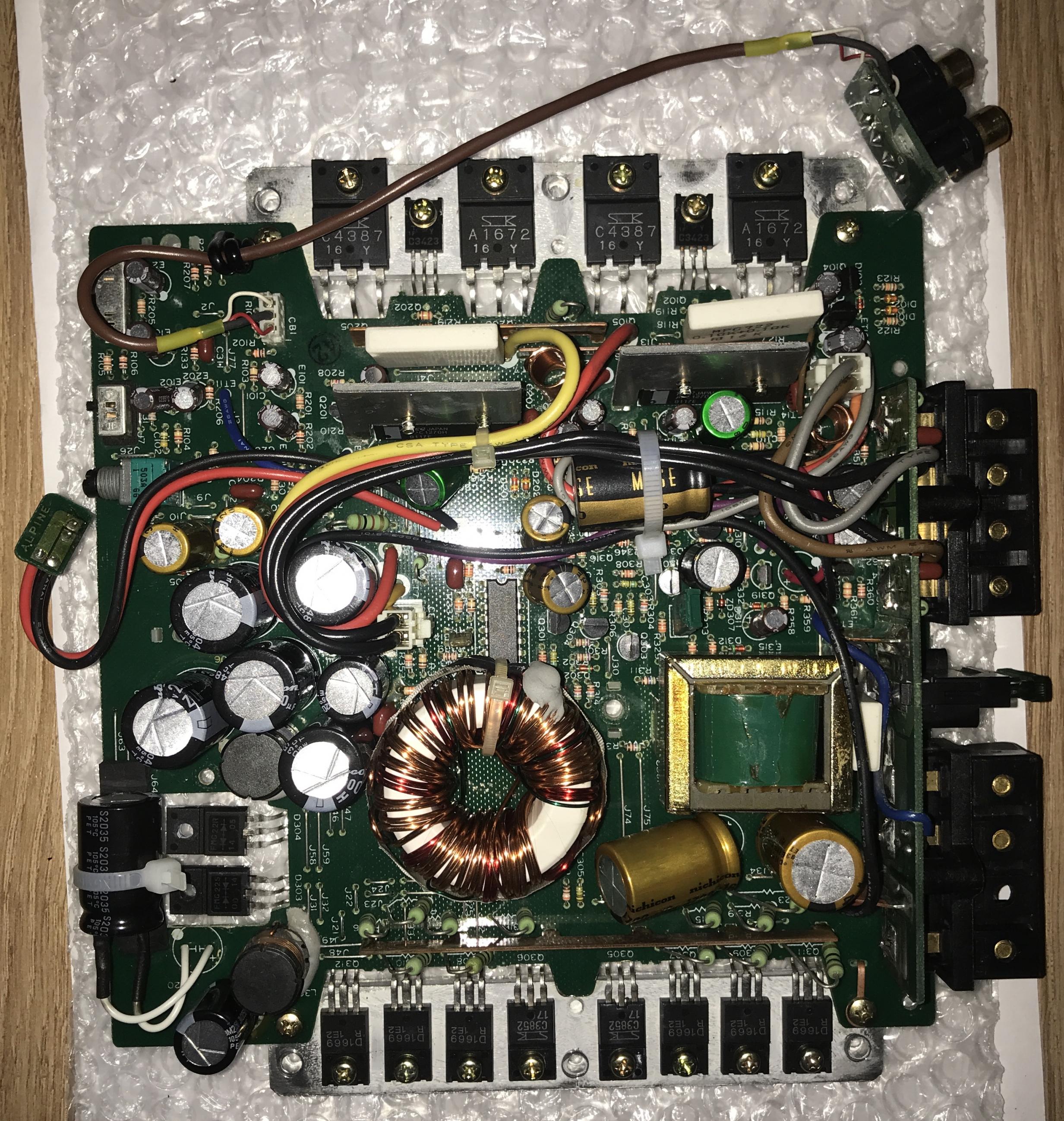

Alpine 3542 no sound
For op-amps in a circuit that uses local feedback (this circuit), the output and inverting input of each op-amp section should closely match the non-inverting input.
That's essentially what you have.
The voltage that you saw change with the gain selector change is due to a change in local feedback.
Without a scope, it's difficult to know for certain whether the amp is 100% healthy. It likely is if it sounds OK, especially with the numbers you last posted.
