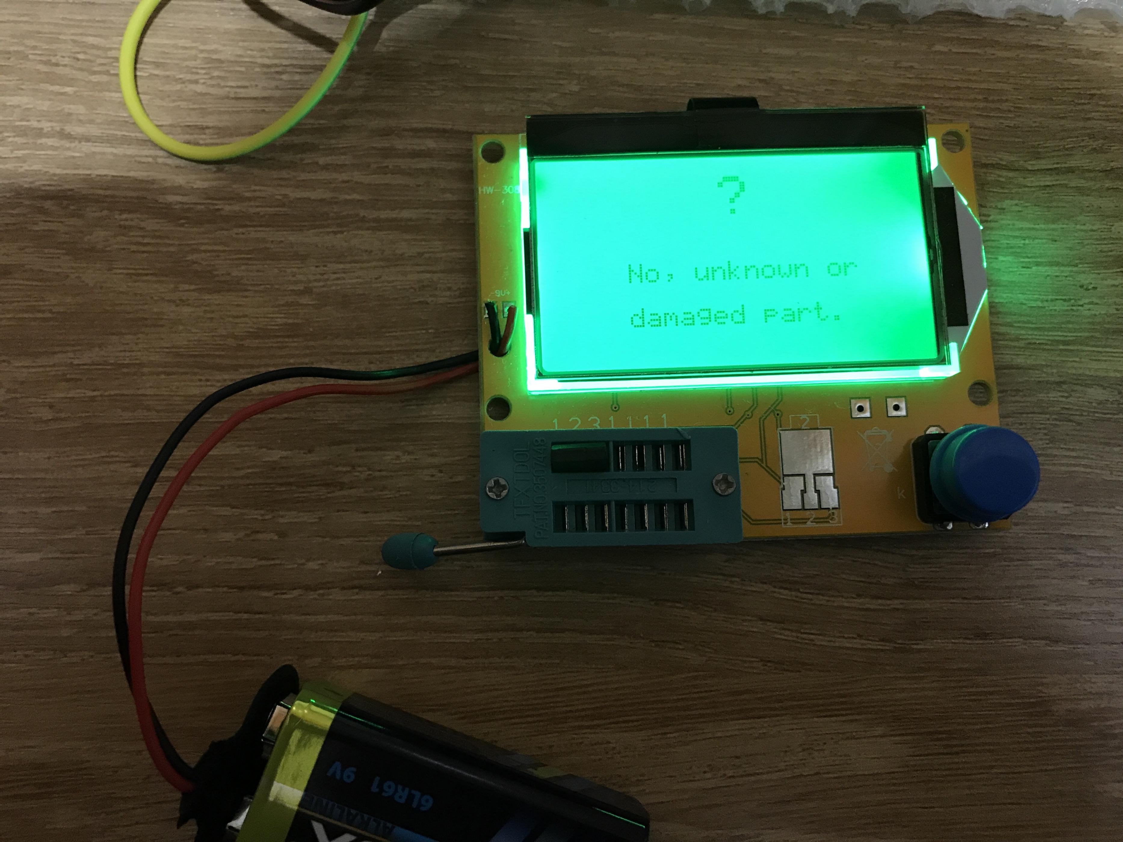

Good afternoon, sorry for not answering for a long time, there was no time. I found one damaged transistor Q318 2SB1076M, but I cannot find them on sale. Tell me what analogue it can be replaced with?
Was it open/shorted? It's a darlington so it may seem defective if you're checking with a meter.
https://alltransistors.com/adv/pdfdatasheet_rohm/2sb1076m_2sb1239.pdf
Do you have any other darlington transistors on hand that you can test to compare readings?
You can build a darlington from the diagram on the datasheet to see if you get the same results when testing.
