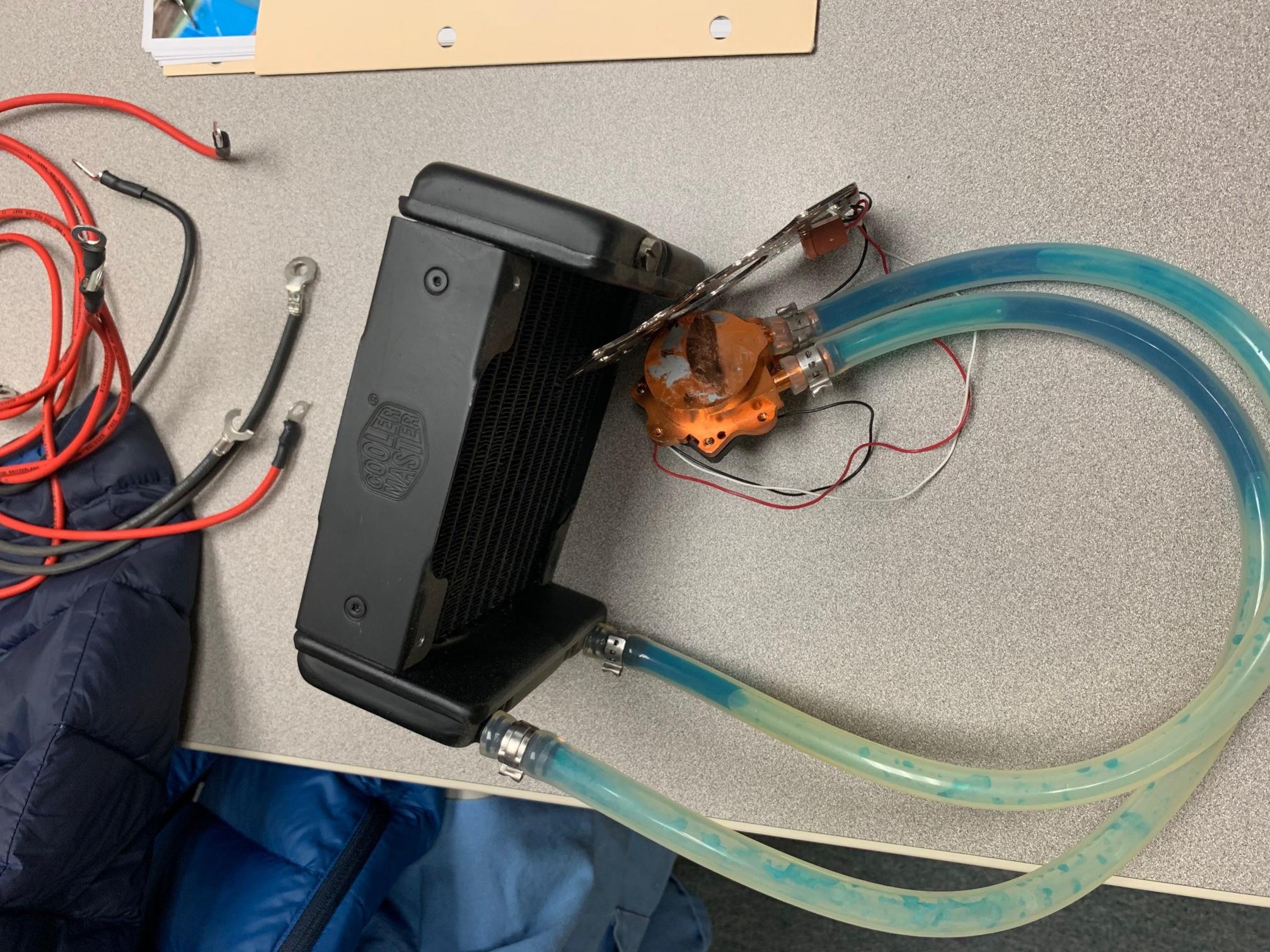

I saved this guy from the dumpster! Not sure what blue fluid is... You all think it would work well? Would you still need a fan blowing on the radiator?

The fluid is basically distilled water with anti-corrosion, freezing and other additives to inhibit bacteria etc. I think they dye it blue to make it look cool. 🙂 Do a search for replacement options, and yes, you will want a fan, or I would, you can replace the sink as well. They aren't all that expensive, depending on model and name, so don't spend to much mucking with it.
That makes sense. So no need to drain and clean; just refill with filtered water?
Make sure it's distilled water and add a bit this.
EDIT: THERE IS A WARNING ABOUT ADDING TO SOME TYPES OF FLUID! I would drain it all out and flush it, add distilled and some of the stuff I linked. You don't know what the hell is in there right now.
I'm sure ya know, but on the off chance... Pure water does not conduct... it's the minerals in water that make it conduct. This way, if at some point you get a leak, it won't short out your ****. 🙂
I should say it doesn't conduct well. 😛
CPU coolers with heat pipes never leak and don’t require water changes. It’s fun to play with water cooling but might be messy. Also, that copper block will only hold one MOSFET. Make sure the pump in that copper block is not too noisy.
The radiator can be saved but maybe you might need a new pump/copper block.
