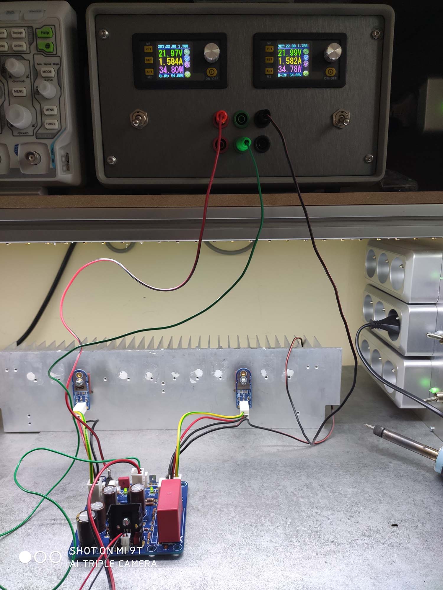

Alpha Nirvana first sound!
First impression: sounds sweet, no thump on startup and pretty silent between tracks.
Many thanks X, Hugh & JPS.
Jacques
Great to hear, Jacques! 🙂
"No startup thump" - did you incorporate the SSR boards?
Andy
Jacques
Nice work Jacques!
What type of psu will you use for your build?
Well done Jacques - when you have the second channel I'm hoping you will appreciate even more beautiful sound......
