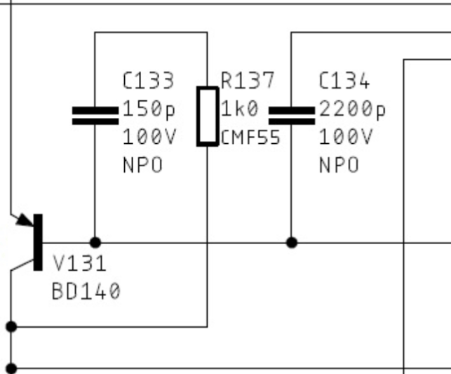

I don’t know if I would assume anything.
I would look at the schematic and trace it out:
Both C133 and C134 have one end connected to the base of the V131 transistor. Identify which pin of V131 is the “base.” Typically pin 3 for this type of transistor. You also know that C133 is connected BETWEEN the base of the V131 transistors and R137 (1k ohm). Once you have identified that, you are done.

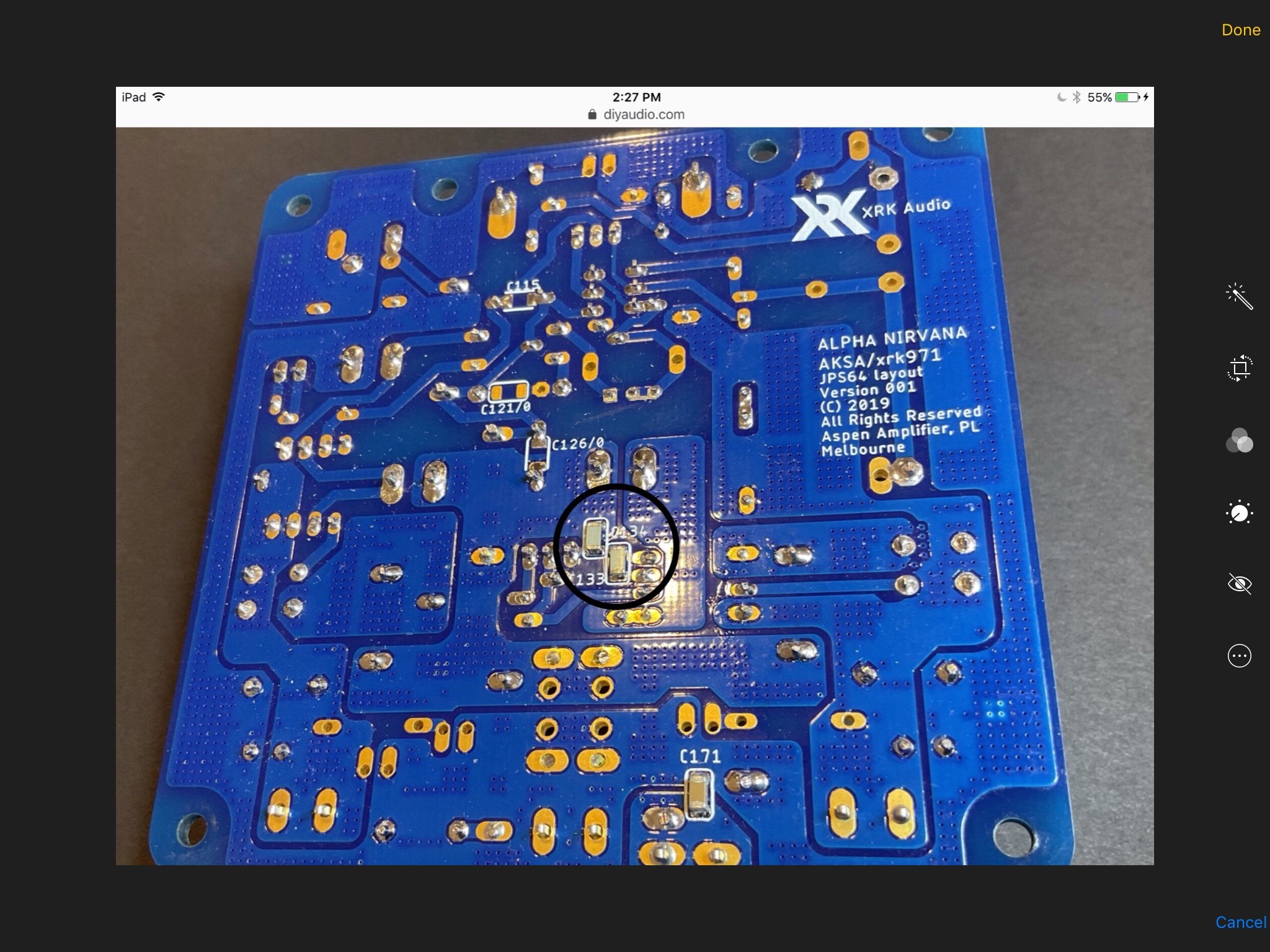

Well even after trying to trace this down about C133 and C134 I am still not
100 percent sure which is which but it seems that C133 is the one in the image that is on
The left side of the board with it corresponding number below it hopefully I am right on that
Help guys?
Scott

Yes, Scott, you are correct. But to be sure, remove one of the caps, measure it, then reinstall to be sure you have 150pF on one side and 2.nF on the other.
HD
