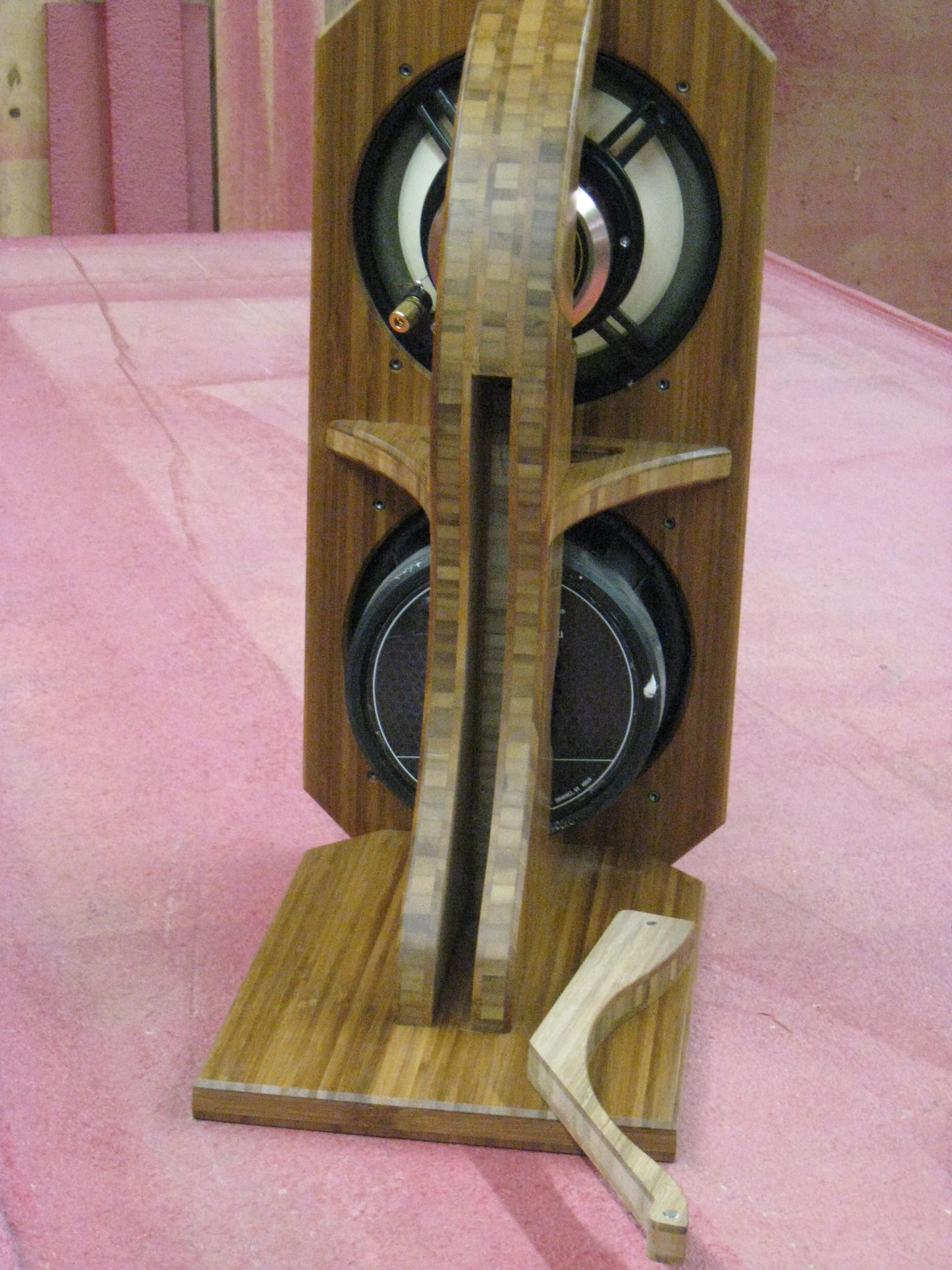

How about Speak-on terminals on the bottom of the box for a tasty installation ? Route a channel or Laminate 3 layers of ply for the support leg with a removable strip, held in place with velcro, or magnets as in this recent bamboo sculpture for BudP

Steven, as mentioned in your PM to me. This design is by Scott.
Scottmoose on this forum (and others).
I am not at liberty to give the design specs/paramaters of these speakers freely on the forum. The stands are my own design and not that difficult a task for anyone who can draw a couple of compound curves to get the shape they want. Just remember to make the centreline of the curved pedestal vertical and both shelves central to the speakers.
However, Scott is prepared to share if you, or anyelse contact him direct on a one-to-one basis.
Colin
when You emailed me asking for a copy of the plan for these stands in June of this year I politely refused, explaining that they were commercial copyright of Vitalstates Ltd. I'm really not sure what you are trying to say to me here but I can only assume that by ignoring my answer you are trying to antagonise me.
To take the design of another person, a commercial design, and promote it for home construction would appear to fly in the face of copyright ownership, and could possibly lead to loss of revenue for the copyright owner. To then claim the design to be yours causes me to respond thus.
In your first post you allude to me being flattered , well surely the resulting emotion is mine by right, and in this case I am offended.
