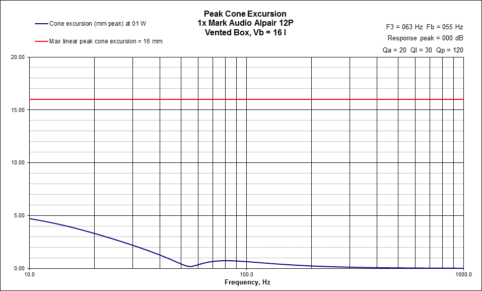

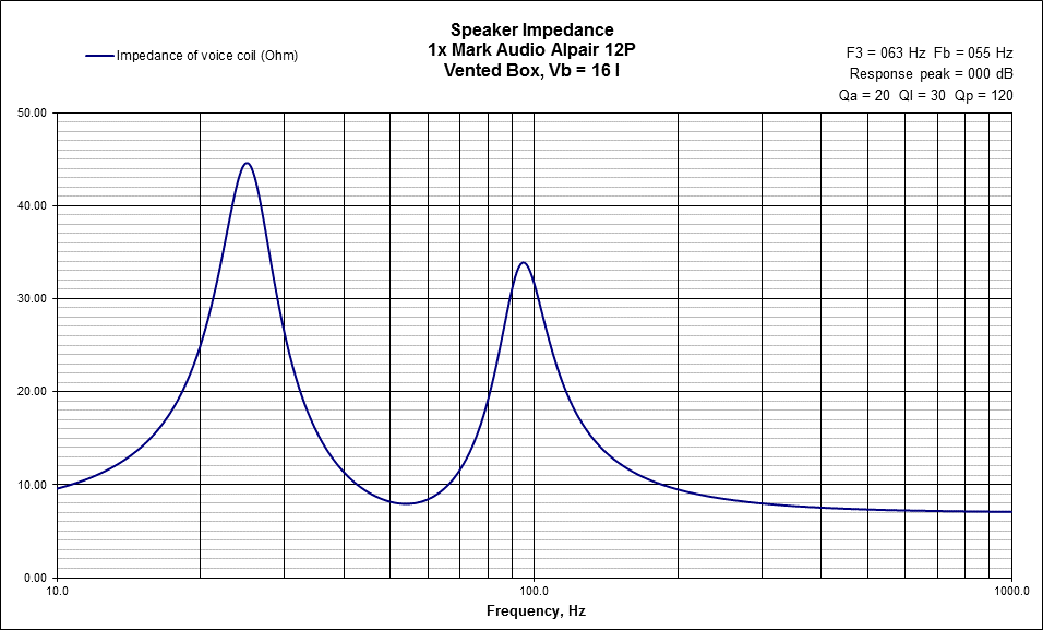

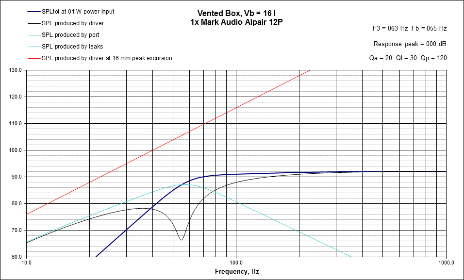

OK, since there's been some interest, I'll put this out.
It's purely a DIY design, so for strictly non-commercial use only. For anything else, please contact me direct.
Nothing novel about it, it's a simple BR standmount, albeit with a slightly damped alignment. Internal dimensions:
345mm x 218mm x 218mm (HxWxD).
Driver centre 115mm down from internal top.
Vent 50mm diameter x 83mm long, assuming a vent with a single flared end. Note that there is a slight fudge-factor here since not everyone can get metric vents, or those with flush ends. If you can't, re-size accordingly: the target Fb is 55Hz. Vent centre is 115mm up from the internal bottom, on the rear baffle.
Top, base, back and sides of the box should be lined with damping material -your choice, could be ultratouch, 1/2in fiberglass, wool felt / carpet underlay or similar. I strongly advise avoiding egg-crate foam. Never had good experiences with it & the A12p will almost certainly sound like it needs a large dose of health salts if you put any of that material in the box.
Bass output is not thunderous (as you would expect -you've the wrong box and wrong driver if this what you need), but in a modest space it's surprisingly solid, especially with some boundary loading, and even more so if you have a high[ish] output impedance amplifier like Colin's custom 300b monoblocks.
