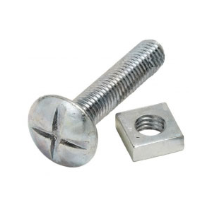

Yesterday I decided to fix the spikes to the pedestal stand bases and bolt the stands to the speakers.
I used M6x10mm threaded inserts drilled into the underside of the speaker bases and M6 roofing bolts with 20mm dia washers to fix he speakers to the stands. To hide the fixings, I inset the washers and bolt heads into the top shelf of the stands. Not sure what name this type bolt has in across the pond so see image below.
This has tightened up the whole sound and improved imaging. They are now sitting happily either side the fireplace with the rear ports firing into the alcoves either side the chimney breast. This was a well worth exercise. 🙂
