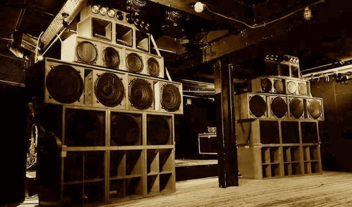

I use them both with and without the extra woofer. depending on where and for what i set them up. And they work both ways in reality. I don't damp the ports, i tried with putting some foam in them when connected to the sub, but that sounded very ugly as the ports are still slightly loaded due to the slow cr curve (1st order) but so soft you don't hear it until they are damped...
That is also what many reggae and dub soundsystems do. They use the classic Dual G subs (ported dual 18" cabinets) as kickwoofer (85 until 350 a 450Hz). The box is tuned to 37Hz (F3), but they cut it at 85Hz (4th order L/R) without damping the port and this works better than damped or a similar sealed box.

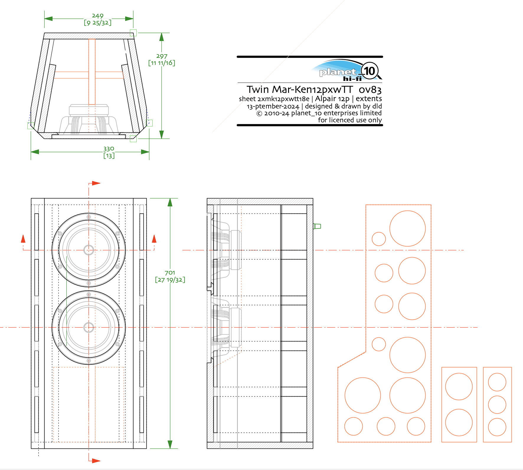

Sorry for the confusion, I thought that the name is correct (per first post in the link I pasted above). What would be the proper naming/type for this kind of enclosure ?
First of all I would like to know what kind of amplifier is suitable for driving them (I have class AB with high damping factor/low output impedance).
Reading through the posts I got the impression that amplifier with high(ish) output impedance is more suitable, but please do correct me if I'm wrong.
Secondly, is this enclosure part of the paid planset as it is somewhat unique ? Do you happen to know the external dimensions ?
Thirdly, what are the projected Fb/F6/F10, if you have this information ?
Thanks for your help!
This Twin A12pw is the same volume and could easily be adapted for A10.3/A10p. Venting and driver mounting would change.
Of the miniOnken family it would be, IMO, acoustically the best shape, but the more difficult flavour to build.
Woulkd require a short stand or sides extended to the floor.

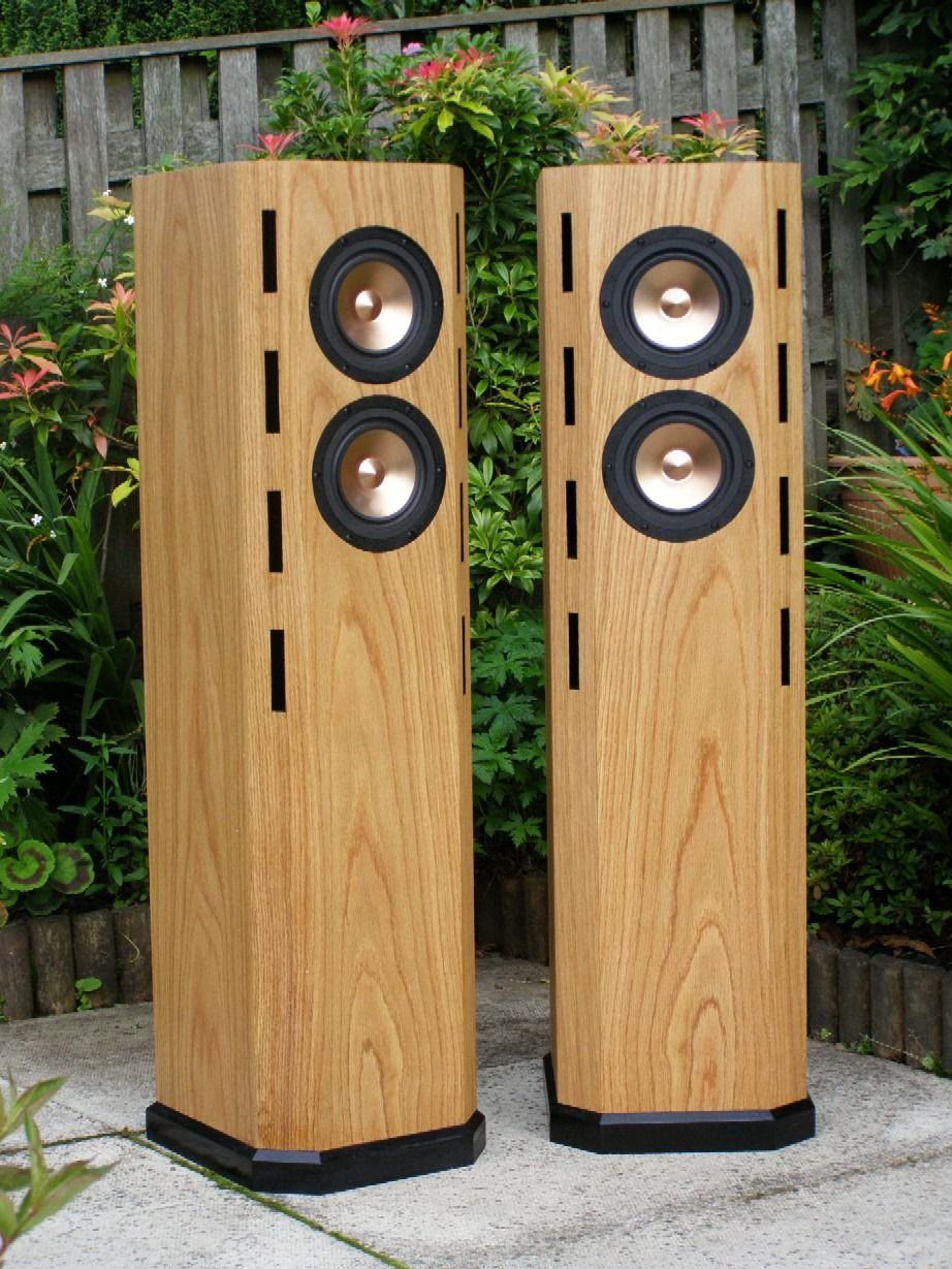

Those are for the original A10. Colin’s build. Like the ones i posted above they need help reaching the floor, these have an empty bit on the bottom — fill with sand.
Derived from the Fonken165R
This is the rectangular version, easier to build than the trapezoid but with a bit higher diffraction signature. Could also be adapted for A10.3 and A10p (where it would come in 2 sizes). The 10.3 version (and the smaller A10p) could have a larger cavity at the bottom to give a wider range of options for using it for a helper woofer.

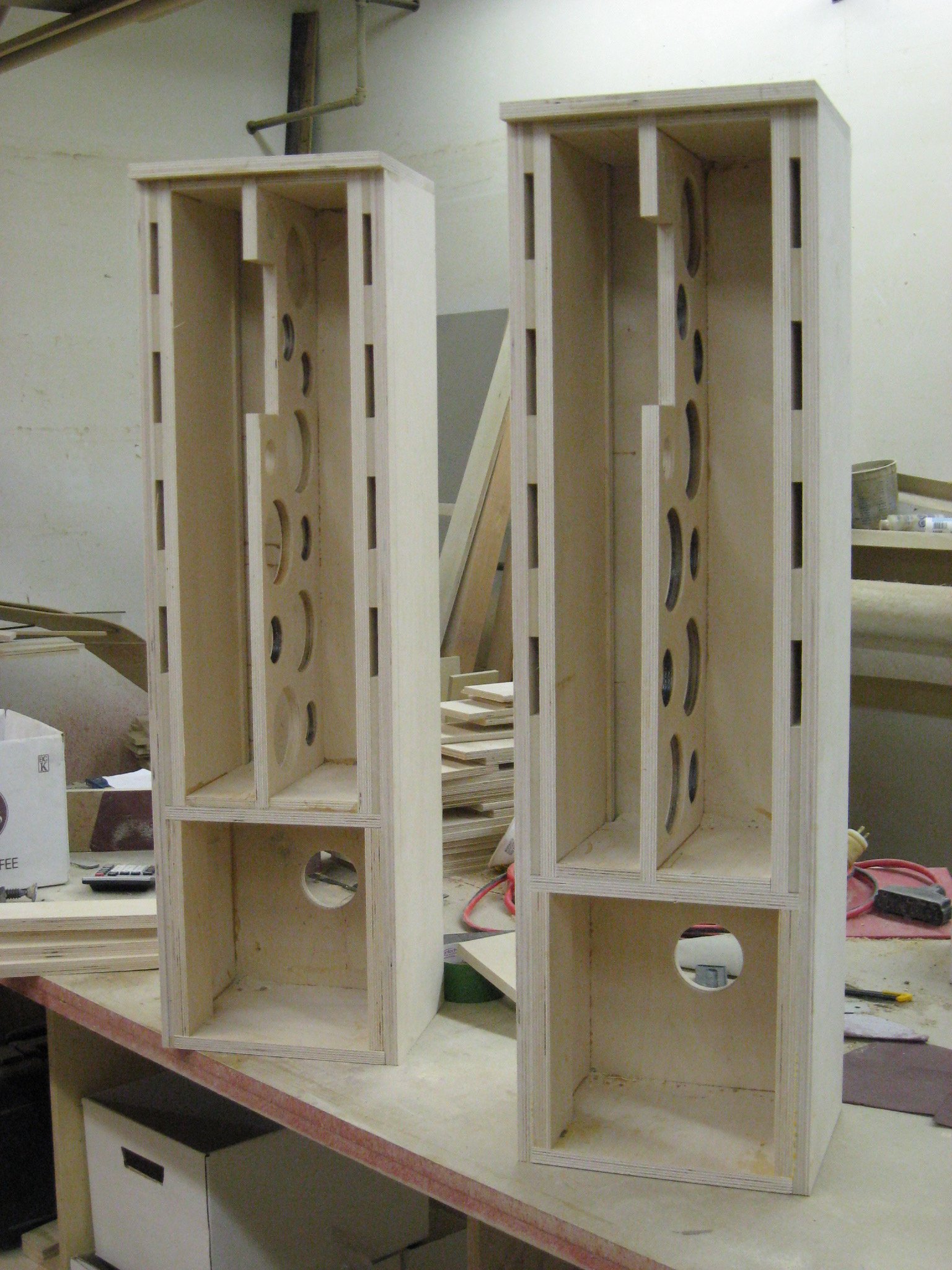

Holy time warp Batman! FWIW my sister still has the Walnut floorstanders in her Willis Point home, but I can’t remember the last time they were fired up. FE167, IINM?
After some of our later W.A.W experiments, if wanting to add bass augmentation in the lower compartment, I’d be inclined to a pair of smaller woofers in an opposed configuration.
FE167 Fonken internals. time stamp in my photo library on the group shot says May 2009, so yeah, that’s a while ago.
