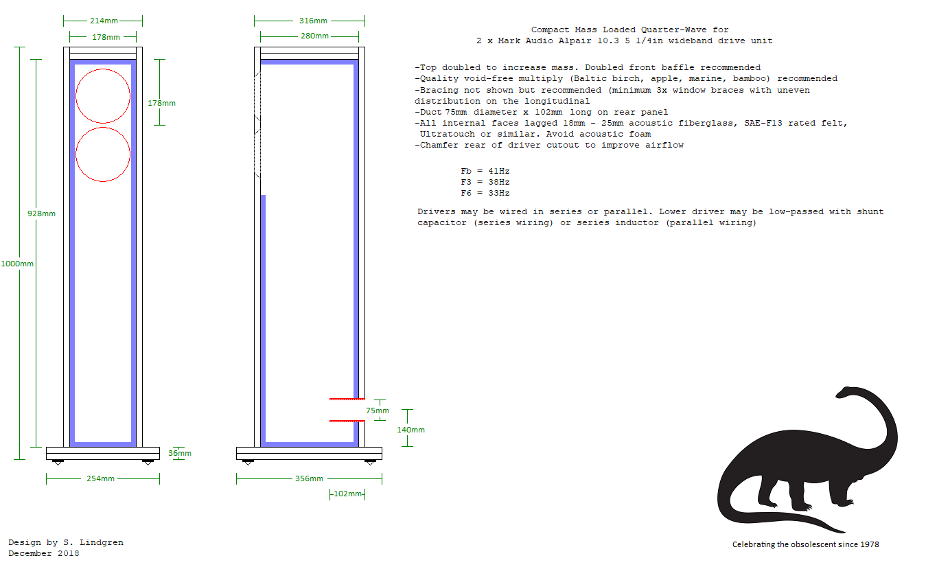

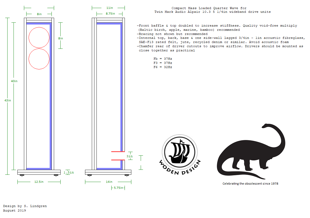

Alpair 10.3 dual help.
64 litres is an ML-TL.
A10.3 in 25 litres starts looking ugly, but you aren’t actually using them for bass. Have you tried damping the vent?

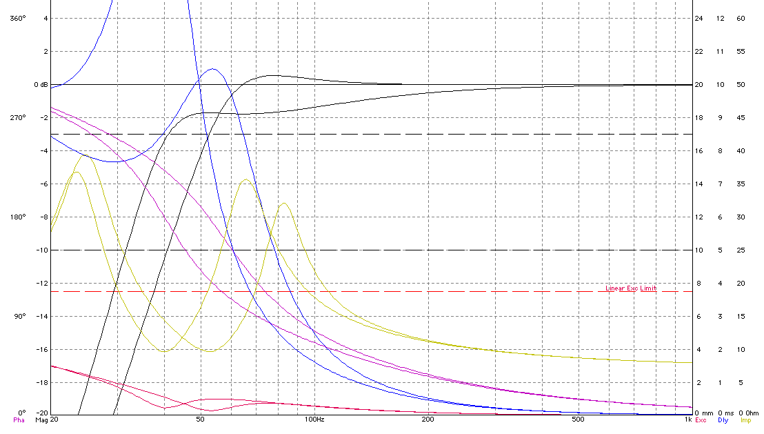

I use them both with and without the extra woofer. depending on where and for what i set them up. And they work both ways in reality. I don't damp the ports, i tried with putting some foam in them when connected to the sub, but that sounded very ugly as the ports are still slightly loaded due to the slow cr curve (1st order) but so soft you don't hear it until they are damped...
That is also what many reggae and dub soundsystems do. They use the classic Dual G subs (ported dual 18" cabinets) as kickwoofer (85 until 350 a 450Hz). The box is tuned to 37Hz (F3), but they cut it at 85Hz (4th order L/R) without damping the port and this works better than damped or a similar sealed box.
