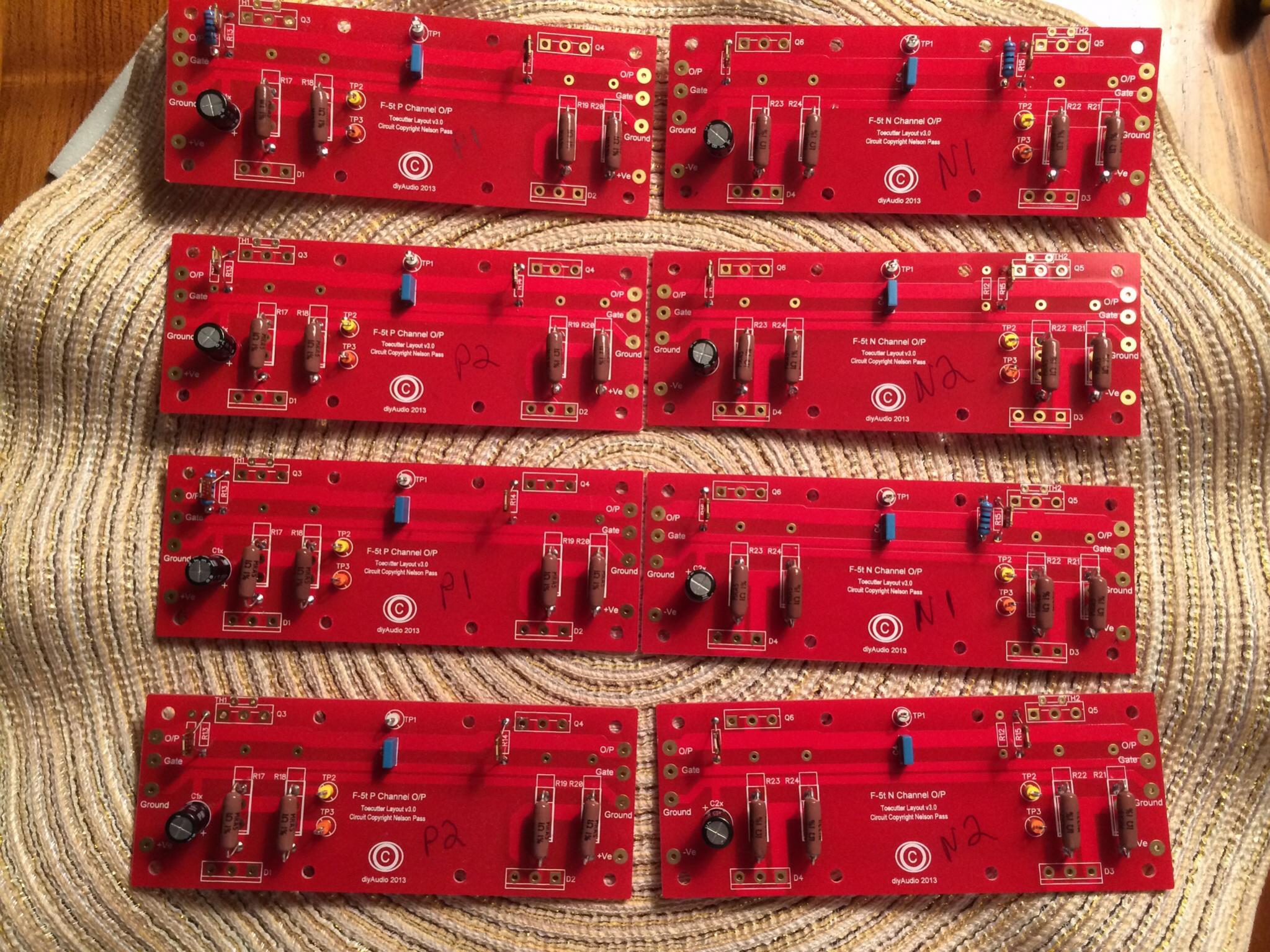

Starting to stuff the N and P boards. So my first question. I'm going to add leads to all the devices on the heatsinks to be in the best location for heat disapation. What is the best way to extend/attach the thermistor (TH1)?
If possible, try to keep the leads as short as possible. in fact if you can swing it, I would recommend that you attach the mosfet leads directly to the board and not extend it at all and ionly if necessary extend the leads of the diodes.
That way the thermistor doesn't have to be extended.

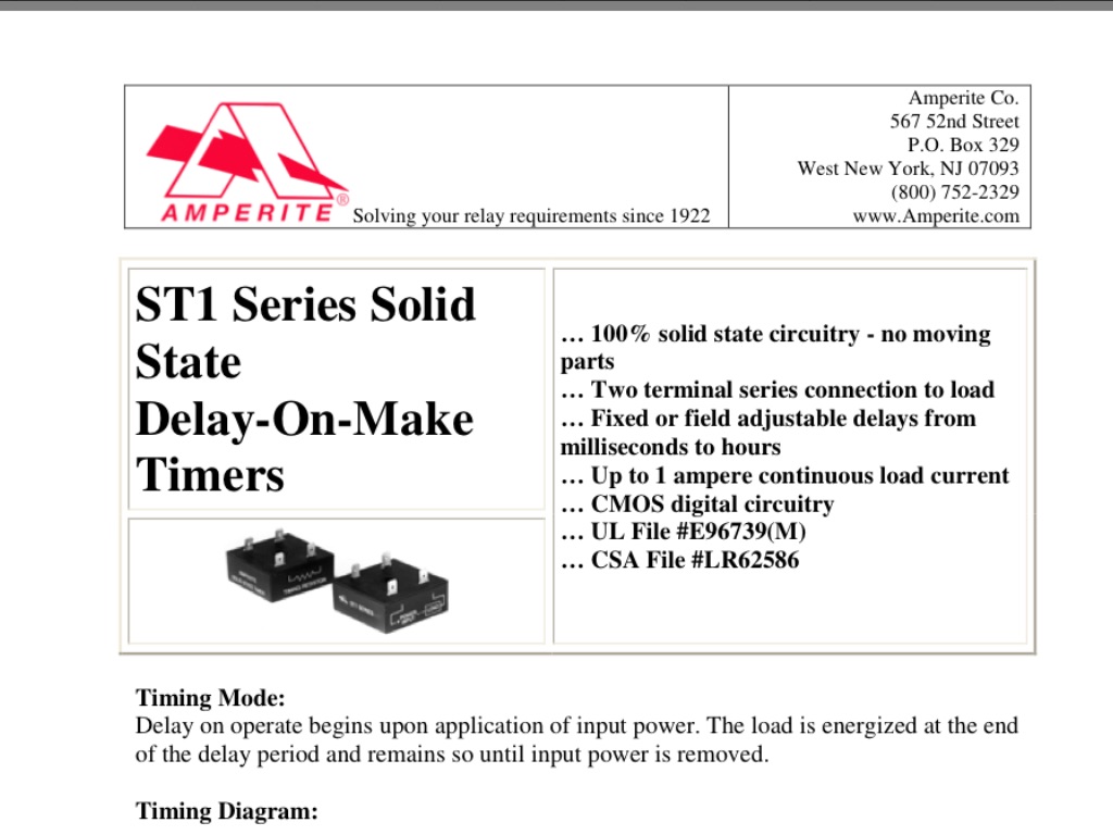

What are you using for a timer for your slow charge to bypass the thermistors? How long of a delay? I found this today, might make for an easy way to control the contactor.

Finished stuffing the N and P boards last night
Starting on the FE boards tonight. My Toroidy transformers have shipped, but my Mundorf caps won't ship till the first week of November from PartsConnexion.
I don't think those will work. it says a max continuous load of 1A.
From your rails biasing to 50W will already take you up to a 1A draw!
In my case I used a very simple RC timing circuit to control two relays to switch the thermistors out after about 18 secs.
Its crude, but it works.
However I would use something like what BigE designed. Its safer and disconnects the relays as soon as power is switched out.
