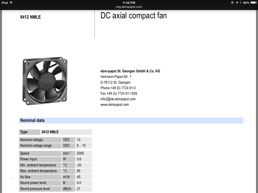

This is the fan that I bought. Almost as quiet as the Noctua, and black, not the goofy colors of the Noctua.
I finally finished building the chassis, at least the aluminum part of it. 99% of the drilling and tapping is complete. Brought them home and now time to start stuffing the boards.
I have on hand about 90% of the components to finish. Still waiting on the transformers and the Mundorf caps to arrive.
Organizing the 12vdc control circuit, heat overload, fan control, push button on/off control, soft start, slow charge, etc is almost as involved and the amp itself!
Have you had a chance to listen to the noise of the fan yet?
21dB (A), I understand.
What is 4.0 B ?
Is that Bels without the deci attached, i.e. equivalent to 40dB
What is 4.0 B ?
