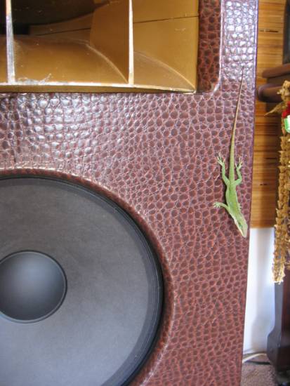

I have the 15PW3 with paper dust cap. The midrange is good. Use 2 per side, if you can.
Very popular with the local wildlife, as seen in photo below...
Hehe...interesting...
OT of course, but...
Me and some of my best friend used to call each other "lizards". I've got a big wooden lizard as a wedding present. ..🙂
Now I see that there's a connection between lizards and speakers...hehehe :clown: :devilr:
P.s. Do you think I should use that photo as an avatar?
Vix (the lizard)
