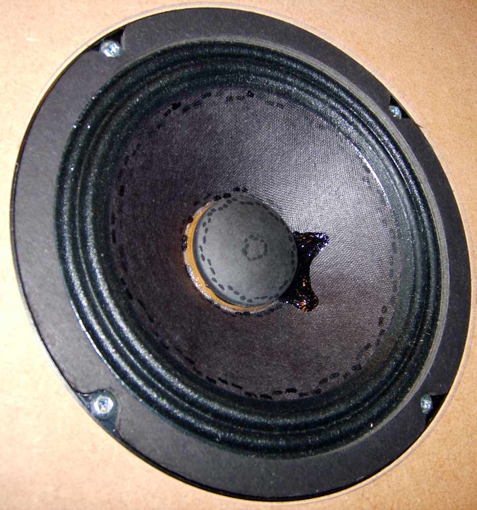

Did you send the picture or should I get a new (read better 😉 ) one tonight?
yes- send better one - if you can;
they look absolutely proper ; that's hand work,after all .
Zen,
Looks like very good workmanship.
Now, you need to put a dot in the middle of those central block rings. The dot should be paint first and then, when dry, a drop of PVA (white wood glue or speaker surround to frame glue).
This PVA dot is going to enforce maximum lateral dispersion for highs.
The end result will be that, as you move from an angle that allows you to just look into the cone, all the way to the voice coil, all the way across to the other side of that cone described arc, there will not be any hot spots or any cone specific location clues, even directly in front of the dome. All sound will seem to arise from behind the driver and will be coherent to that sound field, without ever seeming to come from the driver, at all regardless of your angle to the cone.
You use the gloss to enhance this performance by using between 1 to 3 times as much on the cone as on the dome. You are correct to listen before applying the gloss. If the bare treated cone already has no hot spots, then a 50% coating of gloss on dome and cone may be all you need.

as always-tnx Bud for time and patience .
in fact -Yunick boy is man with cal. pens in hands this time ;
I just haven't enough time yet for your tide fences .......... some plain things and works take all my -free and not free - time in last few months
