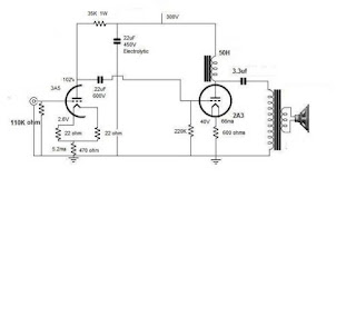

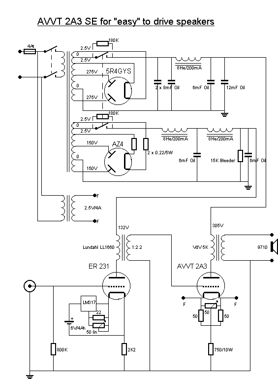

Still going through my schematics, here's what I have for 2A3:

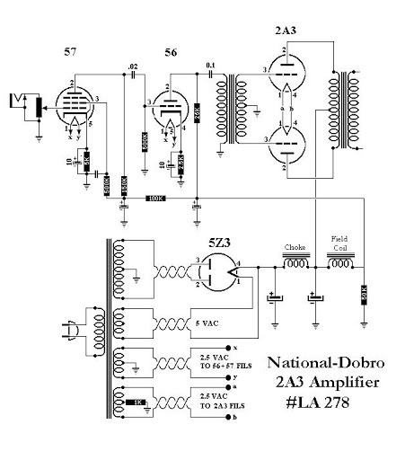

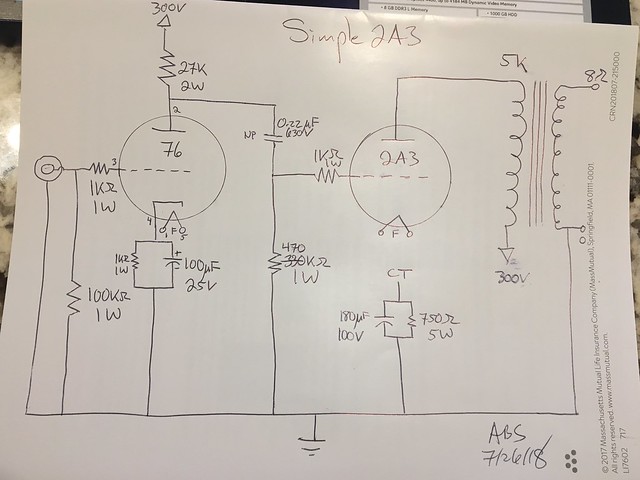

And I know this next one is breaking the rules of this post because it has cathodes, and it's not even hi-fi but I thought it was cool and interesting and kind of historical in the sense that 2A3's were once abundant and cheap and a go-to tube. Included because it is transformer coupled and transformer phase inverted. It appears to be an old dobro instrument amplifier that uses 2A3's as the output. I would imagine this to be a good nightclub jazz guitar amplifier (maybe?), warm and clean a la Johnny Smith? Simple, just uses the guitar volume and tone controls, and a field coil speaker (field coil speakers.... another thing that was once cheap and plentiful but today requires a mortgage to buy) very cool. 57 is the same as 6C6 (the tube in the Radiotron application note) but the guitar plays right into the top cap which is the grid. 56 mu is 13.8.
Johnny Smith (famous Misty melody/chord number)

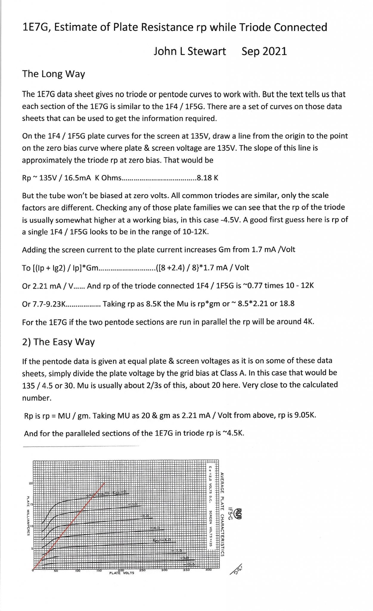

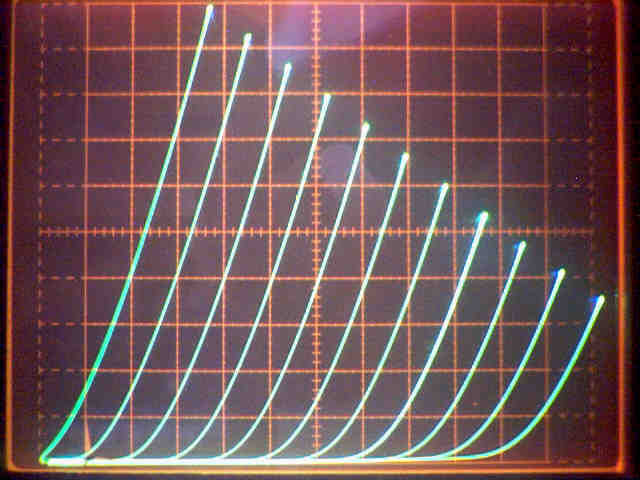

Hi Andy, have you come across the 1E7G - 2 DH pentodes on an octal base.
1E7G
Showing my ignorance a bit here, but looked like a possible driver with both halves in parallel.
Perhaps this will help. Curves from Smoking Amp. 👍
  • 1E7G Both Sections Paralled in Triode on Smoking Amps TEK 576 May 28 2010.jpg

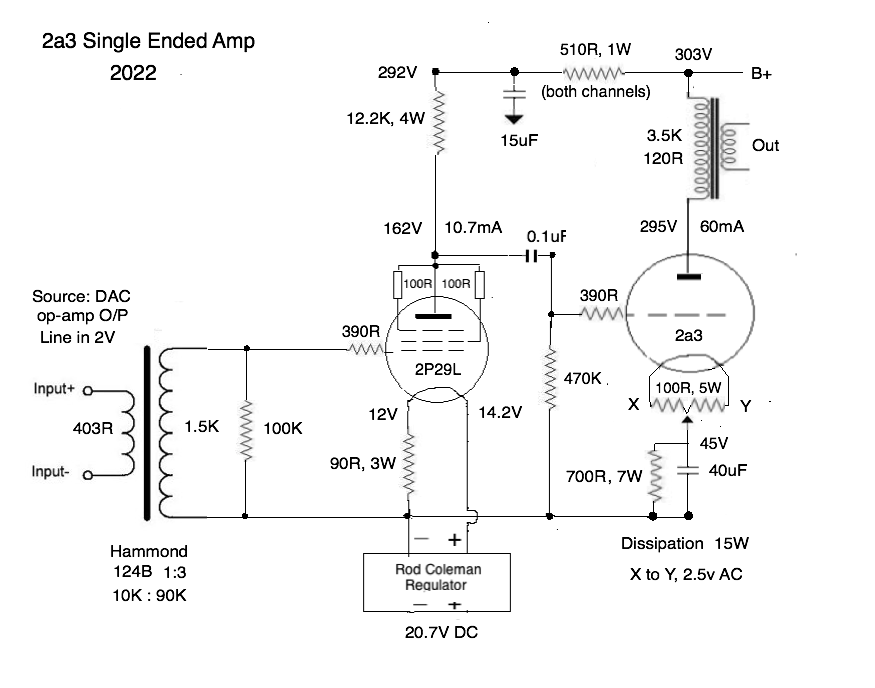

I've just built a 10Y stage in filament bias, so I swapped that in to the first stage of my SE 2a3 amp in place of the 2P29L with SUT.
It's better in just about every way - tone, realism, presence. It's very good.
I still like the 2P29L though - it has most of the sound but kind of at 90% of the 10Y. In fact it's closer to the 46 preamp I made, which is very neutral. The 10Y is more towards a lush sound like the 26, but not as warm. I'd say it was a full sound. The 2P29L is leaner. Since I leave my system on 24/7 the 2P29L will stay as my daily amp with the 10Y in reserve, if I have any I haven't sold!
