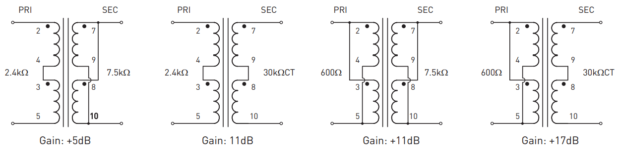

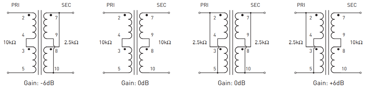

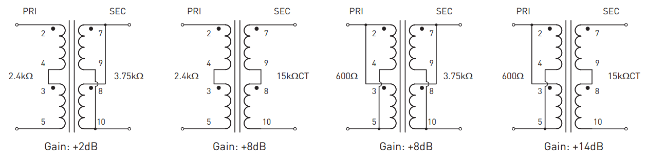

So it looks like models UTC2571, UTC2581 and UTC2582 would be the choices for gain at line levels? Low, medium or high gain models it seems, which would be the most useful for experimenting in this topic +11 db?
UTC2571 wirings:
UTC2581 wirings:
UTC2582 wirings:

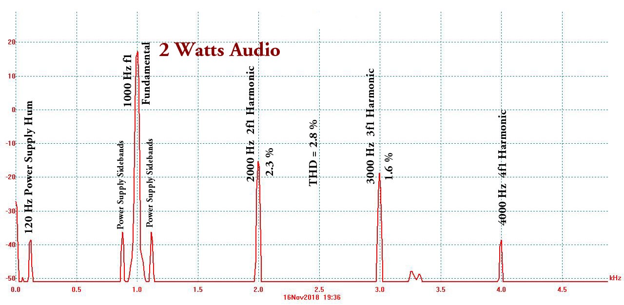

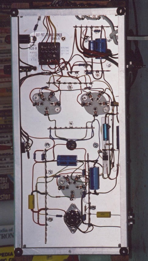

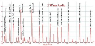

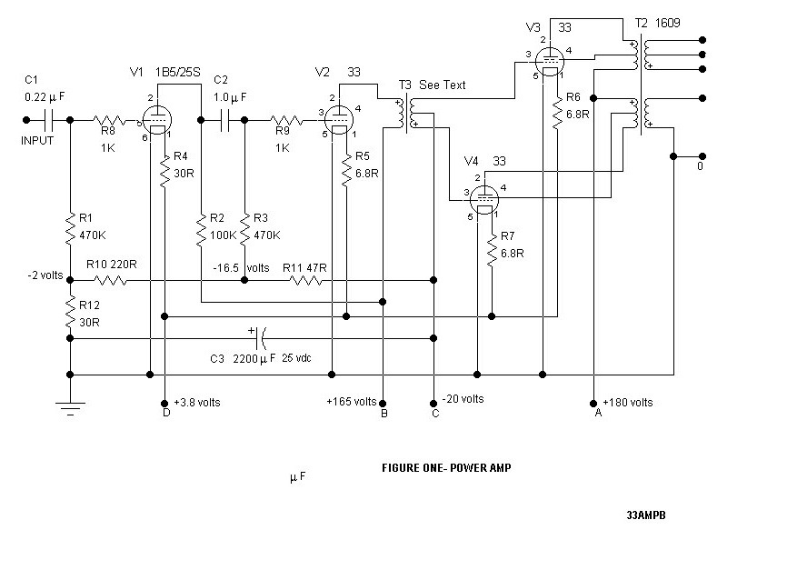

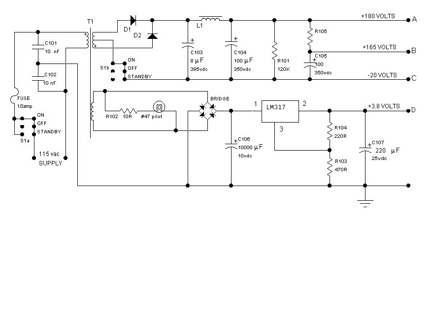

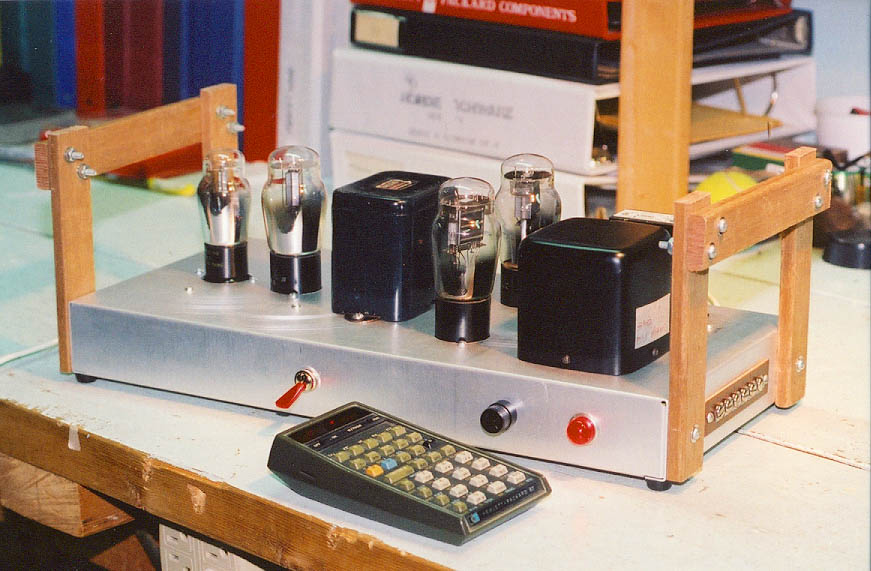

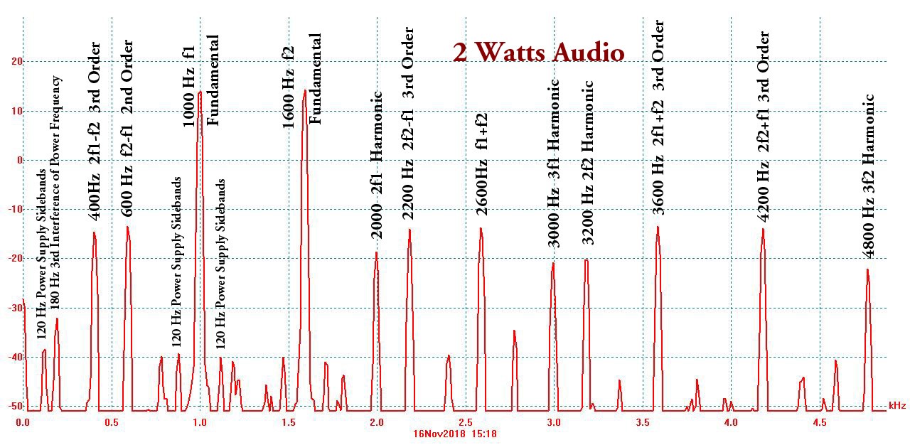

OK Andy, here is mine from about 20 yrs ago. All 2V tubes, PP 33s, IT coupled to a triode connected 33 driver.So please post your ideas, schematics and comments of any kind and let's make this thread an interesting one!
And take your choice, triode or UL output. The 1B5/25S front end is a bit microphonic. Just another of my experimental amps.
And it sounds OK on my old RSC speakers from about 40 yrs ago. My ears don't care anymore.😀
Summary of Distortion Products 33 Amp at 2 Watts Single Tone.jpg132 KB · Views: 245
Summary of Distortion Products 33 Amp at 2 Watts Two Tone.jpg176.9 KB · Views: 169

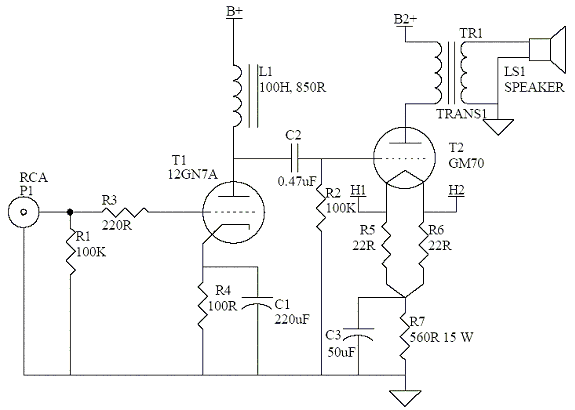

It doesn't meet the requirements in the opening post, as the 12GN7A is indirectly heated and is used as an amplifier stage.
Indeed - DHTs only here.

Nice calculator too, still my fav.OK Andy, here is mine from about 20 yrs ago. All 2V tubes, PP 33s, IT coupled to a triode connected 33 driver.
The HP calc line was a result of Bill Hewlett looking for ways to sell more of the then all new 7-segment LED numeric displays.Nice calculator too, still my fav.
A potential customer was identified & quite a bit of work took place with them. Then the other side dropped the project.
Hewlett tasked R&D to develop an engineers calculator that would fit into his shirt pocket & be usable all day.
It appeared as the HP 35, 35 since it had 35 keys. Marketing thought they could sell 10K of these a year.
But it turned out that every scientist & engineer on earth thought they needed one of these marvels. 300K were sold in the first year.
And many of us switched to RPN, Reverse Polish Notation. An Option 35 was set up so that engineers could get one with a scope.😀

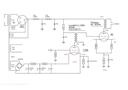

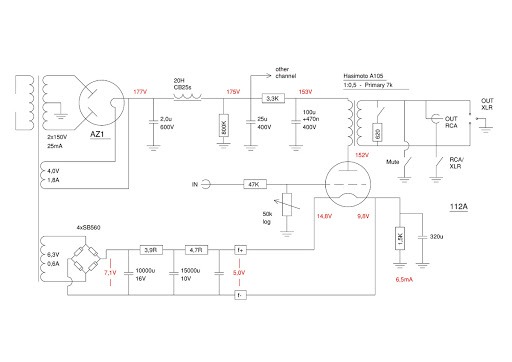

Windcrest- did you actually build that 112A > 45 amp? I'm interested to know how the LL1660 worked in 2:4.5. I have a couple of LL1660 and could try that if it works. This would be into a 2a3 output.
