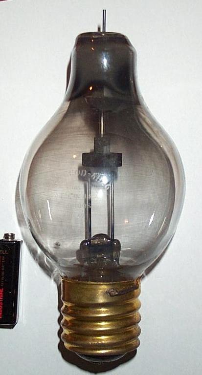

The traditional solution is a lead-acid battery. You have to recharge it with a transformer and mercury vapour rectifier every now and then.
That kind of thing was still in circulation when I first worked on cars (1950). It was still possible to buy a Tungar rectifier,
either from the radio parts store or the auto supply. Very common in the 20s, charging 6V batteries for battery
powered receivers using lead-acid batteries to run 201s, Etc. Tungar, Tungsten filament & Argon gas. Nice glow!

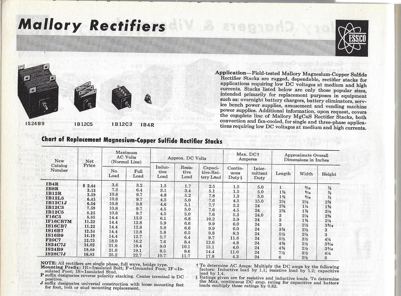

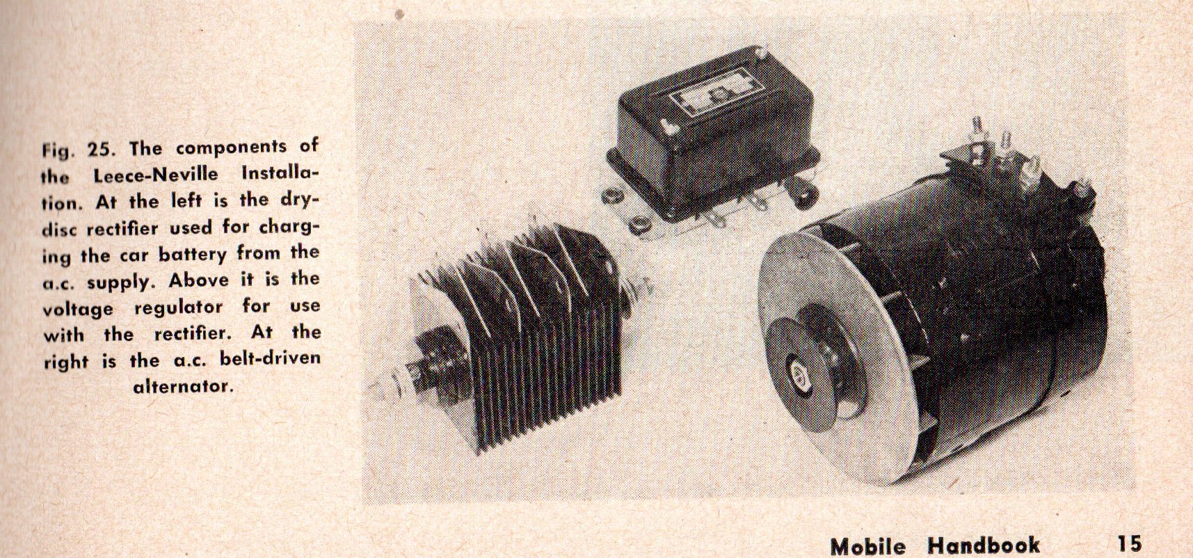

Many were displaced by copper oxide rectifiers in a different circuit. CuO rectifiers don't have much of an inverse voltage rating tho.
And soon replaced by Copper-Sulphide Rectifiers. These were used with the first alternators in police cars & taxi's.
  • 4B26 Tungar.pdf
    4B26 Tungar.pdf

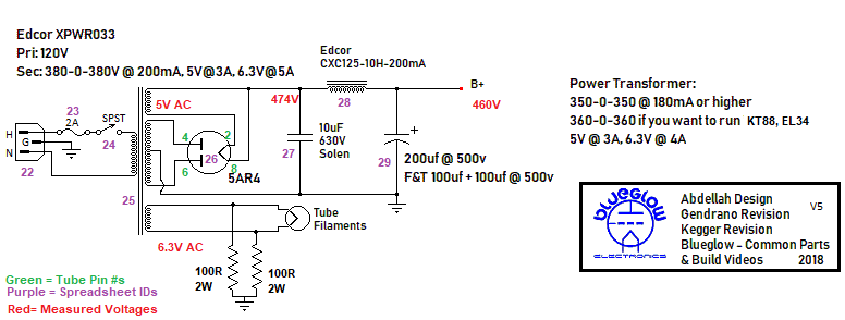

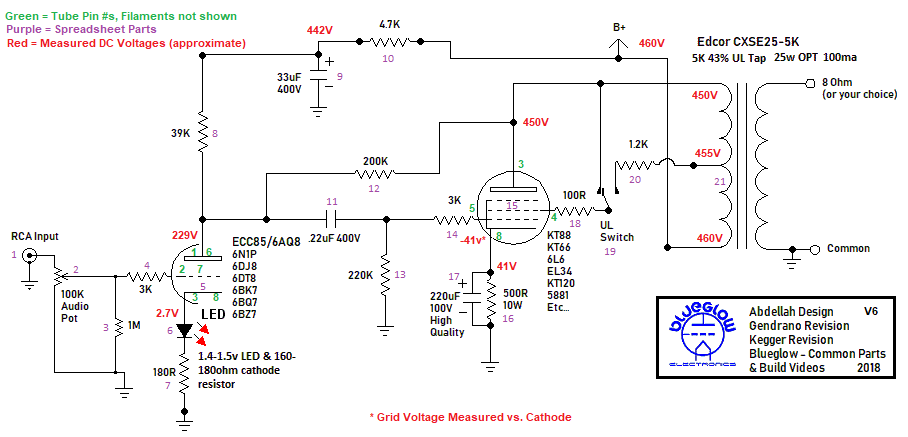

How about this simple single-end KT88. Video series on the design and how to make from start to finish on the Blue Glow YouTube page or from links on the Blue Glow web page. Good looking project. On my amp bucket list.
Covered in great detail in another thread.
Thanks for that.

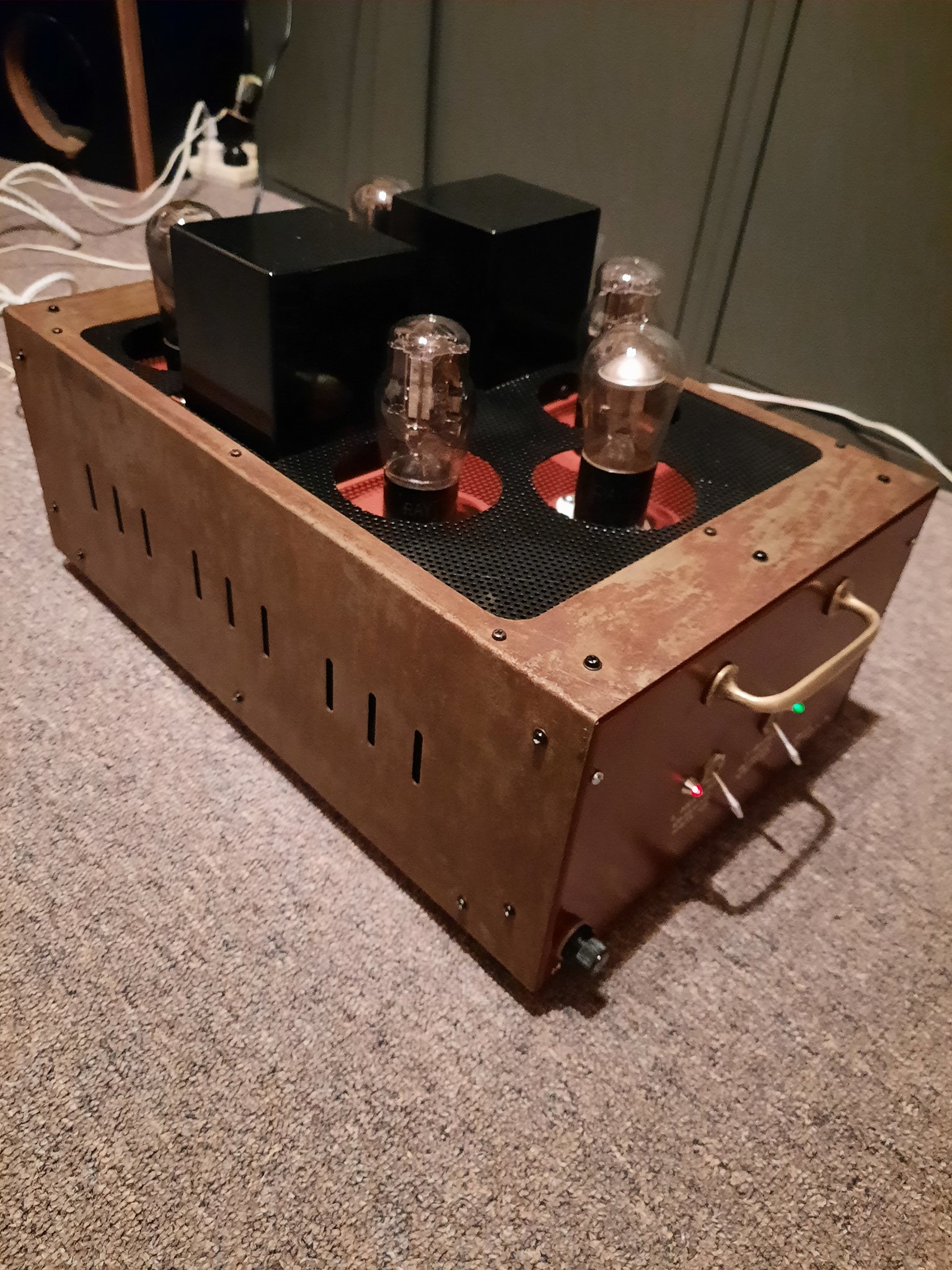

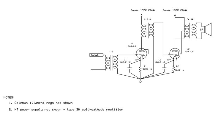

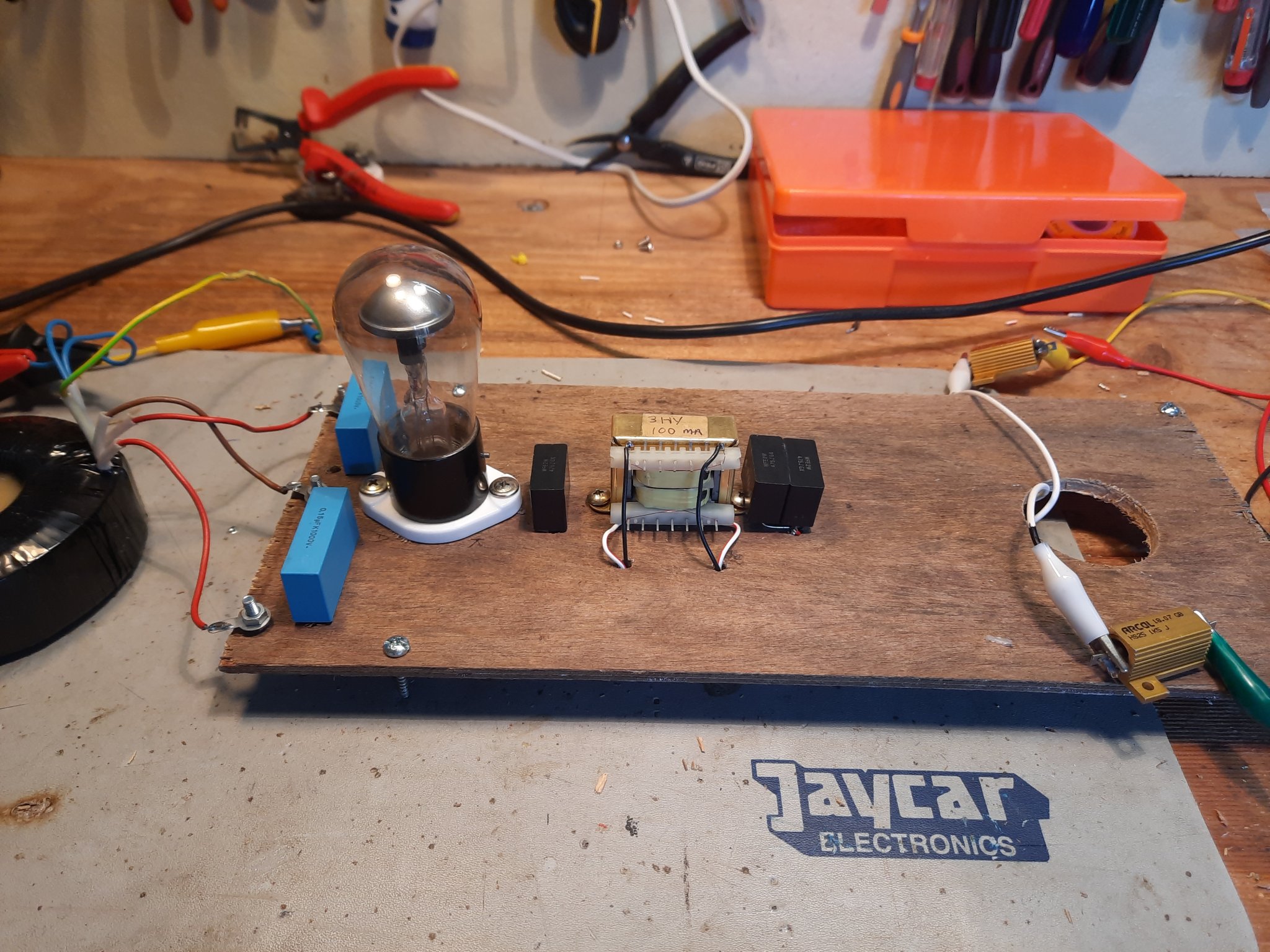

OK - so, not all triodes but all direct heated ... the circuit is 6A4/LA as triode driving 6A4/LA in ultralinear single-ended. Delivers 1 Watt @ 5% THD to 10" full-range drivers.
Not shown in the schematic:
  • Coleman 6.3V filament regs, or the power transformers, rectifiers and filters feeding them; and
  • the HT power supply, in which I used a type BH cold cathode rectifier and C-L-C-R-C filtering (shown on the breadboard).
This started life as 6A4/LA triode driving a type 52 in Class A2, an amplifier I dubbed the Octogenarian since every valve was at least 80 years old (the BH was over 90). But that amp didn't sound sound good above about 0.25W so I converted the output stage to 6A4/LA SEUL (still Octogenarian 🙂 ). It still needs tweaking (so many projects, so little time .... ) to improve the output stage and improve the snubbing of the HT transformer.
