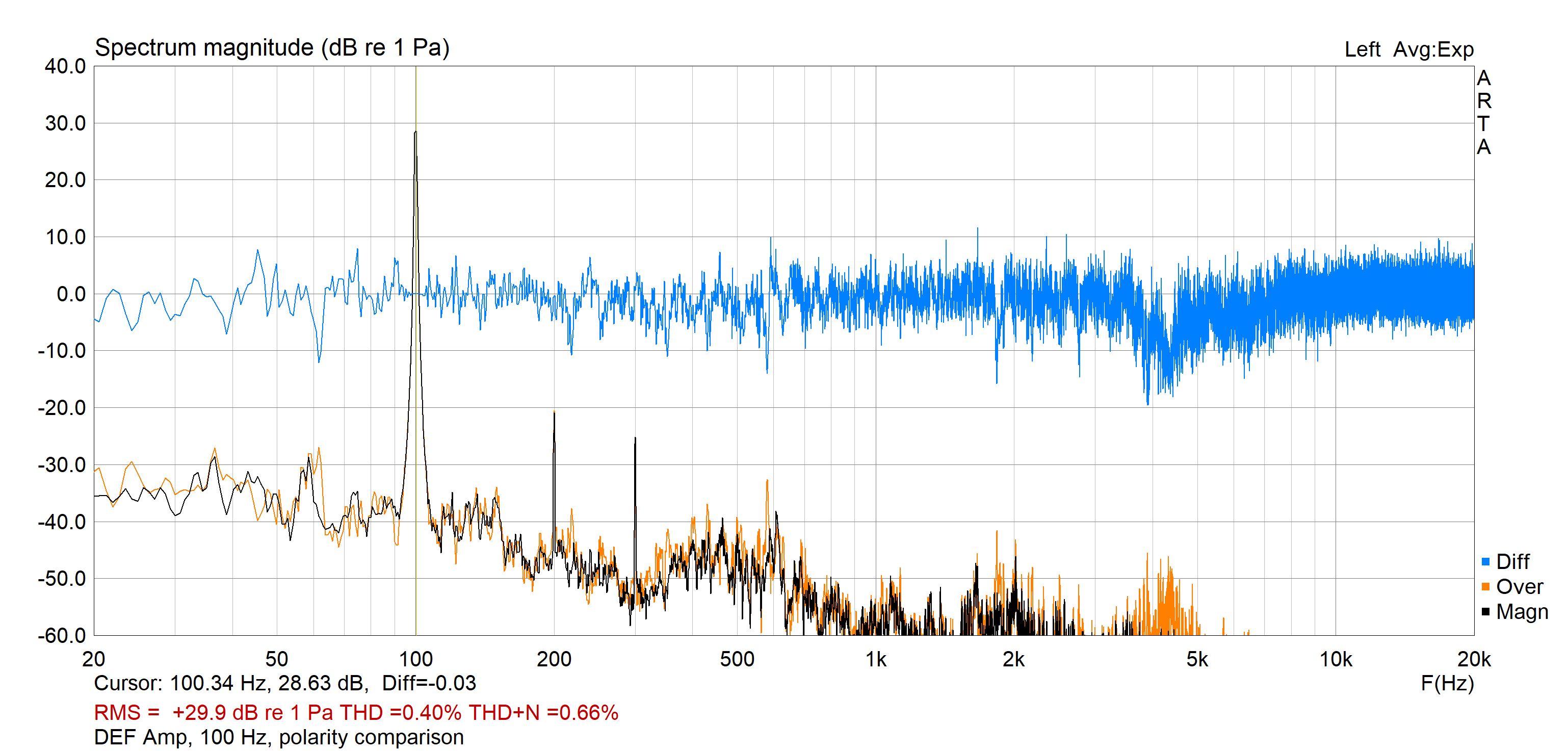

Okay, here's a measurement of a DEF amp with a JBL2226 15" woofer at 100 Hz (ignore the scaling and the scale for now). There are two measurements with the polarity reversed for the second measurement. The blue shows the difference between the measurements.
We see some second and third harmonic, but no difference. Makes sense because the amp's distortion is probably 20 db or more below the speaker's. Got an other ideas to test? Indra, others?
Perhaps you want to measure at ~1W output and also check relevant thread on how Circlomanen made his measurement at "Triodity" to cancel loudspeaker distortion.
Thanks! One Watt will be loud. I will try, but it seems the amps needs to have much higher disortion to see it in the graph. Not sure I can get there. But I know what I hear
