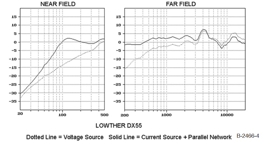

Back in 2004 Nelson Pass published an article in Audioexpress titled Current Source Amps and Sensitive/Full-Range Drivers. It shows a > 10dB difference in response @ ~120Hz between 2 amps. Should be plenty difference for most of us to hear.And if we don't what then? Are we deaf or are you deluded?For anyone who thinks all the amps are sounding the same, try followings..
Just listen to these amps on low level when it's real quiet.. soon you will hear the difference..
