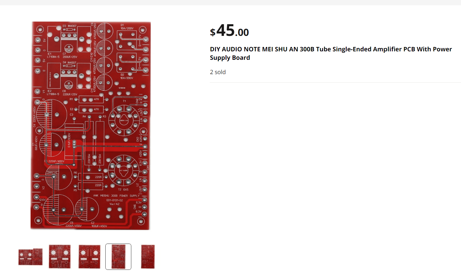

I am looking into building a DIY 300B power amp.
I was considering the idea of buying this "DIY AUDIO NOTE MEI SHU AN 300B Tube Single-Ended Amplifier PCB With Power Supply Board" PCB, which is basically a clone of the power section of the AN Meishu, and assemble it with high end components: AN/Tango/Tamura OPT (whichever I can find used at a decent price), Duelund coupling caps, carbon film resistors and all the good stuff)
Do you think it's worth or it'd be a waste of good components?

If you use a PCB, get ready for a very difficult time if you want to modify the circuit, after it is built and listened to.

I don't understand the logic behind buying the cheapest circuit on the market and then stuffing it with the most expensive parts. How about buying a good circuit and then stuffing it with good parts?

Everybody will have an opinion on 300B. Building Audio Note amp circuit only makes sense if you get genuine AN output transformers . Level 3 Audio Note which still sells for thousands or tens of thousands of $$$ does not have any exotic parts except their PIO (they are not PIOs actually since there is no oil in them to be found ) capacitors. To get exotics you have to have really deep pockets. Only few people can build truly great sounding amps with exotic parts They are usually not on DIY forums. Everybody is happy with the amps they built until they get trounced by fairly ordinary factory amps. The reality of DIY...

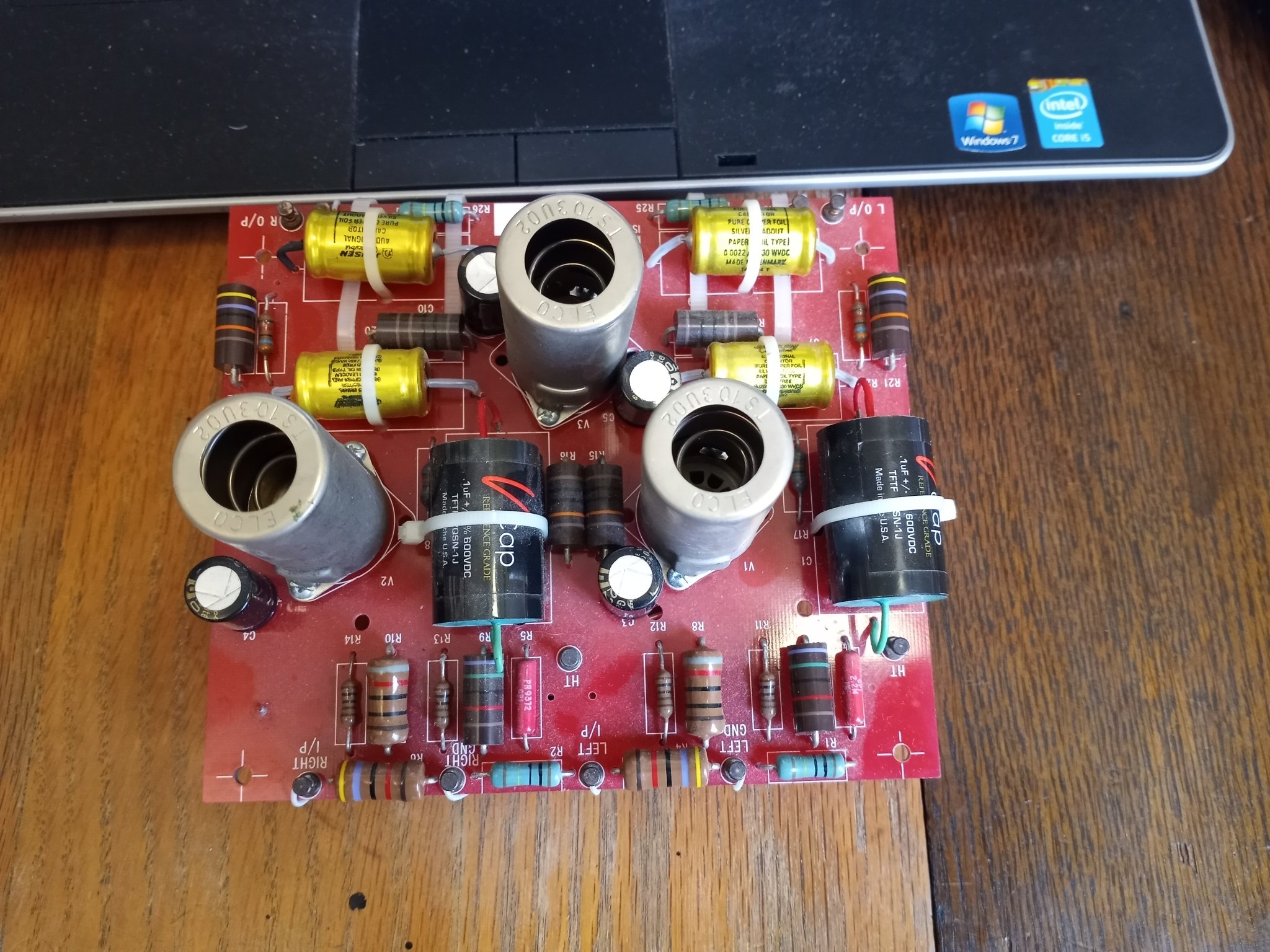

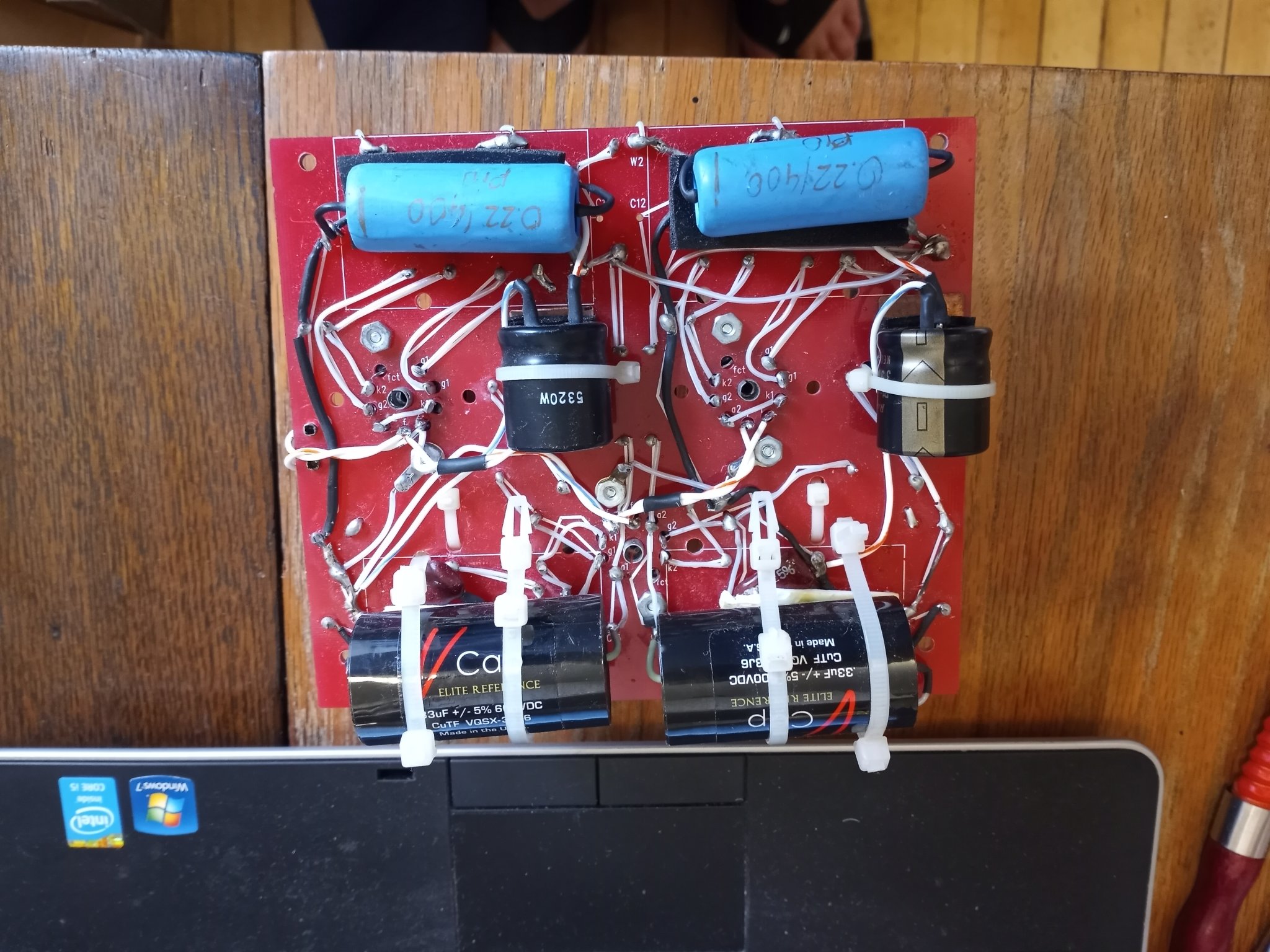

6A3 , they are silver wired point to point circuits. Chinese versions have filament supply on PCB boards as a simplification. The original AN boards don't but the rest has to be wired P2P. Here is mine phono clone.
This one with those abysmal V-caps which I happened to to have on hand and because I already built one with AN coppers.
I happen to like AN and I think they have the best systemic approach to get decent sound in Euro flats.
The opinions you will hear are " yeah , I didn't think it will matter so I substituted beaf with chicken and I will tell you the dish is not worth the troubles , plain vanilla and lacking in flavor" It's not only with AN. Whichever amp you will choose to make stick with designer's choice of parts and move on to next if not your flavor. Well if you're Andy Grove , Shindo or Kondo like majority designers here disregard and proceed to make your world beating amp.
