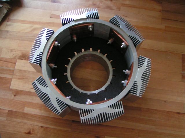

As for my own little project, I almost assembled the boxes last night. This pic was taken with my cellphone, hence the crappy quality.
Magura 🙂
Hello Magura,
Even through your phone, the case looks mighty fine...and
unique.
Looking forward to seeing more.
Dennis
I cant think a picture will do them justice. I am looking forward to see some of the details. Terrific work, and nothing like the usual coffin indeed. Thanks for posting the pic🙂 Feel free to post more.
Steen😎
wow
Those look great Steenoe, I have just started my Aleph X project and hope mine look half as nice.
J
J
That's a very unique looking approach, Magura.😀

I cant resist posting one more pic of Maguras creations. (I didnt ask😀 ) They make me think of a UK Spitfire with Rolls Royce engine😉 Well, pretty impresive work and, very very well made😎 Wish I was a Wizzard with CNC tools 🙂 It would take a while to walk you through the details which are as impressive as they look, so I will let the pic speak for it self😉 BTW the top and bottomplate is machined Carbon fibre, I guess to save weight which will be around 100 kg per monoblock.
Steen😎
Edit, William this is the inductors. ( I realise this thread is growing a bit long🙂 )
http://www.diyaudio.com/forums/showthread.php?postid=1095033#post1095033
Wow, that's really pretty flooring!😉
Yes, I do find myself wondering where the crankshaft and con-rods go.😀
Truly extraordinary.🙂

Yes the AX worked very well with Steen proac clones, best sound so far at Steens place 🙂
Latest pics of my little amps can be found here http://www.briangt.com/gallery/album40
Magura 🙂
