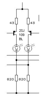

I agree, the McMillans nay not be the culpret, but their solder joint could be? It seems it's a component that destroys cmrr???
flg said:I don't see the McMillan R's in that schemo???
2.2K would possibly be the value??? Post #134???
But, then again, those R19-29 guy's???
You aren't running a single ended input are you???
McMillans are installed, so the schematic is slightly different from the original circuit I showed in previous post. First, I resoldered the parts around the CCS but this did not solve the problem. Next, I'll try installing C102 C105. I will post the results later.
yes C102 is the one I meant. Don´t forget there are two of them......
Start with something small like 1n or 1n5.

Here comes a short update of my ongoing chase for the hum in my aleph-x:
1) I inserted C102 and C105 as recommended, but used 10nF instead of the recommended 1nf, since 10nF was the smallest value I had on hand-> no change, same amount of hum
2) Replaced Q3& Q4-> no change, same amount of hum
3) Resoldered all small components around Q3-> around 40% reduction in hum judged by measuring output with scope, amplitude of oscillation is now around 10mV
I also noticed that hum level goes down as amplifier warms up.
Good news is I REALLY like the sound of my aleph-xs the longer I am listening!
that´s good news. So I would clean the circuit board and do some more soldering, then clean it again.
William
P.S. don´t forget to remove the caps if they are not necessary!
William

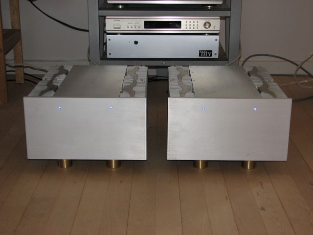

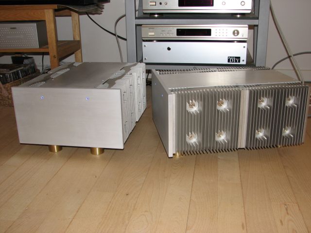

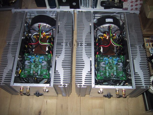

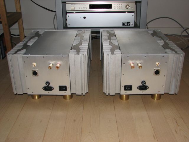

- Aleph-X monoblocks finished.
