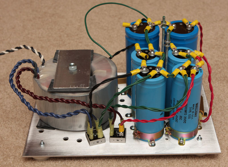

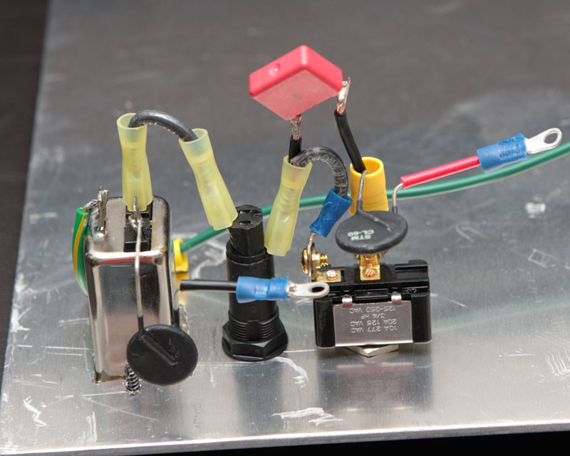

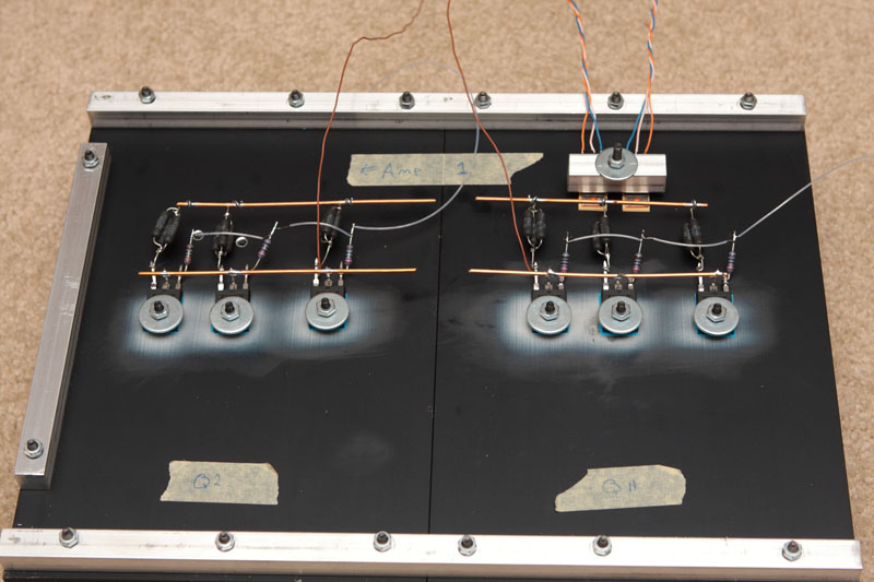

A few pictures of my progress. This is the first of 3 identical monoblocks that I am building. I copied William's 100w design with 22v rails and ~7A bias.
First up, the AC inlet: 6A EIC filter, fuse, heavy-duty switch with cap bypass, and a CL-60 thermistor on each leg of the transformer primary.
The completed power supply: 750VA from Victoria Magnetics with dual 18v secondiares. Each rails is constructed from run of the mill bridge rectifiers, two 33,000uF caps in series, 0.2 ohm 50w resistors, followed by a 220,000uF cap (thanks, Peter!). Since my wire is 14g, I used dual runs for all power supply connections. Unloaded, the PSU delivers 24.4v on each rail. I'm hoping it drops by a few volts when its fully loaded down since my big caps at the end are only rated to 25v.

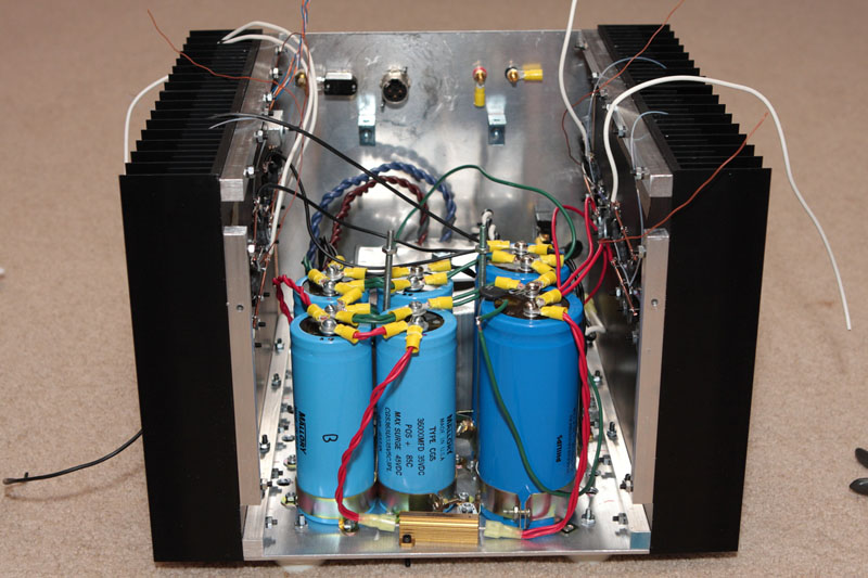

Each side of the chassis is made from two 10" lengths of extrusion #MM1165 from M&M Metals strapped together with 1/2" square bars of aluminum. I used 400 grit sandpaper and a little WD40 to smooth the areas where the mosfets are mounted. This made a big difference in the smoothness of the surface! They mosfets are insulated with Bergquist Sil-Pad 1500ST and held down with big washer to spread the mounting force (gently hand tightened). Spring-style lock washers were used between the big washer and the nuts on each mosfet.

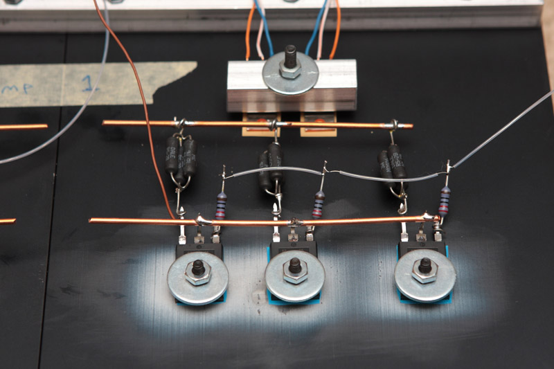

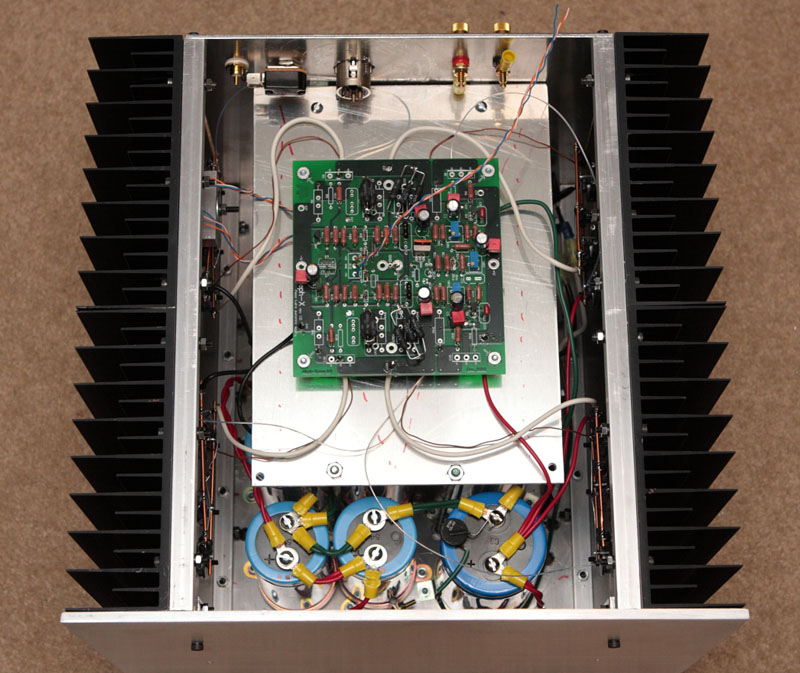

The differential pair for the front end is mounted side-by-side just above the center mosfet on the heat sink. They are insulated with silpads and clamped to the heat sink with the short piece of 1/2" aluminum barstock. Hopefully, this will help them stabilize quickly and track identical temperatures to minimize DC offset at the outputs. The front end was matched at operating voltage and current for 15 minutes and the two transistors track voltages to within 0.0001 of one another.
Here is the almost completed chassis. As you can see, I've not yet wired the signal in or speaker out terminals.
Finally, I installed a small piece of scrap aluminum as a step to help keep noise from the power supply away from the circuit board. All wiring is complete except signal in and speakers out. The thermistor on top of the cap in the bottom of the image connects the PSU ground to the AC ground. It is intended to prevent ground loops, yet let current flow should it need to.
I'm simultaneously excited and hesitant to flip that switch for the first time. I've been over everything at least three times looking for errors and everything looks good.
