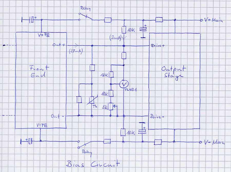

Hallo Grey and all the others
The idea of bootstrapping and using the TL431 as voltage bias reference comes from Firstwatt.
The rest of the VBC seems to be different:
The stages are not coupled with caps, because you need trimmers before the output stage to adjust the offset. The two in the front end would be out of work.
I have drawn down an idea - perhaps this will function:
The bias circuit is made of a voltage reference with a small resistor in series. On this way you can vary the bias voltage a bit dependent from the current.
Means when it is driven by the front end current of about 27mA it reaches a higher value as when it is driven in stand by mode by only the 10k resistors.
Also there is a ("boxed") thermistor network in parallel to the voltage reference network for two reasons:
It handles half of the dissipation (approx. 100mW) (only in power mode) and it can vary the voltage bias dependent on its temperature for faster warm up and less bias drift.
Hope that somebody will answer to it if this could work...
...perhaps with an idea how I can implement bootstrapping capacitors or another network for more output voltage swing.
(without a separate higher front end voltage)
Greatings and nice sunday
Dirk

Hi Ian,
no problem, have a look in the thread "Papa! I want to have Zen V5." Post 183.
But you will find nothing new...
There are explanations of resistor-thermistor-networks. No hint for the voltage bias you need for this kind of follower stage. (in a ZV5 are no followers)
Perhaps there are some other hints in this thread...?....have not read the whole...

Tazzz,
yes the 20% quotes for bootstrapping.
But the question is how to implement it!? The front end and bias circuits of the two amps are different. Also the 10k resistors in a F4 are necessary to feed the voltage source. My bias drawing above only need the 10ks in stand by mode.
...and I am wondering about the use of 3W power versions?
Short resume:
We need a VBC which has to work in the following way:
(the values are just an example)
- In stand by mode the bias voltage has to be 7,6V
- In cold power mode the bias voltage has to be 8,1V
- In warmed up power mode the bias voltage has to be 8V
- Also we need some kind of bootstrapping for more voltage swing
Regards
Dirk
Is it not just a matter of adjusting the resistor who sets the voltage for the TL431?
Possibly by switching in an extra resistor in parallell for the standby mode and connecting a thermistor + a small resistor network to set the needed change in resistance with temperature.
(in event of confusion, not in parallell with the TL431 in its entierly just with the voltage setting resistor, the tl431 can be seen as similar to an lm317 with 2.5v reference voltage)
I think ~20% extra corresponds pretty well to the extra swing you would get by lifting half the necessary voltage to bias the fets (applied exactly like the two caps between the jfets and the mosfets in the F4)
Ian,
1) Yes I agree with you. Both uses nearly the same SE current
2) Have testmagazines from 30.5 und INT with some pictures.
I'm sure that the 30.5 uses no seperate windings and no voltage doubbler and only bridgeable caps at the inputs.
Current X.5 versions have input caps too and a "normal" voltage bias circuit (MOS GS-Ref) and switchable (with a transistor) SE-bias resistors (for stand by turn off).
4) There are a lot of 3W resistors. I interpretate the arrangement of them in the following way: 6 resitors for supply filtering of the front end, one for the meter, two I don't know and two 10k (which I can see) for every voltage bias circuit.
5) It isn't a CL60 and it is placed between one of the VBC elcaps and the three 1/4W resistors bank. Have a look in the jap.manual again.
Sure the drift of the TL431 is absolutely minimal. That is not the point.
The network around it should give the VBC the "right drift" for faster warm up / constant output bias. Also the serial resistor should reduce the bias voltage when it is only driven by the 10k resistors in stand by mode.
Dirk

Ian,
I agree with you. You cannot connect the caps in the same way as in the F4. Front end stages are completely different.
When there is bootstrapping applied than there must be a possibility to do that with the front end voltage.
Have searched for bootstrapping in the internet and found a lot of information for switching supplies.
The only short and good explanation comes from Nelson in this forum! Unfortunately not helpfull for this application :-(
