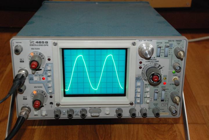

I just built two Aleph X and I detected I strange behavior.
When I input a sinus wave between 10KHz and 20KHz at a voltage just before clipping I noticed a strange shape.
Could anyone find an explanation to this?
