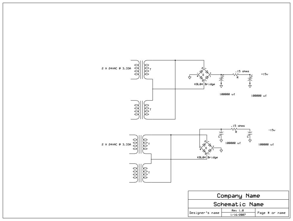

power supply design
Well after some work I have come up with a power supply design for the Aleph x low power version. The transformers are plitron 160 va
24 v 3.33 amp dual secondary wired in parrallel, one trany one bridge for each rail. Followed by a CRC filter (two 100000uf caps and a .15 ohm resistor). Is this to elaborate , and would there be better symetry if I only used one 12 v center tap trany for each mono block instead of 2?

What you've drawn isn't parallel secondaries. The tops and bottoms of each secondary should be tied together.
For that matter, just parallel the two transformers and be done with it.
As far as filtering, try to find some inductors. Consider winding them yourself if necessary. Then use an LC filter--or LCRC if you want. The L at the beginning will do a very tidy job of knocking some of the surplus voltage off the top, and give you more current capability in the bargain, not to mention lowering the ripple the caps see, etc.
Grey
Grey

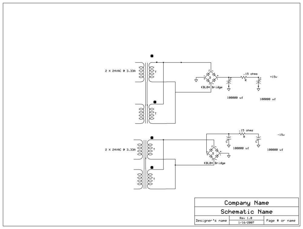

Your schematic is a bit confusing. That's not how you draw dual secondary transformers. The core would be shared, and when you're not indicating the phase of the secondaries with phasing dots, one naturally assumes that they're in the same orientation, which in your case would make them in reverse phase to each other. I hope you understand you have to get the right phase when you're hooking up multiple secondaries in series or parallel.
