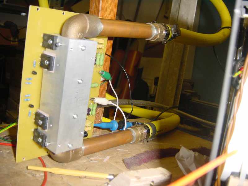

Hi!
I am Robert. I have built the aleph-x according Greys original schematic, but using 17,5V rails and bias 5A. The output devices are IRFP044N. All IRF9610, IRFP044N and the 0.22ohm resistors, left and rigth channel, are mounted on the same aluminum block, which is watercooled.
I have matched all transistors within 10mV, but the DC ground to output offset will not go lower than about 5V. Now I changed R23 to a 500ohm pot. When I go down to 350ohm on R23 (R25 still at 390ohm) DC to ground offset is <3V and output- to output+ <100mV. The amp is playing music, without signal its quiet. The aluminium block goes up to 65°C.
Now some questions to the forum:
Will this modification have impact on the overall performance?
What is the recommended minimum of the bias difference between Q2/Q11?
Is more important to have same voltage across R23/R25 or same current?
I have attached a picture showing one channel completed.
