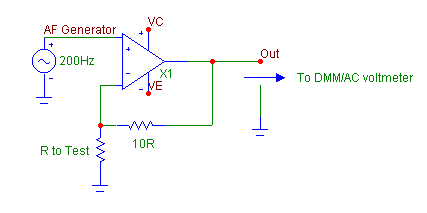

nead help, how to macth resistors
Hi all...
I need help how to match this low value resistors...I have 0.5 Ohm mills resistors and I try to match them but the curent and voltage drop was to little to measure...
I have regulated 30V 940mA from my printer power supply...I've got two multimiters, one fluke 87III and other some cheap no name , but it's working...will this work...
Any suggestion how to mach them???
How do you mach this small value resistors???

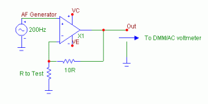

Just a silly idea I get 😱 🙂 . Not tested it, but may be worth a try 😕 Just take an opamp, preferably a fet input one, and make a non inverting amp just like the schematic attached. Hook the right supply and a AF generator, around 200Hz in frequency. Amplitude's up to you. Connect a DMM in AC voltage mode at output. Make sure the output amplitude of the generator is stable and don't touch it anymore Most of DMMs have a sufficient bandwidth in AC measurements to provide good reading at 200Hz. Just change your resistors, and note the output voltage value. Same resistors will give same readings... The feedback R on the schematic gives a voltage gain of 21 for a 0.5R "unknown" resistor. Just change it to suit your needs and your DMM sensivity.
Should work with a DC source, but the stability of supply and components should affect the readings.
Too silly to be good, but who knows... 😉
May be this helps 🙂

Thanks Cheff...
Now this maid be good idea for someone who is not total newbie as I’ am...and making circuit like this would take additional costs, and I don’t have AF generator ...I was hopeing for some simple circuit with two resistors or something...
Which everybody can use...I believe that here is many newbies like me who would like and have nead to match resistors...
Thanks once again Cheff ...
Any other sugestions ???
