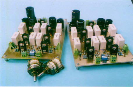

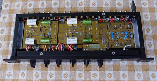

that P1.7 really looks great!! Very professional to me. I wish my diy circuits would look as good as yours from the inside.
Have you ever thought of a remote control?
What is on the double decker boards beneath the main boards?
Would you mind sharing their layouts (or did you already?)

Hi Thomas,
a remote control for volume? Should be doable, look at www.schuro.de
The double deckes boards are at bottom source switch (relay) and on top volume board.
For layouts look here: http://www.diyaudio.com/forums/showthread.php?postid=550815#post550815
Cheers
Adam

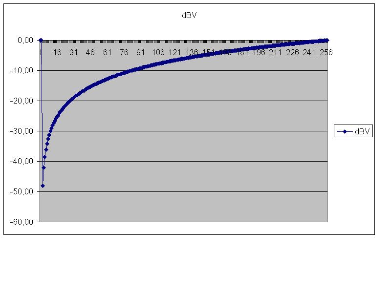

Hi altogether,
I cought a fever and spend some days in bed. So I had the time figure out the attenuation for each step of the resistor network of the P1.7. See image attached.
From the image it can be seen, why Nelson uses a look up table in the 87C150: only approx. 70 Steps are needed if you want 0,5dB between them (the lowest are fare more aparat, here you find 3 to 4 dB spacing between them).
If you want a curve without jumps (stetig), you need to have your resistors in powers of 2 of the smallest value you are using. The absolute value doesn't care, as long as you are not looking at the input / output impedances of pre and poweramp (what I did here).
With this limitation 8 bit can only code for a attenuation of 48 dB (as 16 bit do for 96 dB on our CDs).

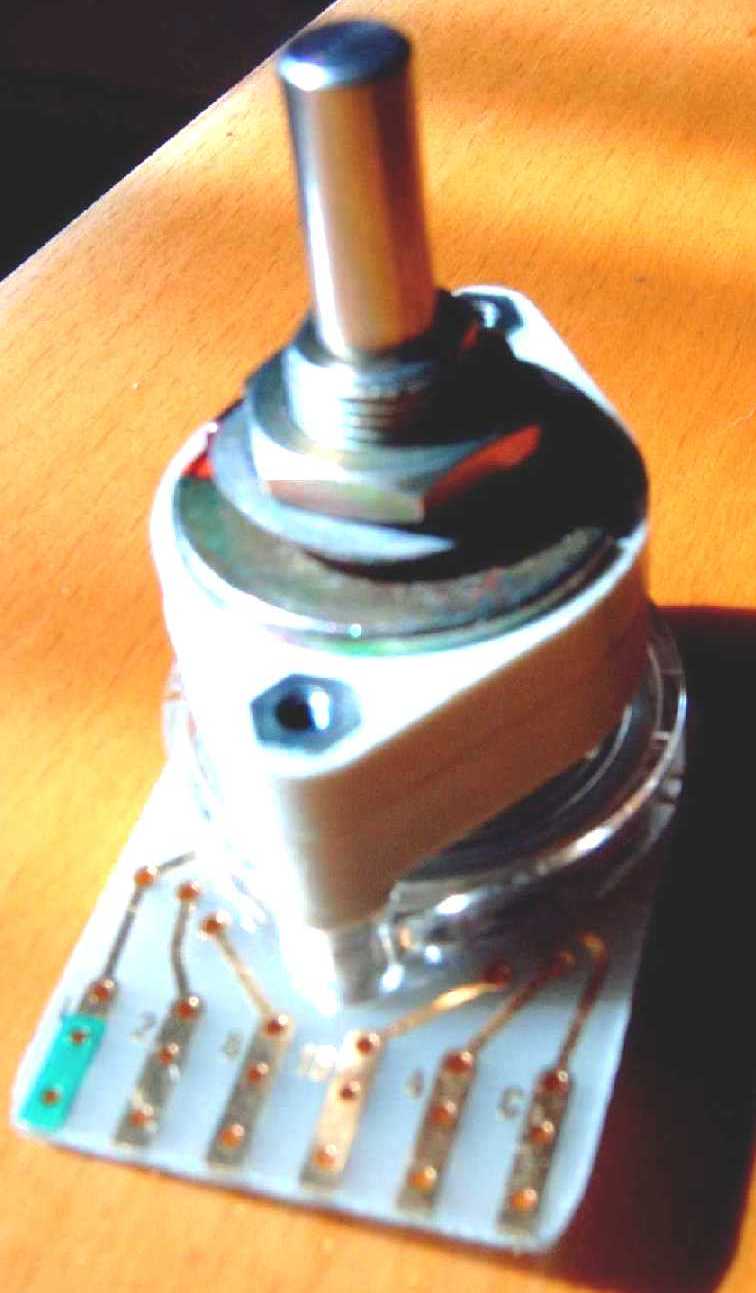

Hello,
the switch is a ordinary binary switch. Type EBE 46-353.
Pins: 1(S), 2=2^0, 4=2^1, 8=2^2, 16=2^3. (habituation-needily...) 🙂 😕
This switch has 16 Steps. In my pre I use only 5 (off + 4 sources) mechanical fixed inside. Pin 1 gives a signal only between steps, this can be usually used for enable/disable selection, I use them, but this can be disconnected, no difference in function. It prevents that the preamp goes off between steps by (very) slow turn.
The same switches are used as gain pots.
This is all, no magic.
Adam
