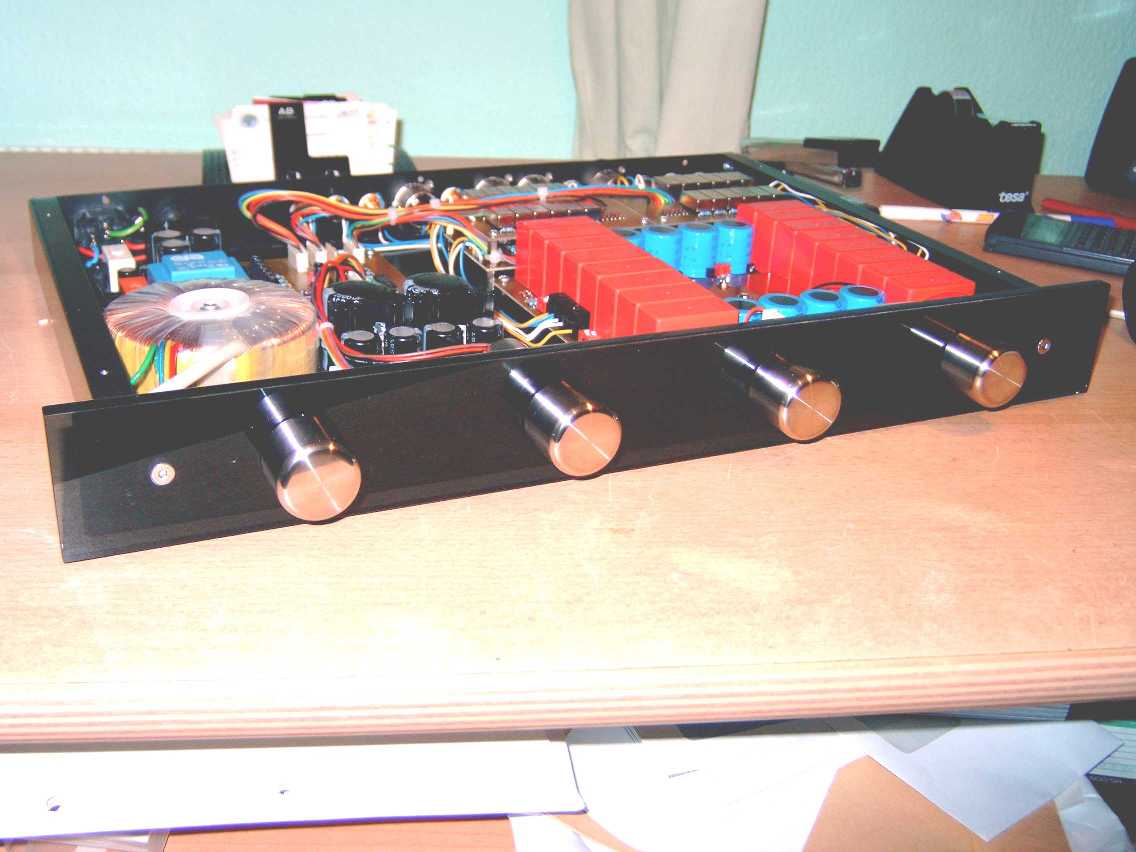

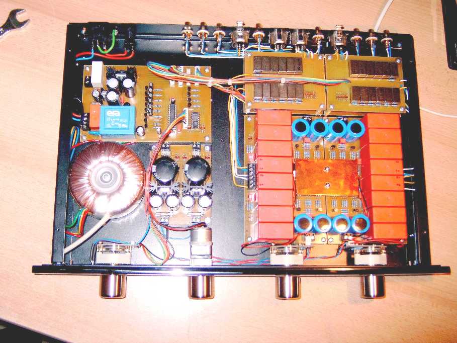

Clarkcr said:Where is the universal ground? Doesn't the circuit need a ground?
Nice looking setup.
C
maybe i don´t understand your question.
Ground:
both channels have separate ground.
powersupply too.
The controlboard too.
The volume control relay shared a 12VDC supply and are switched to Control-gnd via transistors, see pic. Left and right channel are not an common ground. As i buy an second transformer, are both channels fully separate.
All pcbs are made with Ground plane at bottom. Maybe is it not a best? But singlesided layout with a straight star ground wirng is not so easy... This should be realise by next project (AX)
greetings
Adam
Okay, I just didn't see where there was a ground anywhere. I always thought there needed to be a star washer type ground.
C
C
Have a look at the bottom pcb layer. There you'll find the ground plane. It doesn't show in the other PDFs.Clarkcr said:Okay, I just didn't see where there was a ground anywhere. I always thought there needed to be a star washer type ground.
C
