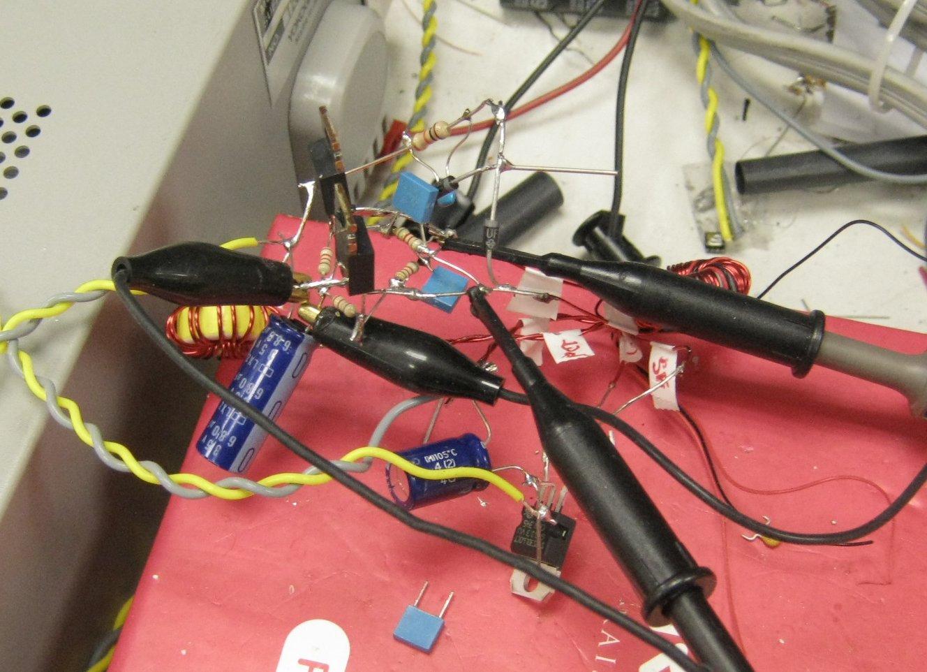

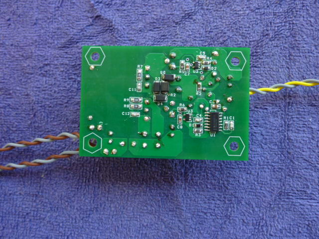

OK, dubious porn here - This is the crazy cat's cradle that represents my effort to construct a minimal parts count self-oscillating DC-DC converter to generate the negative rail for the Aleph Mini-Me. Things look OK, except that the converter does not like to properly come up into a constant current load when the input voltage is applied slowly. Maybe this will change if I just slam on the DC supply feeding the converter at full voltage. If there's a dead zone between the initial application of voltage and actual current draw , this might allow the DC-DC to come up without issue.
When the converter does come up properly, it's a beast. Switching times are pretty fast for a basic self-oscillating DC-Dc.
First off, a rough picture of the crazy cat's cradle that's the converter so far.

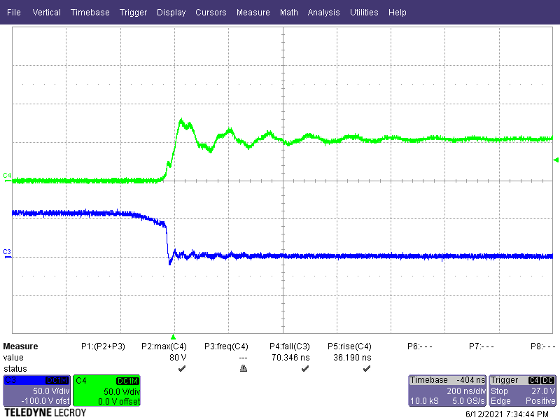

Next up, some drain waveforms, including an expanded view showing some fairly fast switching for a self-oscillating converter.

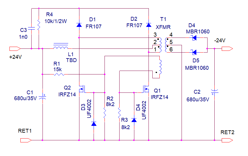

Interesting - If the DC-DC is turned on with the voltage up full, it starts into a current source load. Next up - adjusting the value of speed-up capacitors to optimize drive levels. I was lazy and did not look up the data sheet for the IRFZ14. I assumed the gate capacitance was ~1000pF - it's actually around 300pF. This means I can substantially reduce the value of the drive speed-up capacitors. I will try reducing them to 220pF from 1000pF.

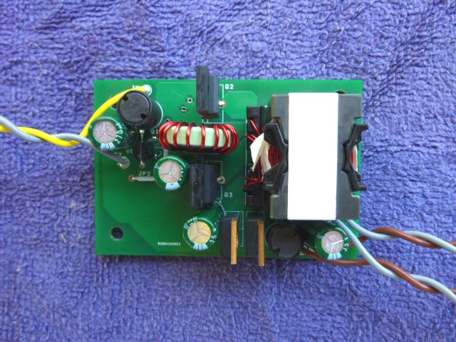

I just got my boards today for the downsized version of the negative bias DC-DC converter. This is a driven solution instead of self-oscillating, so it's more complex. However, the design already works without a lot of farting around. It's likely more efficient as well as there is no energy waste from driving the main transformer core back and forth into hard saturation.

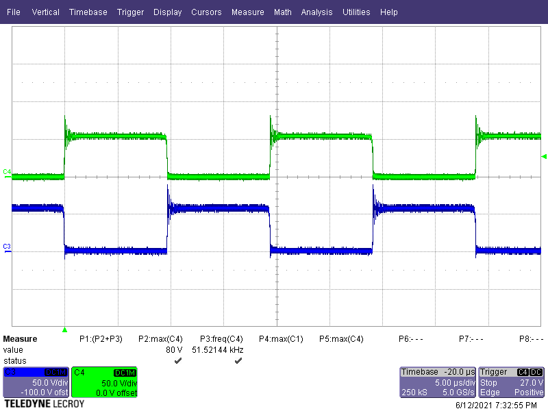

Here's the next pass on the current fed Royer DC-DC design, with an improvement on the drive characteristics, and a picture of the drain waveforms. The snubber will need some work to damp the spike on the drain waveforms, or I'll just use 100V mosfets like my other DC-DC.

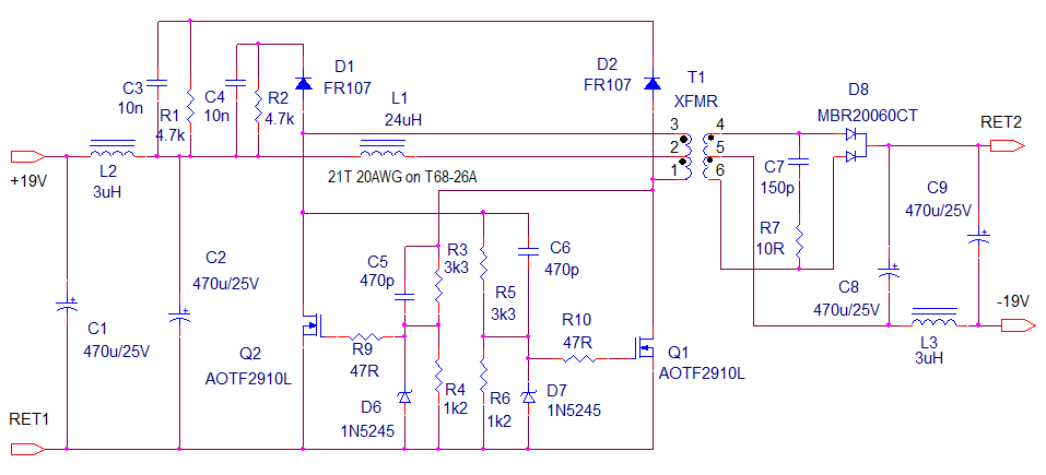

Here is a partless wonder saturating core converter for converting a positive voltage from a switching adapter to a negative voltage. No switching controller is necessary, as this is a variation on the classic Royer saturating DC-DC converter, with an inductor in the XFMR primary center tap to reduce the shoot-through current caused by the saturating transformer.
Boards for this are in fab at PCBWAY.
