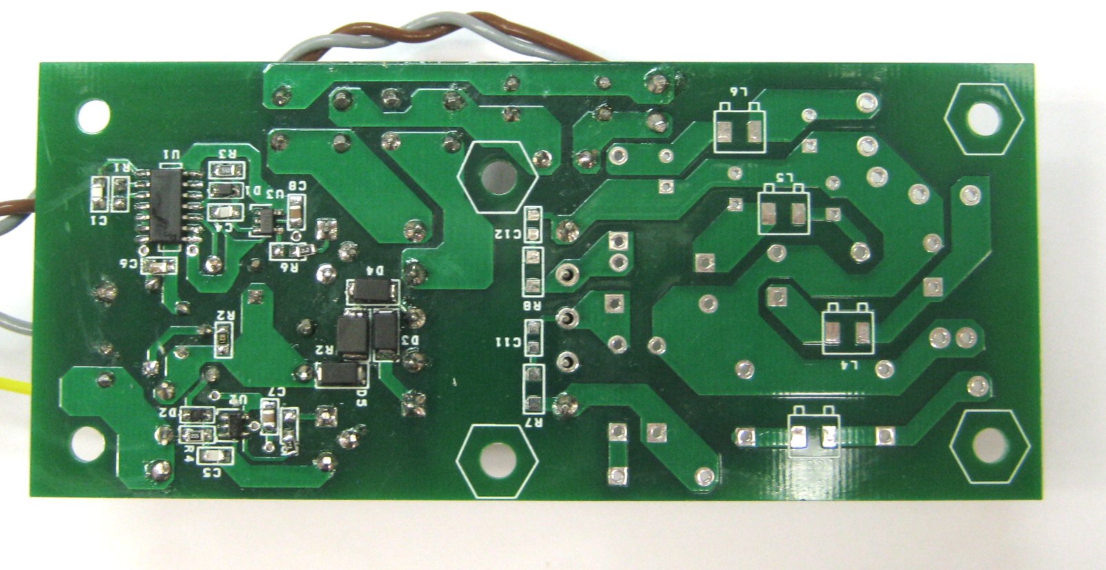

Here's the DC-DC converter for generating the negative rail for the Mini-Me. This started out as a general purpose converter for generating B+ (2 flavors) Bias, and filament for tube amplifiers, with input from a 24V switching adapter.
Here, just the filament supply is populated, as it has the largest rectifiers. The transformer is wound to generate a -24V rail from a +24V supply.

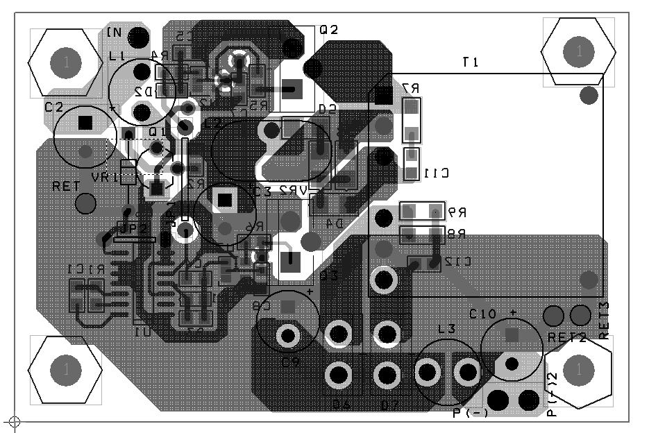

I took a little time yesterday to revamp one of my DC-DC converter designs to dedicate it to high power negative rail duty. The result is a converter with smaller board area and less height to better fit available small die cast boxes for convenient shielding. Boards are on order.Some fairly nice Alps pots are also on order for front panel duty.

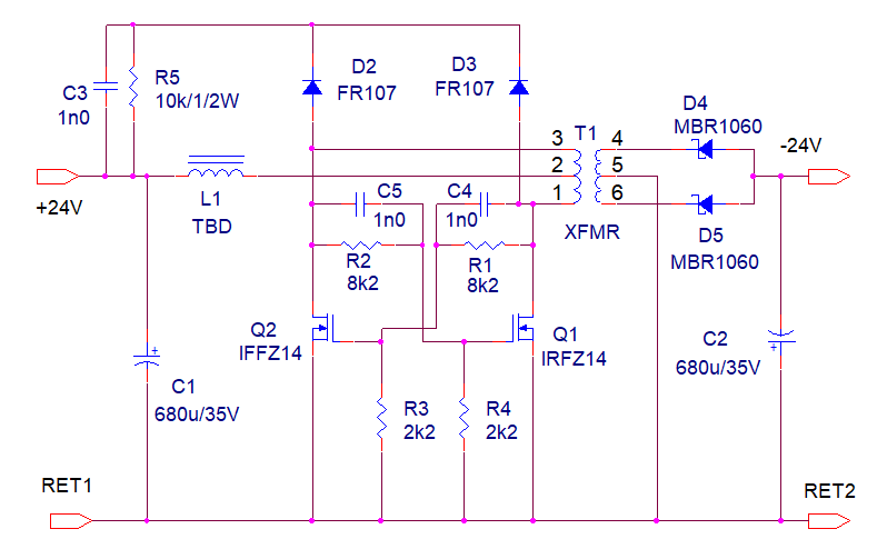

Here is an alternate -24V DC-DC converter I'm trying as a speculative exercise. The setup is essentially a current fed Royer self-oscillating converter. I have the thing operating on the bench presently as a 3-dimensional cat's cradle of parts. If I can improve the MOSFET switching times, this option might be a viable alternative for a DC-DC converter for generating a -24V supply. Since the transformer is allowed to saturate, it can be very compact. Also, both the transformer and inductor can be constructed at home using available ferrite and powdered iron toroids. I may try using some fancy-pants square loop ferrite material to speed up the switching times, though if I can get adequate performance with readily available materials by tweaking the circuit values, I may not bother, since the square loop material is hard to get.
